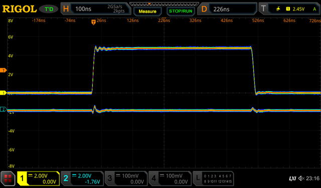

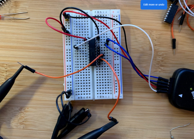

I am new to electronics and am seeing something I don't understand when trying to visualize I/O ports on a PIC microcontroller (PIC16F690).
The probe on the left side of the img is connected to a PORTC I/O pin, and the probe at the bottom of the img is *not* a PORTC I/O pin (but is adjacent to one).
When setting PORTC pins to logic one, I see the expected ~5V on the PORTC pin and ~0V on the adjacent pin:
However, when toggling the PORTC pins, it affects the adjacent pin!  What?? How??

The other pin is configured as an input without pull-up, i.e. High-Z? In that case it is capacitive feedthrough to the other pin.
Here's a shot with the adjacent pin configured as an output port set to logic 0.  Is this still "capacitive feedthrough"?

I don't see any decoupling capacitors on the Vcc/Gnd pins.  That's a really big deal when things happen fast - like rising/falling edges.

That's ringing due to the inductiveness of the ground leads of your probes and the power supply lines. Usually it looks quite a bit worse than this with a setup like you showed in the picture.
There's a .1uF capacitor in the top left corner of the breadboard.  I put it there since that was recommended in the 8-Bit PIC® Microcontroller Design Recommendations.

Now I see that little dickens!  OK, that location is useless.  In a perfect world, there would be a 0.1 ufd capacitor within a small fraction of an inch of the VCC and GND pins.  This isn't always possible unless you do a PCB but to have it 3 inches or more of long inductive wires away from the pins isn't helping.  If anything, the inductance and capacitance are forming an oscillator.  Removing the capacitance stops or reduces the ringing because the capacitor was too far away to begin with.
The neat thing about decoupling capacitors is that you don't have to worry about having too many.  More is good!  So, keep the one you have, add one as close to the pins as possible and throw a 10 ufd electrolytic across the power rails.  I tend to put electrolytics at the far end of the rails but close to the entry point probably works just as well.
At some point, you just give up when you come to the conclusion that breadboards are suboptimal.  It's just that there isn't anything much better until you get to making a PCB and that's a lot of cost for a simple demo circuit.  Which is why I buy demo boards...  They have more features and the electrical problems won't exist.

+1.  To decouple a PIC (or other DIP MCU) on a breadboard adequately, get a 100nF ceramic capacitor (for their low ESR), disc ceramic if you can find one, or an epoxy dipped leaded MLCC, with long enough legs to go directly over the top* of the PIC chip between Vdd and Vss.    For larger breadboard projects, add a 10uF aluminium electrolytic across the supply where it comes onto the board.  The extra ESR of an electrolytic is actually helpful as it damps ringing, which can otherwise cause a severe transient over-voltage if the PSU is switched at its output or you 'hot-plug' the board supply as the  inductance of the long PSU to board supply leads rings with the total decoupling capacitance on the board.  Also, minimize the loop area (and thus the lead inductance)  by keeping the PSU to board leads lightly twisted together.
Also, *DON'T* use long wires on the breadboard for Vdd and Vss.  Get some 24AWG PVC insulated tinned solid core copper wire - e.g split a few feet of good quality scrap Ethernet cable (not  patchlead - that's stranded) - and cut and form minimum length jumpers  for your power nets.  If you are using both sets of breadboard power rails, link them across the board at *BOTH* ends of it.
If you need to use a crystal for the PIC clock, get one with long enough pins to insert it directly in the breadboard directly between the OSC1 and OSC2 pins, and put its load capacitors directly to the nearest Vss pin if possible.  Using jumpers in a crystal oscillator setup is a really bad idea as its likely to be the highest frequency signal on the breadboard and glitches or EMI pickup can result in extremely weird misbehaviour.
Put in single bare 0.1" header pins for probe points, or use short loops of bare tinned copper wire, in adjacent holes in the same strip.  Its critically important to keep the probe ground lead as short as possible and as close as possible to the PIC Vss pin (or ground pin of what ever other chip you are probing round) - signal integrity is already FUBARed by being on breadboard and by the use of a clip on ground lead, you cant afford any extra lead length adding inductance if you don't want to waste time tracking down 'phantom' ringing due to bad probing technique rather than real glitches.
* For 28 pin PICs with two Vss pins, link them with a short (cut and formed to exact minimum length) ground wire directly over the top of the chip and put the cap between Vdd and the adjacent Vss pin.  For 40 pin PICs with two pairs of Vdd & Vss  pins, link Vdd to Vdd and Vss to Vss straight over the top of the chip and put two decoupling caps one between each pair of Vdd & Vss pins.

FYI, specifically what you're seeing on the first scope shot is the capacitance between pins, mainly between adjacent positions in the solderless breadboard itself.  Which is somewhere around 4pF, IIRC.  This acts as a capacitance divider, from the driving pin, to the susceptible pin, to ground.  The pin self-capacitance and probe capacitance act in parallel, both on the order of 5-10pF I would guess.  So there's 5V into 4pF into 20pF to ground.  You end up with about 1/3 to 1/8 of VCC.  The measurement looks to be about 1/6th, which is pretty reasonable agreement considering the hand-waving guesses at capacitances here.
There is a time constant associated with this as well, because the probe has resistance, which discharges the node slowly over time.  10MΩ across the Thevenin equivalent capacitance (all acting in parallel in this case, so ~24pF) gives a time constant of 240µs.  The driven waveform is much shorter than this, so it doesn't look perceptibly sloped; if you added a delay of maybe 50µs to the loop, the slope would be perceptible, and with a delay of over 500µs, the exponential RC discharge waveform would be apparent.
