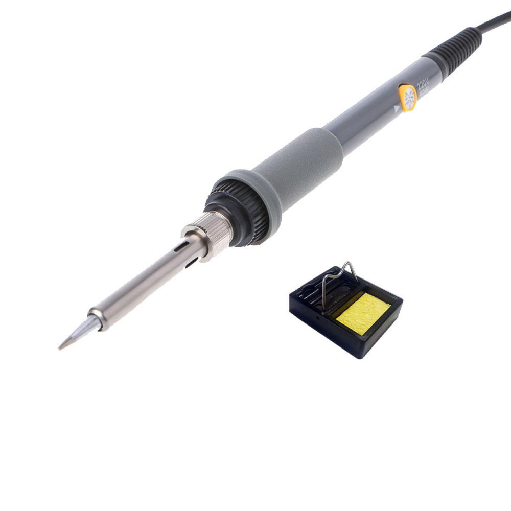

My soldering iron is okish (Antex Xs25w) but not a soldering station, video says I must have a soldering station. That's a minefield as there's a load of rebadged cheap stuff out there. Any advice on a cheapish good one?
Then he recommends getting a hot air rework station, again loads around, haven't a clue whether they are good or cheap crap.  Any suggestions for a cheapish good one please?

You don't need a soldering station right off the start .There are adjustable soldering irons that will do fine for the beginner.
They won't have the power as a fancy station but 50 to 60 watts has served people well for years.If you plan on using SMC (Surface  Mount Components) then a a hot air work station is a must . But you could get by with a hand held hot air gun similar to this
It probably won't replace a large chip but smaller components it would probably be alright.

  • For an inexpensive soldering iron, try the Yihau 947-II or Quicko T12-947 (I put a video on youtube comparing them)
