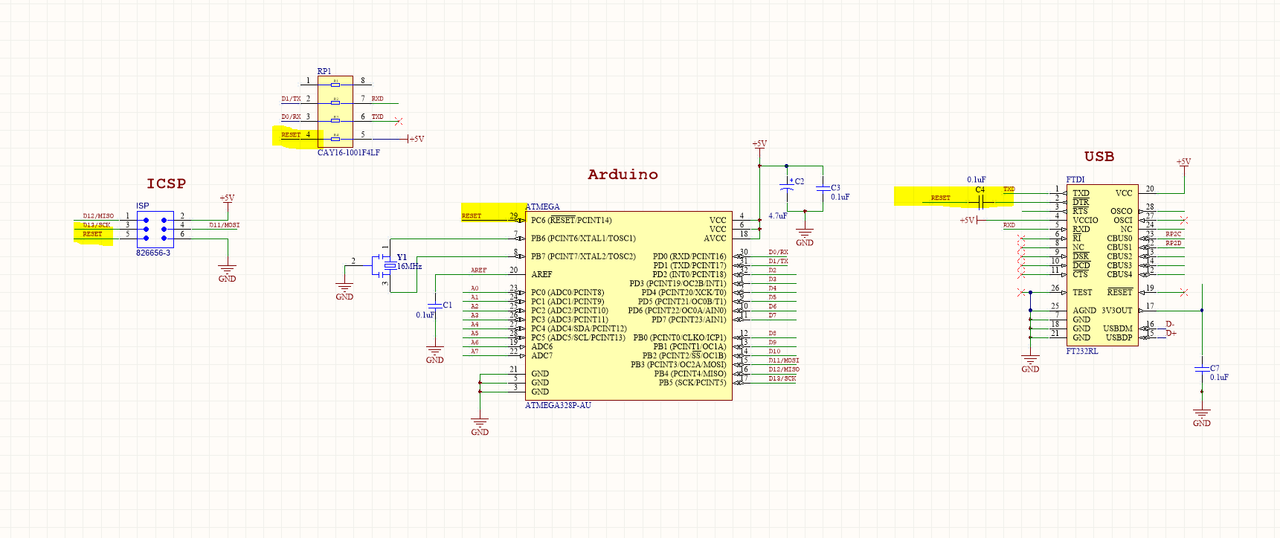

So I designed a small product a few years ago and it has been selling well.
But around 5-10% that get shipped end up not working once received by the end user.
The product is pretty simple and only requires power to work.
But a small % just don't work once they are in the hands on my clients.
All they have to do is plug in power, which is either via a battery (a standard used in the industry) or via USB.
I did the whole PCB design, case CAD and offloaded the software to a freelancer.
In house (literally my house) this all works fine and passes all our QA testing.
Another problem I have just had is that I needed more PCBs the other month.
I wanted to improve 1 thing which was when installing the PCB this corner was getting in the way a tad.
So I chopped off this corner in PCB design software and re-poured the ground plane.
And once the PCBs arrived, none of them would allow me to burn the boot loader onto the ATMEGA via the programming header.
Had to pull all the ATMEGAs off and flash them in a socket.
Put them back on and 90% of the boards I made just don't work as expected.
This is after P&P and hand soldering over £300 worth of components >.<
I just don't know what to do any more.
Would love to just hand off the PCB design to someone else but I don't have enough money to fund that right now.
I don't understand why one minute the thing works but then dies as soon as it arrives at the end user.
Any advise on what I should do?

For clarification as I know I have not added a lot of details here.
Any boards that have failed have been replaced with working boards. Full warranty was provided.
The two issues above are not the same issue/related.
 I have done 3 batches of boards.
 Batch 1 out of a total of 50 boards, 2-3 failed and were replaced.
 Batch 2 we have had 3-4 fail and were replaced. One has failed again, we are investigating.
 Batch 3 with a slight PCB change, all but a handful have failed to work as expected. None have shipped.
Boards that arrived back here were examined but I don't have the tools or knowledge to go deep into scoping pins or anything like that.
The flashing of the boot loader is only done once, which is why we can flash them on a socket and then P&P.
The USB interface is used to flash firmware and updates.
I am aware that there might be underline issues with batch 3, which is why we are not shipping any of these boards.
My clients are aware that this is a project being done out of my garage and that I am not a "pro" at this.

- Have you got any units back that a client says don't work? If so do they work for you or are they dead.
- Is your QC test automated? If so are you sure it is not faulty and letting dead units out the door? Maybe a manual test is needed so you know for sure all units leaving you are 100% working.
- Is there anything unusual about your location or places you ship to.  Some places irradiated all their mail with high energy x-rays and this can destroy electronics.
- Does the MCU/software system interface/talk-to something that is different in different parts of the world.  Here's examples of what i mean. Maybe bluetooth to a phone  or maybe comms to a desktop PC app. Maybe some people have their phone/desktop set to a different timezone/country/language and may your app is incompatible with this.
- Do you have the sourcecode to your ATMega or does the freelancer hold that?
Few possibilities i can think of.
- Are users connecting the battery around the wrong way and damaging the device. (9V around wrong way for a split sec, that sort of thing)
- Do you have any floating inputs pins on the MCU? Maybe the code only works if an input is read as either low or high but it keeps changing with ambient noise. When built it might stay in one state but in noise environments maybe it floats to high and stops the code running. (Floating inputs should have MCU pullups enabled in software but maybe they are not set in your code?)
- Have you tried powering the device from 4.5V and with lets say 50mA current limit.  Not all USB ports are created equal. Maybe your product is quite critical on power and not all USB ports can power it.
- Where are you getting your parts from, maybe you are getting lots of fake ICs
- Could be a PCB track routing issue where tracks run too close to a hole or board edge and sometimes get cut by the drill/router.  etc Some PCBs work, some don't, some intermittent.
- Are you sure you have the ATmega Fuse Bits set correctly, maybe the startup delay, brownout detector or crystal settings are wrong and this is making it run intermittently.
- Does the product have protection from ESD or PSU spikes, like a TVS?  Does the product get used in a location where it might need this.  etc  automotive/industrial
- How are you programming the MCUs?  I one had a crappy USBASP programmer that would brick 2 our of 5 AVRs it flashed. Not sure why, maybe clock was out of spec and kept erasing fuse bits.
- Does your MCU programming system include a verify check?
- There is one AVR MCU, cant remember which, that comes with fuse bit set to put it into a compatibility mode where it pretends to be a different AVR chip. Some of the IO/peripherals don't work until you get it out of that mode.   :palm:  (my guess is they have a supply agreement to sell a compatibly chip for 25 years for MIL/MED/AERO) EDIT: All ATMega128 pretend to be a ATMega103 until you change the M103C fuse bit

This makes me lean towards a PCB/SCH issue.
Are you using MISO MOSI SCK pins for anything else other than programming?
You can use them for other things too, but you need to make sure you don't load the lines so much that programming is effected.
It can become intermittent if you load them or have caps on the line to gnd.
Also, grab one of those boards that doesn't program and use DMM to check the tracks between the programming header pins GND VCC MOSI MISO SCK RESET and the ATmega pads for those pins. Also check none are shorted together.

It sounds like you've got two problems here.
1) Difficulty programming the MCU, for reasons unknown
2) Customers reporting that products don't work, when they passed your own in-house testing
It's possible these are related, but not necessarily. For now, I'd treat them as separate issues, and if fixing one leads to a solution for the other, that's a bonus. I'd also concentrate on exactly one example of each problem; don't get bogged down with the fact that there are many boards involved, even if their symptoms aren't identical, they may all have the same root cause.
Pick one board that doesn't program, check carefully all the signals required to program it, and find the definitive root cause for why that specific board doesn't work. There really aren't many things it can be; power supplies, clocks and timing, logic thresholds are about it.
Also, make sure you get back from customers at least some of the boards which are reported as faulty. Test them the exact same way you test boards prior to shipment, and see if they now fail. This tells you whether the difference is that the boards have stopped working, or if they have an inherent flaw which your testing has failed to pick up.
This sort of forensic fault-finding and testing is one of the things I do for a living. Feel free to PM me if you need some more detailed, specific advice.

Right, so the ATMega328 SPI pins is used for flash programming of the MCU and also for talking to the NRF24L01 chip over SPI?
How are you handling the reset line on the ATMega328? Is it pulled high externally? Is it connected to an external button or something?
I just wonder if it's possible for the ATmega to go into reset state for some reason while comms to NRF24L01 are active and somehow get garbage send to the ATmega while it's in reset low state (program mode).
I'm not sure this is actually possible, because there should be no SPI clock once MCU goes into reset.
I'm just thinking out loud. Maybe someone else will have a through reading this.

I burn the bootloader before installing the WiFi board. But burning while it is on, not had any problems with that either.
The reset pin on the ATMega328p is shared between ICSP header and the FTDI chip.
There is a 0.1uF cap to ground. This is all to Arduino spec I believe.
