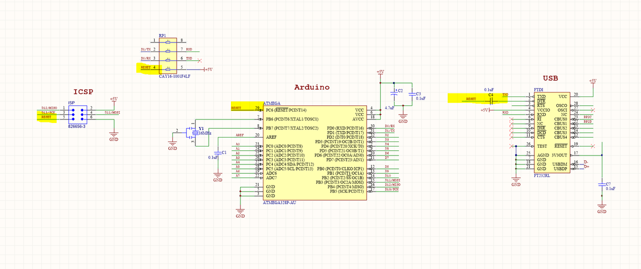

If you think the FTDI chip might be involved, the next step is to work out possible ways in which it could cause the symptoms you're seeing.
Are there any physical pins on the FTDI chip that are also shared with pins which are needed to burn your boot loader?
Without knowing the details of your design, I'd suggest two possibilities - either:
a) there's a logic signal (or signals) in common. Are your programming (SPI / reset) pins connected to the FTDI, or are they separate? If they're completely separate, then it really shouldn't be able to interfere with boot loading via that route.
b) they share a common power supply, and something bad is happening which is causing the voltage at the MCU to go out of spec during programming. Does anything get warm?
Another option (c) is that the FTDI chip is a complete red herring, and the difference is caused by heating, cooling and flux contamination of your PCB when you remove and replace components. Be sure to thoroughly clean the board after every rework operation, especially in and around the MCU crystal if it has one.

I am not saying the FTDI chip is the cause btw. Just that when removed and replaced with a known working one, there is no boot loader issues.
I am pretty much on board with the issue being the board design. Probably just coincidence that the old FTDI is working and the new ones are not?
No shared pins for boot loading other than RESET.
Boards are pretty clean. Been using acetone as that is all I have :/

I tried with just the ATMega328p, crystal and cap on the reset pin.
 Pretty sure it burned the boot loader. Was a few days ago and forgot to write it down. Ill try again.

Why have you got reset connected to DTR via a capacitor?
What happens if you remove that capacitor?
Copied from Arduino. Not a good design IMO.

It will go through the code 3-6 times and then hang.
THIS. You must understand why it hangs. If it runs at least 3-6 times it's not the hardware "broken" (intended as burnt or physically broken) probably. There is something changing or at limit on the hardware that is affecting the software readings, maybe.
Could be a power issue or an input issue.
Assuming the power is perfectly fine and there isn't some glitch, noise or bounce affecting the MCU (which you can be sure only with a DSO) when something happens in the code running, you should use a debugger to understand what's happening into the MCU.
If you cannot use a debugger, try to comment your code in excess and output this comments in serial, to use them as "poor man debugger", so you can see at which point it hangs.
Depending on what the code is doing when it happens, you could guess better what's the cause.
But be sure about the power rail.

.. The schematic showed a ICSP header... I presume that is what is being used to program the uP?  The requirements for ICP are minimal... if it isn't working on Rev3 boards you either have some extra shorting to ground (due to errant ground pour) or dodgy chips.
Ignore any talk about Flux, ESD etc... until all the obvious has been eliminated.  For now just use a multimeter on continuity to determine if any ground shorts on Rev3 boards.
Yes the ICSP header is for programming.
I can't find any pins on the MCU that are grounded that should not be.
