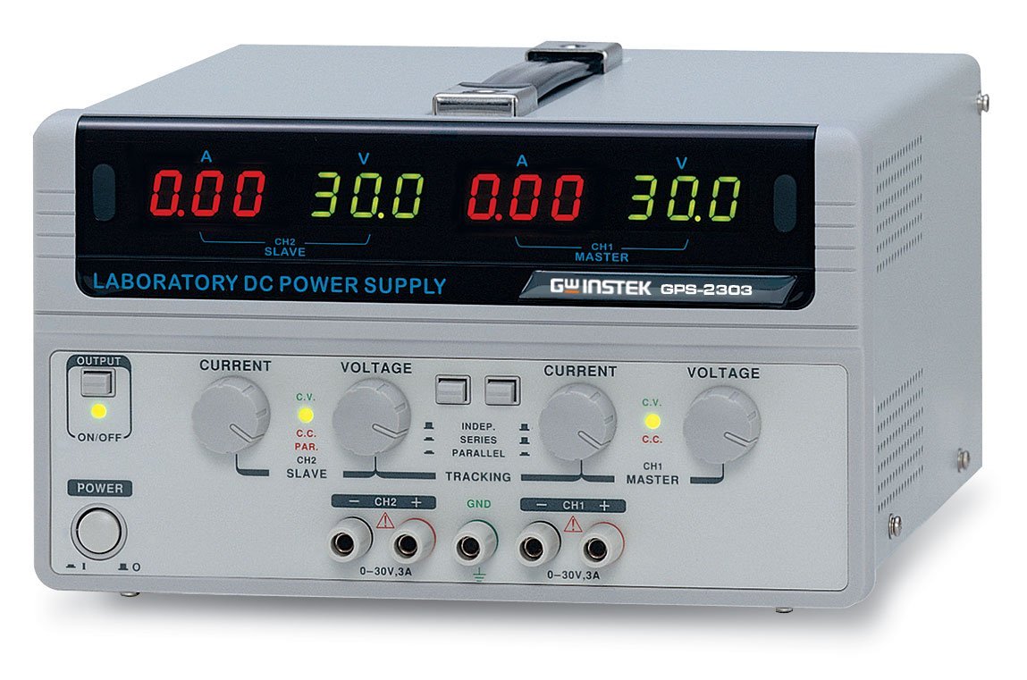

I'm a good physician, but lacks many knowledge in electronics... I need to supply a servo driver with a +-18V (to +-30V) power supply.
I got a FI 1333 power supply for this task than has a mass, a - and a + output and delivers voltage from 0 to 30V.
But when I look at its output on my oscilloscope, connecting one wire on mass/ground and the other on + I don't see a continuous +voltage that i can shift but a sinusoidal oscillation. Same goes for mass and -. I only see a continuous voltage when i measure between - and +, excluding the mass.
I'd assume my servo needed -18V on one pin and +18V on the other, so a differential of 36V at least, and my power supply doesn't provide it. So do I need a ~40V power supply ? Or is my power supply enough and I just don't understand something ?
Why is the voltage indicated on the power supply not the voltage between the mass and + but the one between - and + ? If I set my power supply to 30V and connect the -, the mass, and the + to my driver will it be powered with +-15V or +-30V ?
Many thanks for your help
Adrien

It looks like your power supply can be used as a dual tracking supply (outputting equal + and - voltages) if wired correctly. Make sure it is wired similar to this one and that the two voltmeters have identical readings. It should work.

On this type of power supply the "mass" or GND is not connected to any of the actual power outputs, unless the user deliberately "straps" one of the outputs to the GND (mass) terminal.
So when you have your scope connected to GND (Mass) and one + or - output terminal-- you aren't seeing the power supply at all, you are actually seeing your home's mains wiring leakage.
To have the bipolar supply your servo circuit needs, use the connection above. Left channel minus is the minus output. Left channel plus and right channel minus connected together, this is your circuit's "zero volt" reference point (COMMON or GND for the servo driver). Right channel plus is the plus output. Tracking buttons select "SERIES" mode. Voltages set to 15 volts on each side. Current limit set as appropriate on each side. The power supply's "mass" or ground terminal may be left disconnected.

Putting the power supply in serie mode and wiring between the left - and the right + indeed provides up to a 60V differential output, allowing me to satisfy the servo +-30V needs.

OK.... in your photo it looks like your PSU makes the series connection internally when the buttons are pressed for serial connection. So you have the two outputs connected to the scope in series, giving you the 30 volts total. But you have both channels of the scope reading the same connection (the green jumper). And you have the PSU's minus output connected to scope and PSU ground (through the scope's BNC shields.)
This isn't really the way you will connect to your servo driver. With the series connection as you have it, the PSU's Ground terminal is NOT at the center, zero voltage level of the differential. Rather, you have it connected to the minus of the differential output. The servo plug will be looking for the zero level in the two center pins, not the PSU's ground (which will be the mains ground if you have the right mains plugs.)
Since your PSU evidently makes the series connection internally, you should be able to see the Zero level at both of the "unused" terminals of the channel outputs.  You can test this with a multimeter.

It appears that this may be a GWInstek unit.
https://produktinfo.conrad.com/datenblaetter/500000-524999/511529-an-01-en-ZWEIF_LABORNETZGERAET_GPS_2303.pdf
GPS 2303
When the left switch is engaged (in) and the right switch is disengaged (out), the
unit  is  in  the  Tracking  series  mode,  maximum  voltage  of  both  supplies  is  set
using  the  CH1  VOLTAGE  controls  (voltage  at  output  terminals  of  the  CH2
supply tracks the voltage at the output terminals of the CH1 SUPPLY). Also, in
this  mode  of  operation,  the  positive  terminal  (Red)  of  the  CH2  supply  is
connected  to  the  negative  terminal  (Black)  of  the  CH1  supply  to  allow  the  two
supplies to be used as a 0 to double rating voltage supply.

If you check the diagram I posted in reply #2 you will see that is not how you wired your supply. The diagram I posted shows that the ground (mass, earth) connection on that supply is to the far right and is not used. The '+' of the left supply is connected to the '-' terminal of the right supply and that is your common (return) of the two supplies. As others have pointed out, neither the left or the right power supply channels is connected to ground and you don't need to connect any wire to the ground terminal.
Having the switches set to the series connection allows the master supply knob to control both channels but you should have a jumper between the '+' of the left supply and the '-' terminal of the right supply and this is also your common connection of the two supplies.

Arthur, I am 99 percent sure that this power supply automatically makes the series connection internally (see the excerpt from the manual I quoted above.) So it is not strictly necessary to jumper externally when the buttons are pressed for "Series". The "zero" level is available at both of the "unused" terminals of the two PSU channels. This can easily be checked with a DMM.
You are of course completely right about the PSU's "Ground" jack; this would normally be NOT CONNECTED at all for this application.

Sorry for misunderstanding my picture was just for showing I had a -15 tp +15V voltage, indeed the ground is on the unused parts (left plus and right minus).
For clarification, this is how I intend to wire my pins (picture attached).

Ah, the wiring shown in your last photo is correct and I would now agree with SOLVED

I would double check the polarity of the servo connector.
Using Green/Yellow wire for the Positive and Red wire for the Negative is a little confusing to me...
And it is a little suspicious that the PSU's "overload" LED is on, but the LED on the servo driver board isn't... ?
