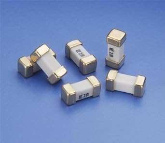

« Reply #4 on: November 18, 2018, 10:16:39 pm »
Probably blown fuse as well. Also measure resistance of R005 part on top right corner which seem to be 5 mOhm shunt resistor.

How can I test the mosfets?
Fuse? How to look for it?

« Reply #6 on: November 18, 2018, 10:56:08 pm »
Look for something like this in between circuit on the photo and charging connector.
