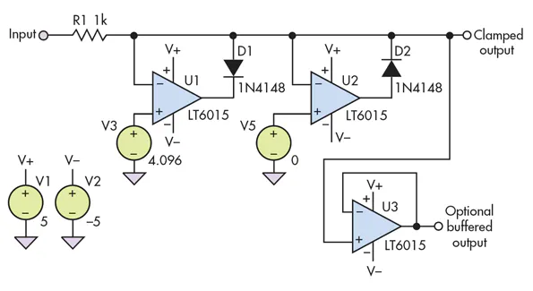

Hey guys,
Just curious, is it possible to implement the following input/output voltage response utilizing analogue circuitry only?
V_IN    V_OUT
0.0          3.5
1.0          3.5
2.0          3.5
3.0          3.5
3.5         3.5
4.0         4.0
5.0          5.0
6.0          5.0
7.0          5.0
So, basically, input control voltage (V_IN) can be in the range of 0-7 VDC
Min output control voltage (V_OUT) - 3.5VDC, even when V_IN is lower.
Max V_OUT - 5VDC, even when V_IN is higher.
If V_IN is >=3.5 and <5.0 VDC - V_OUT is following the input.
Regarding the max limit, I can clamp it with a Zener diode, but what about the lower limit?
Appreciate any ideas.

A formula for your output is: Vout = min(5.0, max(Vin, 3.5)).
This stackexchange discussion mentions a couple of ideas for computing the max of two voltages:
https://electronics.stackexchange.com/questions/218496/passing-greater-of-2-voltages-using-5v-signal
and one of the ideas is a detector using op-amps:
For computing the min you can use a Zener as you mentioned, but if you need the limit to be an arbitrary value I found this other stackexchange discussion:
https://electronics.stackexchange.com/questions/316848/how-would-i-make-a-circuit-that-takes-a-voltage-v-as-input-and-outputs-minv
It has a couple of interesting ideas including the analog of the op-amp max circuit above (instead of a pull-down to GND R1 is a pull-up to the positive rail and the direction of the diodes are reversed.)
« Last Edit: August 12, 2025, 12:41:17 pm by ledtester »

Offline TimFox
  • Posts: 11867
Re: Limiting lower and upper limits of a control voltage
« Reply #7 on: August 12, 2025, 05:36:09 pm »
You might apply the approach in this article:
https://www.electronicdesign.com/technologies/analog/article/21801600/op-amps-make-precision-clipper-protect-adc
The example circuit shown uses "precision clamps" to prevent the output from going out of the range defined by the two reference voltages (0 and +4.096 V in the example), but the output follows the input in between those values.
The lower voltage (0 in the example) could be a positive voltage less than the higher voltage (+4.096 V in the example).
The voltages can come from a resistor voltage divider, since the current drawn by the two op-amp inputs is very low.
Note that the article discusses the requirement that the op amps not have diodes between the two inputs, and can tolerate a high differential voltage.
The following users thanked this post: Phil Smith, Nominal Animal

Currently I've implemented the circuit (see attached) which initially was proposed by ledtester simply because I wanted to modify the existing PCB and had x2 spare opamps anyway. It is not very accurate nor very stable (due to zener diode nature) by it works.
Next step is to revise the PCB design and for that I plan to use Zero999 solution with x1 opamp and x2 mosfets.
All reference voltages are supplied via 10V voltage reference IC, then a trimmer pot following by a buffer amp.
Desirable tolerance for control voltages is +/- 0.1V

Thank you Zero999, TimFox & MrAl,
much appreciated you help  :-+

Yes the op-amp's output hits the rail, once the voltage exceeds the limit. That's not a problem at low frequencies, but can lead to glitches as the slew rate of the input goes up.
Here's a simulation.
The horizontal scale is the input voltage (V3) which is swept from 0V to 7V. The vertical traces are voltages at different parts of the circuit. The yellow is the output voltage, the red, the output of U1, green, the output of U2 and cyan, the input current flowing though V3.
The large voltage changes on U1 and U2's outputs can be seen, as the output voltage exceeds the limits, when the input current increases, as it's being diverted into U1 and U2, as they clamp the voltage. I reduced the positive supply voltage from 12V to 9V, just to make the plot more clear.
* op-amp limits.asc (2.25 kB - downloaded 11 times.)
Adding extra diodes and resistors can alleviate this issue. The diode connected between the inverting input and output (D4 and D6), thus closing the loop, when the op-amp is clamping. R3 and R4 are required to prevent the current though the diodes from clamping the input. U3 is a buffer. R1, D1 and D2 limit the input before it goes into the buffer. The shunt resistor (R2) can now be lower because the voltage is already clamped by R1, D1 and D2.
The voltage swing on the op-amp outputs is now smaller. Note the scale of the vertical axis has changed from 0V to 9.9V to 3.2V to 5.4V
* op-amp limits improved.asc (3.84 kB - downloaded 22 times.)

Did you not look at the article TimFox linked to?
It looks pretty good to me. I've simulated it and it will work. More later.
WOW! That's awesome, thank you Zero999 for a such in-depth reply.
I think I like this solution the most, as it's utilizing the same component I already have in the design - opamps, 1n4148 diodes and couple of resistors, so no additional BOM items needed comparing to the MOSFET solution. Plus there are no active circuitry between input and output.
If its just low frequency/DC and you're happy with the output impedance of 1k, then I recommend the first one.
Yep, it is just DC control voltage, input is taken from photodiode amp (x3 stages, ranges from 1v (dark) and 12V - bright sunlight) and output is driving x3 mosfet gates in parallel, which are current sink for 100W COB LED, which in itself is a backlight for a 4" square LCD.
3.1v is min voltage requred for those mosfets to start conducting and 3.5V produces enough backlight for image to be visible in the dark, hence I dont want it go below this figure.
PS. it is a Head-up display for flight sim. Some pics are enclosed. Pardon the cracked combiner glass, it is all I could find on the ebay for now :) It is from tornado GR4 aircraft.
you can use 3 voltage regulators and MOSFET's controlled with voltage detectors to connect appropriate voltage regulator output to the load.
So, as far as I understand, it is pretty much what Zero999 suggested initially
Yes, it sounds similar to my original idea.
Note that it also has the issue with the op-amp's output saturating. For completeness, here's a plot of the op-amp's output.
