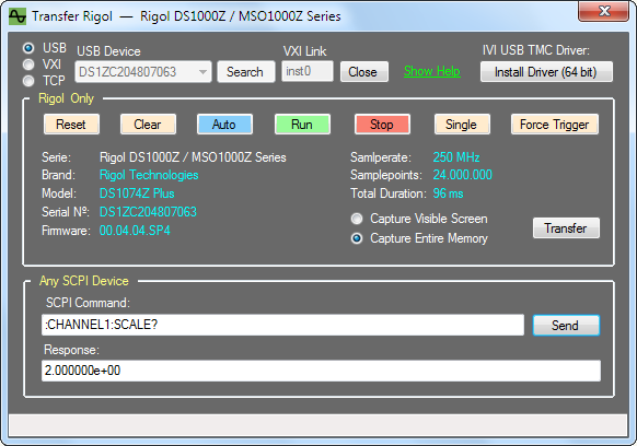

« Reply #2 on: March 05, 2025, 11:52:51 am »
Hello
What you are showing here requires to install the HUGE VISA runtime.
Alone the installer has the size of 1 Gigabyte.
After installing NI-VISA you will have 12 (twelve!) services permanently running in the background.
So you recommend to install 1 Gigabyte just to do a simple communication with a Rigol multimeter?
This is like throwing an atomic bomb to kill a bug.
For me it was never an option to install this VISA monster.
Therefore I wrote my own software Oszi Waveform Analyzer in C# which communicates over USB or over ethernet using the VXI-11 protocol or plain TCP.
I publish my software open source so you can use the code for any SCPI capable device in the world.
The only thing you have to install is the tiny USB driver of 24 kilobyte.
Yes! You have read correctly: 24 Kilobytes instead of 1 Gigabyte!
My code communicates directly with my oscilloscope needing nothing more than .NET functionality.
Here you see the window that communicates with my Rigol oscilloscope:
Download and detailed description here:
https://netcult.ch/elmue/oszi-Waveform-Analyzer
