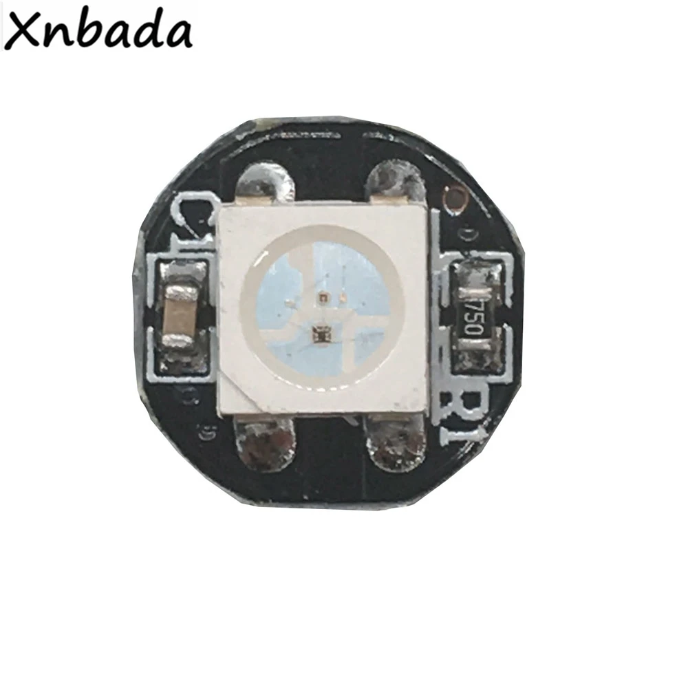

Hi, I want to focus light to acrylic fiber optic cable and want brightest RGB LED.
I have one like this 5050 SMD WS2812 LED Chip:
Aliexpress link
Do you think this is RGBW would be brighter?
Any other similar variants? (~5mm size)

You can get RGB LEDs rated for many watts, the higher power ones will require an external driver IC though.

« Reply #6 on: February 21, 2023, 06:28:58 am »
Brightest will be something like a 100W COB RGB LED.
but you'd need a focusing lens setup to get it small enough to feed down a fiber.
And it has no driver built in.
https://www.aliexpress.com/item/1005004713012104.html

Not enough information has been provided by the original poster to answer the question.
Does the LED have to have a built-in driver?
What's the cross-sectional area of the optical fibre?
How important is colour mixing?
What are the power supply requirements?
Dimensions?
Cooling?

« Reply #11 on: February 21, 2023, 09:33:03 am »
Would be great, but would be ok to have separate driver board also. Would be great if controllable with MCU.
Optical fiber diameter 3mm. I can use lenses up to 10mm.
Must be at least RGB.
20mah-1A, would be great if controllable with MCU.
Dimensions?
LED diameter from-to 3-10mm.
Cooling?
Better solution without cooling.

LOL, but you trust random ones without any specs from Aliexpress. Luminocity spec is not random, it can be orders of magnitude different at the same current depending on technology and binning. Similar package means nothing. One manufacturer can make similarly looking LEDs in the same package that have 100 times different brightness.
