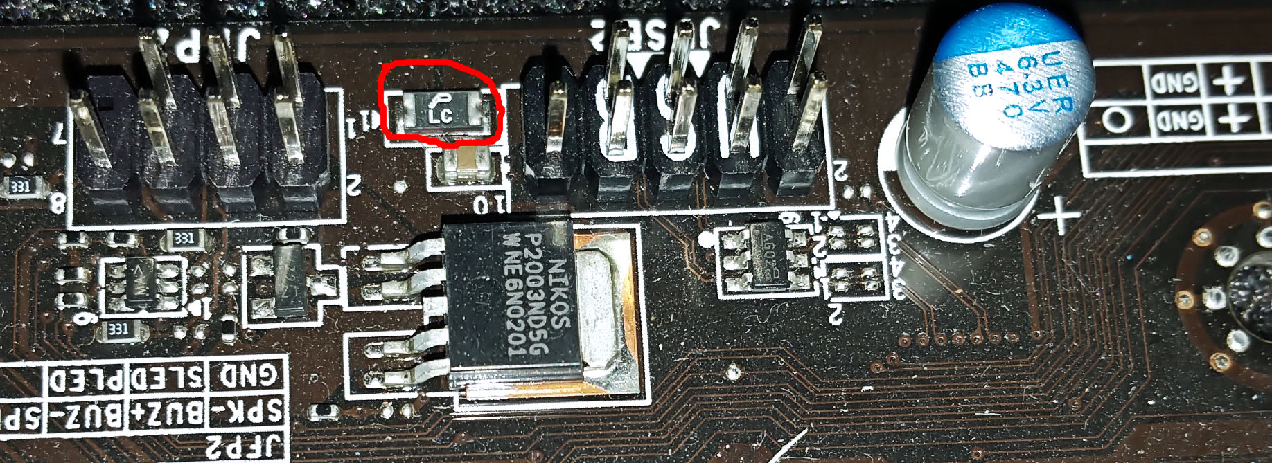

I have a Mainboard wich starts (everything lit up, CPU gets warm, Fan spins etc.) but did not bring anything to the monitor.
On closer inspecting I noticed a burned component near a Power-Stage. The part is totally burned away so I cannot read any markings. Fortunately I have a very similar Mainboard were the arrangement is nearly identical.
Can someone tell me, what this component is?
And should I also replace the capacitor below?
The NIKOS below the capacitor is a "N- & P-Channel Transistor". Can I check this thing while in circuit or should I change it anyway?
Thanks for any help!
best wishes
Thomas
It's a 7A trip, 3.5A hold, resettable fuse, made by PPTC. Part number SMD1206P350SLRT by the looks of it.

I'm quite sure it is Polytronics PTC. You may try to search their catalog for exact match. Probably there is a failure down the line.
If capacitor is not shorted and looks ok, just leave it. If there are heavy burnmarks and PCB is carbonized, then definitely clean that area, remove carbon and replace capacitor, because it might be damaged by heat.
Ivestigate which power rail this PTC protects and look if anything is shorted on this rail. Yes, most often you can test mosfets and bjts in circuit.

Ok ... had to order a replacement (nanoSMD350LR-2) wich has arrived yesterday.
I removed the fuse checked the cap, wich was fine, and soldered the new one in.
The Board now starts again.
But it won't pass post (stopping at 8A) when a PCI-e card is inserted.
Tomorrow I will check voltages on the PCI-e connector. According to Wikipedia there should be a 12V and a 3.3V rail.
Mhmm ... but the dead fuse protects the 5V rail ... could be more than one issue.
Any tipps what i can check besides this pins?

Yes. I tried 3 different, known good, cards. When I unplug the card the system boots. Everything else is working except these damn Slots.

I have checked Voltages and they are Present:
Pin 1+2+3 (top)    = 12V
Pin   2+3 (bottom) = 12V
Pin 10 (top+bottom) = 3.3V
When a card is inserted into one of the 4 PCIe Slots the Boot-Screen stops at the following Post-Codes:
PCIe-16x Slot 1: A0
PCIe-1x  Slot 2: 99
PCIe-1x  Slot 3: 99
PCIe-16x Slot 4: 99
Curiously Ctrl+Alt+Del is still functional with Slot 1.
I also noticed that the DSUB (VGA) is not working.
I checked every fuse on the pcb with no luck and ran out of ideas.

Sounds like something non-trivial is broken, maybe the chip that drives the slots?
Might be an idea to look on eBay for a replacement motherboard?
