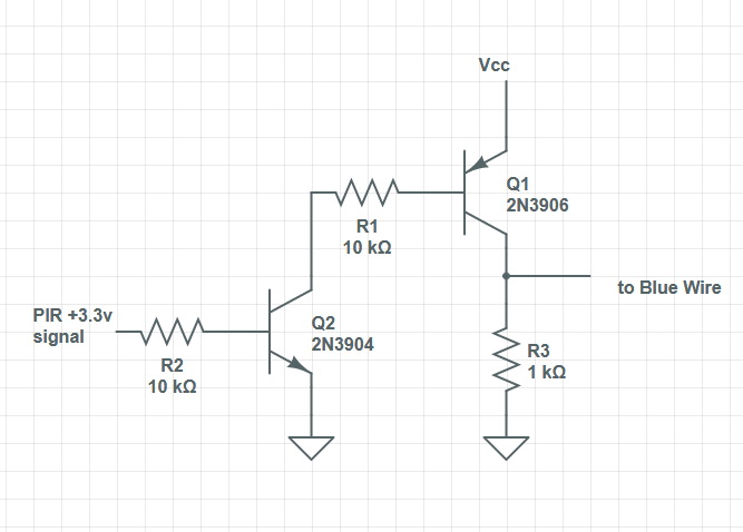

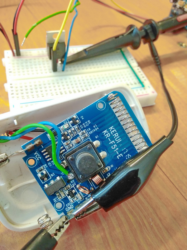

I have a wireless doorbell.  Its switch shorts Vcc with some other point in the circuit.
I also have a PIR sensor with a 3.3V control signal.
What I want is a circuit that when the PIR control signal is high, it will short Vcc with the
other point on the circuit.  Like pressing the button, so the wireless doorbell will chime
with motion as well.

Just tried with a IRLB8743 MOSFET and didn't work.
Drain to Vcc, Source to blue wire and PIR signal to gate together with a 10k to ground.
Green wire goes to Vcc, and I want to bridge blue and green together.
SilverSolder, I thought of that as well, but I don't have any available at the moment.
It also needs 10mA.

Online Ian.M
  • Posts: 13216
Re: Simplest circuit to connect/diconnect a wire.
« Reply #15 on: April 20, 2019, 02:33:27 pm »
No optocoupler is needed if you can link PIR 0V to bell 0V.  You only need the optocoupler if you need isolation.
OTOH an ordinary BJT  output optocoupler could replace the N-MOSFET with its output transistor collector directly pulling down the P-MOSFET gate.
The following users thanked this post: hgg

I think we were all assuming it needed to switch a lot of current to power the RF transmitter module.  If its only a logic signal power MOSFETs would be over-kill.
If you can guarantee to wire the load side the right way round, an ordinary BJT output optocoupler would probably work OK.  If you get it wrong, 10uA wont do any damage to it so if you cant identify the Vcc wire to hook up to its collector, just swap the output wires till it works!  If it rings continuously, you may find it needs a pulldown resistor to bell 0V on the load side to deal with any leakage current when the optocoupler is off - 100K would probably be suitable.
« Last Edit: April 20, 2019, 05:46:56 pm by Ian.M »

A single MOSFET did not work.
Two MOSFETS with connected source to source and gate to gate did not work either.
The only thing that finally worked was the following:
The following users thanked this post: Ian.M

That looks good.  Funny how even the simplest projects can end up surprisingly complicated!

Well, from the OP’s experiments and the solution he came up with, it looks like the PIR output is a bit wimpy. Not sure whether it could drive a relay directly?
