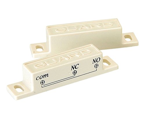

Does the locker door, reliably open/close when you need to switch on/off. A more robust and simpler solution would be to use a reed relay, which needs no power or circuitry at all. It just needs a suitably rated reed relay, in the door and a magnet, on the other side of the door (difficult to explain in words).
I.e. like they use in some burglar alarm window/door sensor switches.
Image for illustration ONLY. You need the correct, probably normally open type (or is it normally closed, I'm NOT sure in this application, which way round it goes, sorry), and suitable current rating parts. One end goes on the door, the other on the "wall" part of the locker. Potentially eliminating the entire rest of the circuitry.
You want closed when the units are separated and open when they are close together. I can't remember or don't know which way round they normally are.

If the locker is metal, the magnet side of that doesn't even need fastening. It'll stick on it's own. If it's too weak to not slide, you can replace it with a more powerful generic magnet.
Another option if you're using an arduino is to have it sense when the door is open with a photo-sensor (assuming lockers are dark and hallways aren't). Arduinos have some very low power modes if you program them right....battery consumption in the "off but checking an input often enough" state wouldn't be an issue.
