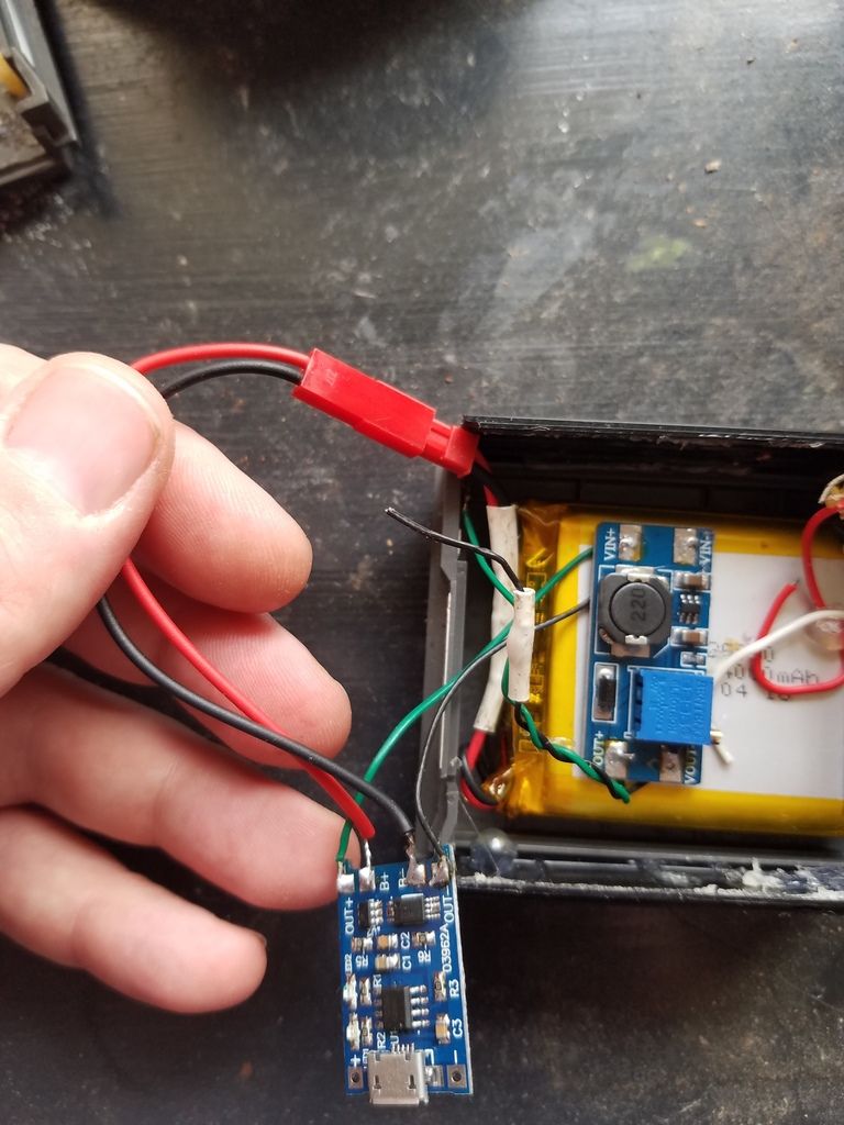

BLUF:  I don't know how to troubleshoot a generic setup of Lipo cell ->charge controller-> boost converter->12v load and I'd like some help.
Long version:
I recently got 'hold of an old Yaesu UHF transceiver.  The battery is labeled as 12V, 500mAH and hasn't been charged in probably 30 years.
Thinking this would be a pretty fun little project to get working again, I tried to do a little homework online but didn't come up with exactly what I needed, so I went off past experience of a few other project where I simply powered a Raspberry Pi with a lithium cell and a charge controller; I figured I had all the know-how I needed and ordered up some parts.
I got a (All generic) 3.7V, 4K mAH cell and a 5 pack of cheap TP4056 based charge controllers, as well as found a boost converter that I had left over from another project.
Everything arrived and I set about pulling out the old nicad cells and fitting the new bits into the battery housing.  After charging up the battery and loosely fitting everything in place, I adjusted the boost converter to 12.8v and the radio came to life.  Project done!  Only not so much.
Seemingly randomly, the radio would shut down.  A voltage check across the battery terminals shows 1.1v.  Following back, I get 1.1v at the output of the boost converter, 1.1 at the input of the boost converter, 1.1V at the output of the charge circuit and 4.x volts at the input of the charge circuit...4.xx volts at the output of the Lipo.
This 1.1V output is intermittent enough that I can't figure out what the problem is.  Some times, I can remove and replace lipo cell and it's fixed for a while but some times I can measure 12v at the battery terminals but when I turn on the radio, I get a flash of life then nothing...and I'm back to measuring 1.1v at the terminals.
Sometimes I can get the radio to turn on, where I just leave it for a few hours and everything is great, 'till I turn it off, then back on and back to 1.1v.  Sometimes turning off and on works as it should. Sometimes, if I hook the charge circuit up to USB, as if I were charging it, it pops back up to 12V and may stay there for a while or it may not.
Thinking it was the charge circuit because I got the cheapest ones I could, I swapped it with a new one from the same order (The only ones I have)...same deal...and a 3rd one, all with the same result.
Since I get the 1.1v at the output of the charge circuits, I'm pretty sure that's the problem, but where is the solution?
Do I just buy a more expensive, and presumably better quality, one from a place like Adafruit?  Is there more troubleshooting that needs to be done?  As cheap as the chargers I've bought are, I'd hate to think that 3 (so far) out of 5 could be bad out of the box.  Maybe there's something more obvious that I'm missing.  I can post pictures of it all, but with the intermittent 12V I'm reasonably certain that everything is soldered up properly.

The capacity of the lithium cell is probably 1500-2000mAh at 3.8V, so ~8Wh. If you originally had 10 NiCd cells that were 500mAh, at 12V, that would be 6Wh. So the difference is not so large. But you could always parallel a few 18650's if you want greater capacity.
Is the circuit something like this:
https://www.aliexpress.com/item/5PCS-Micro-USB-5V-1A-18650-Lithium-Battery-Charger-Board-With-Protection-Module/32647794396.html
DW01A: http://cxem.net/master/files/97_DW01A-DS-11_EN.pdf with overcurrent 150mV
If the FET is 8205A: https://www.maritex.com.pl/product/attachment/91261/8205A.pdf
rds on about 25mOhm*2
So overcurrent trip point is roughly 3A. There is a chance the boost converter is pulling a lot for a short time, meaning the charge board shuts off (could be why you see 1V).
Its normal for the TP4056 to get hot as it is linear charge, so its dropping 5V - Vbat across.
Do you have a bench PSU you can test at 12V to check if that voltage is high enough, and what peak draw is?
You have typoed something, perhaps?
...and
AFAIC, the input of the boost converter and the output of the charge circuit and the voltage across the LiPo terminals is the same node. It can't be 4.xxV and 1.1V at the same time, unless you have some circuitry in there that is not implicit/expected. :-//
That said, when you try to transmit, that takes power. If it was your boost converter that was the bottleneck, the inductor would saturate and the voltage would plummet. But you should probably measure at least 3.6-4.2V. If it were the battery's internal protection circuit, 1.1V sounds feasible as a leak or something. But I would be a bit surprised to see a 4Ah LiPo cell with max discharge rate less than 4x (to account for the boost) w/e current that old 12V 500mAh NiMh had supplied.
So it's a weird thing you got there.
Edit: oh wait, it is NiCd. Those can discharge insane current.
Have you tested the radio on a lab PSU or whatnot? This where it is helpful to remove variables. Maybe the radio is damaged.

I get 4.xV at the lithium cell, 1.1v at the charge controller output and about 1.1v at the output of the boost converter.
I am missing something if this makes sense to everyone else.
If you measure 4V at the lithium cell, how is the output of the charge controller 1.1V? Are they not one and the same, connected directly together, along with the input of the boost converter?
Maybe I have mistakenly assumed the charge controller is to charge the (li ion) cell/battery? Or is there more than 1 battery in your circuit?
Earlier you said this:
There was a charge circuit. Same as charge controller? Do you have it hooked up backward, by any chance? None of this makes sense.
It sounds like you are powering the charge circuit with the li ion cell. And then using the output of the charging circuit to power the boost converter?
I feel like the kid that has to sit in the corner with a dunce cap. Cuz this sounds all kinds of stupid to me.
« Last Edit: July 29, 2018, 05:21:12 am by KL27x »
Offline KL27x
  • Posts: 4108
Re: Switching from Nicad battery to Lipo: Am I doing this right?
« Reply #13 on: July 29, 2018, 05:35:07 am »
No clarification, no answers from anyone else who is helping. OK, so this is my GUESS.
Since other smart people are answering this like nothing's wrong, I feel like I am wrong.
But I would expect this to work a hell of a lot better:
Lipo cell > X > IN boost converter OUT > 12.8V output
External power supply > IN charging circuit OUT > X
The LiPo cell, charging circuit output, and the boost converter input are all connected together. (This is why there are two pairs of solder pads in the charge circuit board on the output side, marked as the Battery +- and the Output+-). The voltage you measure on any one of these 3 things will be the same. And it should be something like 3.5 to 4.2V, depending if the radio is on/off and how charged up the lipo is. You cannot measure 4V on the lipo and 1.1V on the charge circuit output unless you have it hooked up in some way I am curious to understand the purpose of. If you cannot draw up a schematic, maybe you can at least tell me what is the charge circuit? Why did you buy it, and what do you expect it to do? It's definitely not going to charge your lipo if you connect the battery to the INput and have no external power source in sight.
[edited for errors]
*Ok, just looked at your link to peek at this board. kjr18 suggests this board might be used for output protection. And looking at the board, he is correct. (But this doesn't change the way you connect it. Still gotta do it my way).
The big chip is the charge IC. The tiny SOT is a voltage detector. The medium chip is the output FET/switch.
The battery goes on the  B+- pads. It looks like the B+ and Out+ are in continuity. The FET looky thing is next to the ground pads, and it would be an NFET, drain on the OUT- and source on the B-. When the voltage goes under the specified level, the detector switches off the NFET and saves the day.
But you have soldered your battery to the Input pads. The input pads will likely be directly connected to the USB connector power and ground. That would be so you could hardwire a 5V power supply in lieu of using the USB connector. So if you plug it into a USB port in this state, and if the power source doesn't cut out immediately, you will damage your cell.
This explains your readings. You are powering the battery charger input with the battery and using the charger output to feed the boost converter. The IC detects no voltage on the battery and initiates trickle charge. This kicks the boost circuit on and gives the radio just enough juice to malfunction. And the resulting voltage at the output of the charger/boost input is 1.1V. Which is not enough to power the voltage detector, either.

If you have your circuit like that one below, there are some possibilities why it has problems with working properly.  If your connections are different, then it might be the cause for your problems.
First problem: Your battery protection ic triggers because of too high current draw. Solution for this is to use different source.
Second problem: Your boost module might be not suited for lower input voltages, with battery voltage drop under load it might stop working.
Third problem: Your boost converter might be too weak to handle this task.
After all we might help you, but we need a bit more info about your circuit, used modules etc.

Ok, I finally got home so I could piddle around with this thing again..  I attached a  picture of the little setup I have, and I'll edit this post if it doesn't show.
The white and red wires opposite of my hand are nothing, they were part of the old battery and attach to a little barrel jack.
The black wire swinging in the breeze is the negative out of the boost converter and is normally attached to a negative terminal on the other half of the plastic battery housing, I removed it for clarity.
Of course, the circuit stuck to the side of the battery is the boost converter and the other is the charge circuit, which I feel is the culpret.
I was able to get a semi-reliable connection to my meter and wall wart.  With the radio not programmed, I can't transmit even to test, so the most load I was able to get was by turning on the back light.  I read .066A with the radio on and squelch off and .101A with the backlight on.
I think tomorrow, or maybe Tuesday, my newer charge controller should arrive.  I should get a steady output from that one...and if that's the case and all this is fixed, I'll steer clear of buying the cheapest stuff I can get from now on, maybe.
Once again, thank you all for the help in this!

Offline KL27x
  • Posts: 4108
« Reply #19 on: July 29, 2018, 09:49:33 pm »
I found the datasheet for the output protection IC. I wondered if/how one could increase the output current threshhold.
The discharge overcurrent detection voltage (VDIOV) is V6 when VDO is set to "L" after increasing V6 gradually from
the initial status 1.
2. 4 Load Short Circuit Detection Voltage (VSHORT)
The load short circuit detection voltage (VSHORT) is V6 when VDO is set to "L" after increasing V6 gradually after
setting S3 to ON from the initial status 1.
2. 5 Charge Overcurrent Detection Voltage (VCIOV)
The charge overcurrent detection voltage (VCIOV) is V6 when VCO is set to "L" after decreasing V6 gradually from
Good plan.
Just plugging in  a vanilla guesstimate of 100R tops for the Rds of the output FET, and overcurrent voltage detector of 150mV, that puts the max current in the ballpark of 1.5A, min. Perhaps up to something like 10A realistically, on the high end (unless it has charge pumps for the gate driver). This is just guesswork from what I understand in there. I just can't figure out that datasheet. It's a doozy. I suppose there's some oscillation of this circuit if that is what is creating the 1.1V.  It 'posedly has some hysteresis/smarts, but damned if I can read that schoo.
With 1A load at 12.8V it takes 3.7A at 4V. What a piece of crap, 60% efficiency.
I had to do a doubletake; I would be happy with those numbers on my own boost circuit. So with my calculator, I come up with 86.5%  :-//
« Last Edit: July 30, 2018, 12:00:55 am by KL27x »

I would start by replacing that charge/protection module with a charge only version, your battery already has a protection circuit in place.
The protection circuit in the charge/protection module maaayyy be causing the issue as it isn't designed for your battery in particular.
