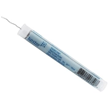

Thanks for responding, Pat! The diameter was thinner than the plumbers solder I'm used to, but thicker than the electrical solder I'm familiar with.
One feature I forgot to mention is that it's in a roll shaped like the one in the following picture, only about twice as long and the roll diameter is about 3 times larger than the following (I have one of the following):
Do you know if plumbers solders ever come in rolls like that?

Hi Jay -
The electrical solder I usually use is 0.031" (0.8mm).  I've also seen (and, in the past, used) thicker electrical solder - about 0.062" dia.  I've never seen plumbing solder in a dispenser pack like you describe, but that doesn't mean it doesn't exist.
Is it solid, or flux cored?  A quick glance at McMaster-Carr shows solid 50/50 solder in 0.062 and 0.125" diameters.  Cored doesn't rule out it being non-electronic - they do make acid core solder, but non cored (solid wire) pretty much rules it out as being an electronic solder (again, in my experience).
Could you post a photo of the solder and package in question?
Do you have a temperature controlled iron?  The 50/50 melts at a temp about 45*F hotter than the 60/40 does (420*F vs 375 for 60/40 and 360 for 63/37).  If you have a temp controlled iron, try setting it for 390-400*F.  If the mystery solder doesn't melt, it's likely 50/50.
If you don't have access to a temp controlled iron, melt a blob of 60/40 and a similarly sized blob of the mystery stuff on something you don't care about scorching (a piece of wood or PC board scrap, for instance).  Heat each in turn to molten (try to heat for about the same amount of time, and note that if the mystery solder takes longer to melt it's likely 50/50), then stir with a piece of wire or the like as they cool and solidify.  The 60/40 should go from liquid to solid relatively quickly, while 50/50 would still seem mushy and moveable for a longer period.
That's about all I can suggest off the top of my head.
-Pat

That could be old Rat Shack solder that's long ago lost its label.  They used to sell it in those packages back in the day.  Try melting a bit and sniff to see if the flux smoke has that distinctive rosin scent.  (I'm not sure what the acid core would be like, but probably more of an acrid, unpleasant smell based on the plumbing I've done.)  Obviously, don't take a huge snort of it, just a slight whiff.
-Pat
