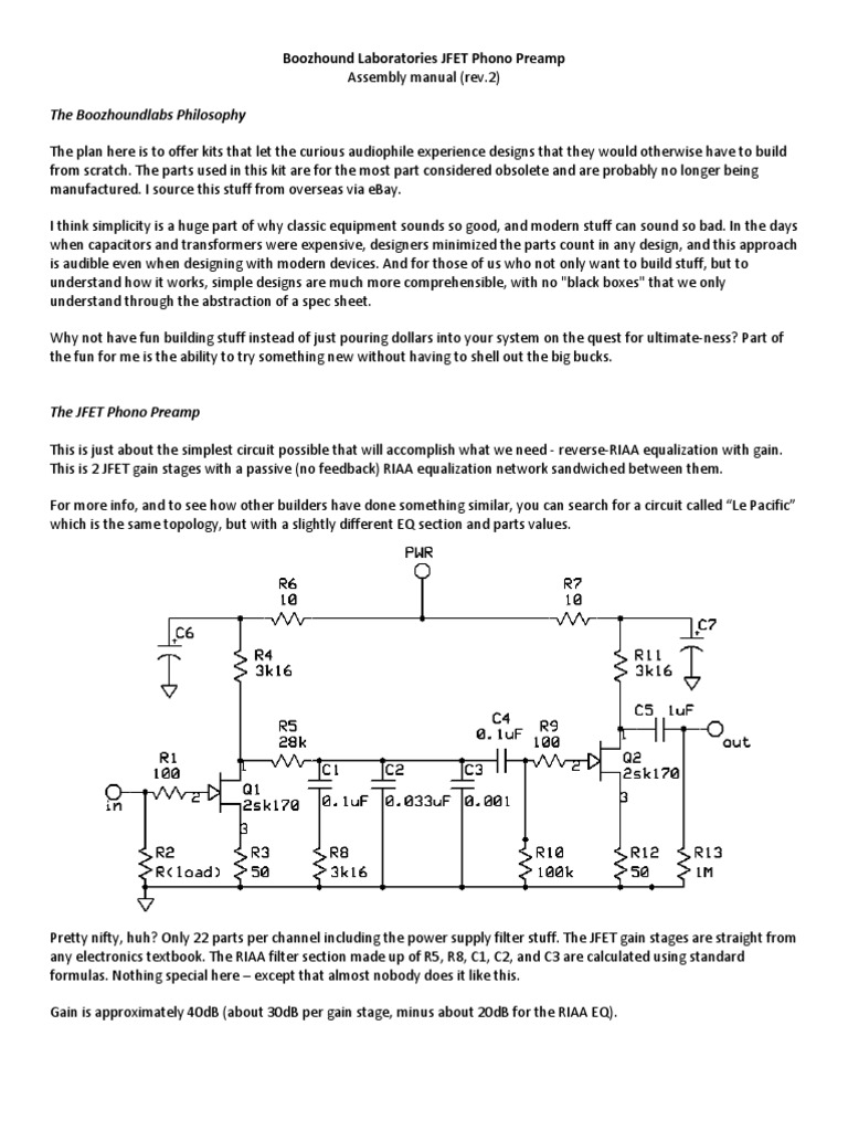

Hello,
I've searched the web before posting here, but can't find the answer.
I would like to build a JFET RIAA Phono Preamplifier described here:
http://diyaudioprojects.com/Solid/JFET-Phono-Preamplifier-Kit/
Here is the schematic.
Everything is clear to me, except the value for the R2.
Does anyone have any idea what that value might be?
The other 2 components that are not specified are the C6 and C7 caps. I've been able to determine that they must be 220uF, 50V. Does that sound right?
Thanks...

Offline Paul Moir
  • Posts: 927
Re: Trying to find a resistor value for JFET RIAA Phono Preamplifier schematic
« Reply #1 on: December 03, 2017, 11:39:17 pm »
I'm only just acquainted with this end of electronics, but R2 should depend on the phono cartridge you're using.  It provides the recommended load impedance.
220uF for the power supply bypass caps should be plenty.  Half that would be plenty too.  50V seems a little unnecessary but I don't know what the power supply is.

I 'd set R2 = R10.

I guess I can just put a 100K trim pot and adjust the value, depending on the cartridge (I'm planning on using a Moving Magnet cartridge). Not sure how exactly I would set it, though. Perhaps I would listen for distortion, as I'm setting it?
Regarding C6 and C7, I just zoomed in on the image of the parts and I figured out those were 220uF, 50V caps. The recommended power supply is 18VDC. I'll start with 2x9V batteries and if it performs well I'll build a power supply later.

Well, here's an update...
After some more Googling I found this schematic...
...which is different from the schematic I posted initially. The initial schematic appears in this assembly manual...
..some other resistors also have different values in the new schematic and it looks like the new schematic is rev. 3, while the one I first posted is rev. 2.
But I guess I got my answer.

The load resistor should be what the cartridge manufacturer suggests. Each cartridge will perform better when the resonances are damped out. The nominal value for phono preamps is 47K, and a capacitance is usually specified too. Too small a load (high resistance and low capacitance) and the cartridge response will rise at the high end and you can get ringing. Too high a load and the high end response can drop.
The best thing to  do is to build the preamp and use the suggested load resistance and capacitance, and then adjust until you get a flat response and/or it sounds right.

R2 is the load resistor for the phono cartridge. Your phono cartridge datasheet will specify, for MM it's almost always around 50k ohms; R2=47k is fine there and common.
Sometimes there is a small capacitor across R2, also part of the cartridge's load (example below).
That (load) capacitance is usually obtained from the tonearm and RCA cable wiring. Thorens TD165 total measures 270pF. But if the pre-amp is close, inside the turntable, you'll have less (cable) capacitance and need to then add a small capacitor across R2, to meet the cartridge's load.
Example Shure V15 Type IV datasheet:
"Optimum Load: 47,000 ohms resistance in parallel with 200 to 300 picofarads capacitance per channel. Load resistance can be up to 70,000 ohms with almost no audible change in frequency response. Total capacitance includes both the tone arm wiring and amplifier input circuit. (Most amplifiers, tone arms and cables meet this requirement)."

The RIAA-specified load for MM cartridges is 47 kohm. Period.
No additional capacitance is needed, the coax cable between record player and amplifier will provide sufficient capacitance.
With moving-coil pickups it's a completely different story...

47 K load resistance seems to be standard - so ne real need to adjust this.
With load capacitance one might want to add some, if the cable capacitance is low. e.g. if the preamp is directly at the source. 470 pF is too much, more like 100-200 pF added.

Since OP wants minimum parts count, does anyone understand the purpose of C3?  This is an audio preamp and just about any garden variety capacitor should work fine over the frequency range.  Doesn't seem necessary to have C2 and C3 of different capacitor technologies to cover the entire frequency range.
I think, they put two caps C2&C3 in order to get better approximation with RIAA time constants. 3% correction of C2 seems useless  if not to build a circuit with 1% tolerance components.
 Googling over wiki for RIAA standard, I discovered an error in R5 value, it has to be 22 k. Definitely not a 28k, and tacking output impedance of the first stage amplifier, about  20.5 k
 There is a calculator
http://www.mh-audio.nl/calculateRIAA.asp
and outputs: R1=22000 R2=3198.958 C2=34.09nF C1=99.4nF
Since 34 nF is not available, it explains a necessity for C3.

The explanation for C3 makes sense from a math standpoint.  Since very few circuits in the time of LPs were built with 1% components I suspect the correction provided for C2 is a triumph of the calculator over the practical.  Remember this whole equalization scheme was invented when slide rules were king for calculation and thus 2 and possibly 3 digit accuracy was all that was normally achieved.
Perhaps someone will build a version of this with all Rs and Cs trimmed to their optimum 0.1% values and report on the perfection of its sound.

...I discovered an error in R5 value, it has to be 22 k. Definitely not a 28k...
Good catch...!
I think this is one of the things they addressed in rev.3 of this schematic. They changed that R5 to a value of 22.1k. I believe you were probably still looking at the rev.2 schematic (which is the first one I posed) when you caught that error. In one of my subsequent posts I posted rev.3, which I discovered at a later point.
Good catch...!
What I was trying to say, that even R5 = 22k value is not correct. Mathematically R5 + Zout = 22k, though to estimate R5 correctly you need to know an output impedance of the first amplifier. Roughly it's about 1.5k, you may try to simulate its in CAD or find an online some-kind calculator. Though R5 = 22 - 1.5 = 20.5k .  Point is you don't need a C3, and 1% tolerance in audio circuitry,  in most circumstances 10% is o'k. I also would change 221k - R10 (Rev. 3) to 1-2 MOHm, since it's loading RC filter.

I think R10/C4 set a LF corner 16Hz, probably for rumble or warped LP's.
R10 needs to be low for low noise, and needs to be high to minimize loading on the passive EQ.
