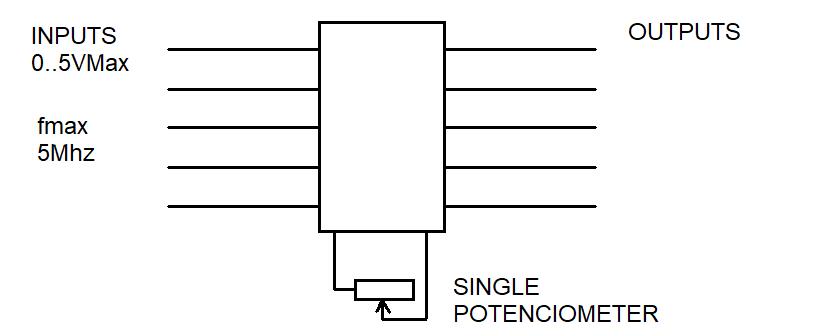

Dear friends.
I want to control the atenuation factor of 5 separate signals with a single potentiometer.
Those signals will vary form 0 to 5Volts max, at a frequency of 10Mhz max.
I thought I will use an operational amplifier in substraction mode, but it will not give me the correct result, because what I really need is a DIVISION.
And a division is made with a voltage divisor, we don't need a op-amp.
Exactly like an AUDIO VOLUME CONTROL, like double potentiometers, here is the same but not double, five-time!
The idea is generate a voltage reference with this pot and use after 5 opeational amplifiers to divide each one of the input signals?

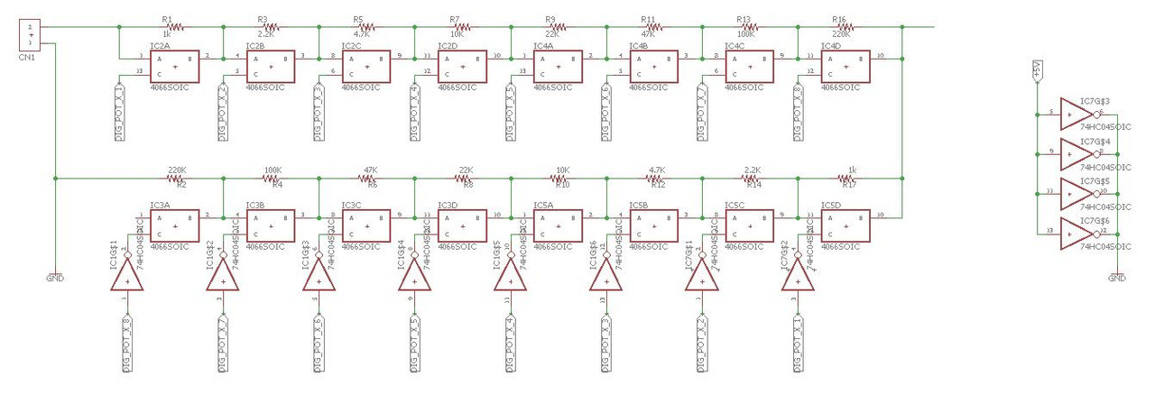

OK. Basically I want to control the level of a RGB Signal. The global luminosity.
I made an error, I don't need 5 wires, only 3 (Vsync and HSync).
Unfortunaly, most of analog video circuits are obsolete, so I want to make a design with sure-value components.
I started this design:
It works! But unfortunately, its TOO much components, repetitive, a big PCB.
Now, i'm going there:
https://www.renesas.com/in/en/www/doc/datasheet/x9c102-103-104-503.pdf
« Last Edit: November 22, 2019, 05:11:00 pm by Axxel »

On that digipot, watch out for the charge pump noise spec. Depending on your video levels you might see some herring-bone effects.
A simple JFET shunt attenuator would be fully analog and tiny, if you don't mind generating a negative supply, but might require hand selection of components to match channels.

Thank you.
The rgb signals are form 0 to 5V, just before attacking the NTSC encoder I will pass by a divisor bridge to get the 0 to 0.7V.
I will buy those chips on moday, these are disponible in the shop. I will try this and let's see what about the noise...
Negative, no. Only from 0V to 5V. JFET shunt attenuator I never built one.
https://www.nutsvolts.com/magazine/article/fet_principles_and_circuits_part_2
This should be a great solution, and as you said, FULL ANALOGIC! I will try this configuration too...
