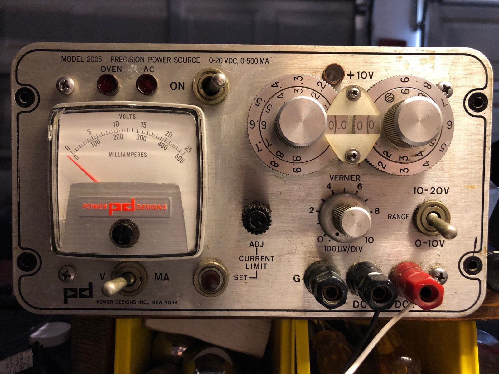

I have a standard power supply with 10mV resolution and max 30V, what I need is a far better resolution.
My first thought was just to put two resistors on the output as a voltage divider, i.e. 1,000:1 but that would also reduce max voltage to 0.03V and that's fare less then the 10V I want and is wary inefficient!!
Is there an other way to increase the resolution by adding some circuit between the PSU and DUT?
You need to state why you need those features - the best answer will vary depending on your requirements.
I rather like my Power Designs 2020 PSU: 0-20V in 1mV steps, plus a pot for tweaking down to 10uV. Low noise too, since the internal reference is an LM399 :)
Good luck finding one, though. I'm not selling mine :)

I am sorry that I have not been clear on why I think a 0.1mV would be great.
I already have a standard Korad 10mV supply and is normally fine for just delivering stable power, but I am becoming wary interested in how components, chips and circuits are behaving under different voltages and 1mV is to big steps, it's almost like the Korad.
tggzzz could you please tell me how you have made your 2020 PSU, sounds like what I need? :-)
Even if I appear online is it not necessary so, my computer is on 24/7 even if I am not on.

Power Designs are a bit of a 'Relic'  ;) If you want serious control then buy a DC voltage Calibrator  >:D
eBay auction: #401701628039
How. Much. Power.? 1uW, 1W, 1MW? There's a big difference between each of those.
https://www.ebay.co.uk/sch/i.html?_nkw=%22Power+Designs%22++precision
Be aware some Power Designs PSUs are 115V only. With the 2020 it is only necessary to change the transformer taps; soldering required.
Manuals, including schematics are available free on the web.
How much does it cost ?? I am thinking of designing one using PIC Microcontroller.

HP made several precision bench power supplies like the Power Design one pictured above starting in the 1960s and a lot of those are still around and working just fine today. They frequently show up on eBay. Here is a picture of my HP 6111A outputting 20.00005 VDC
