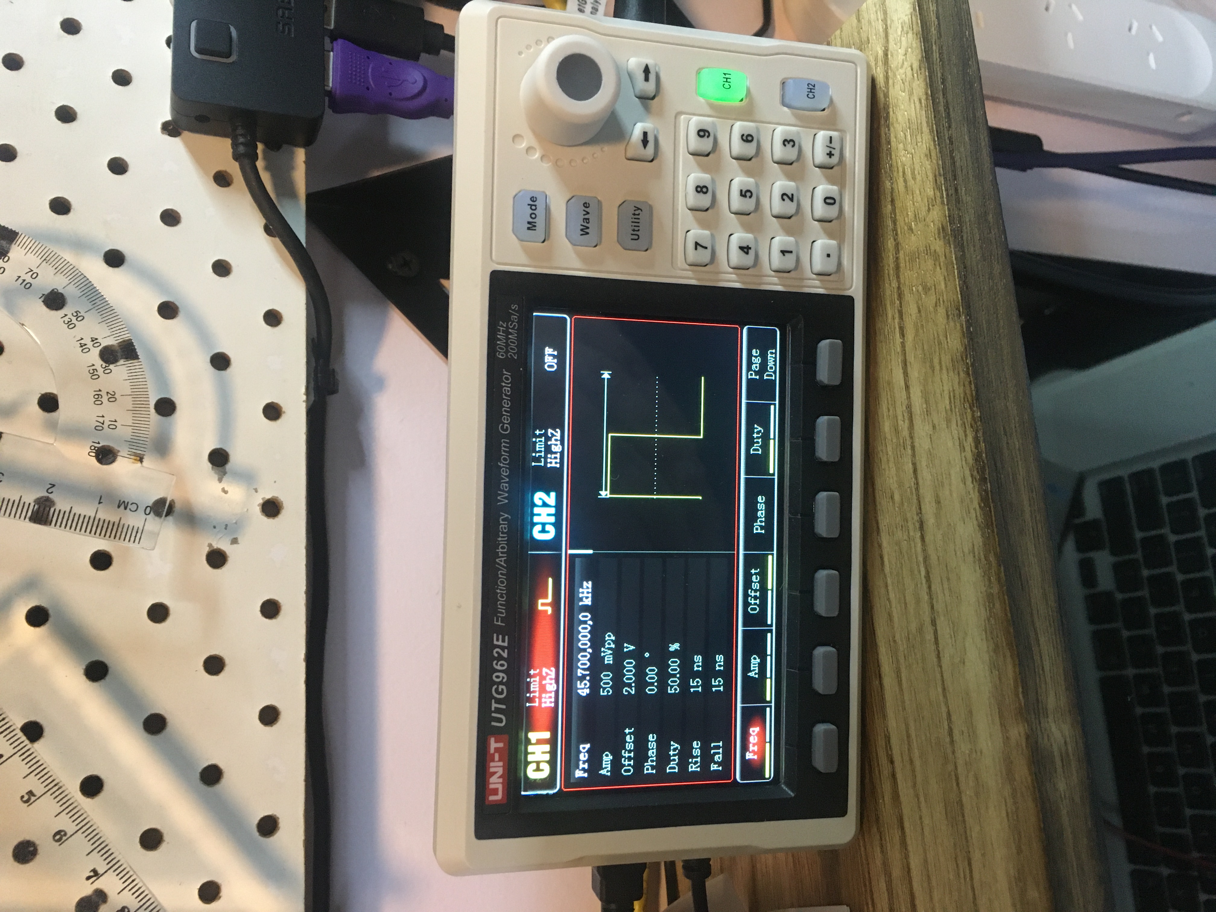

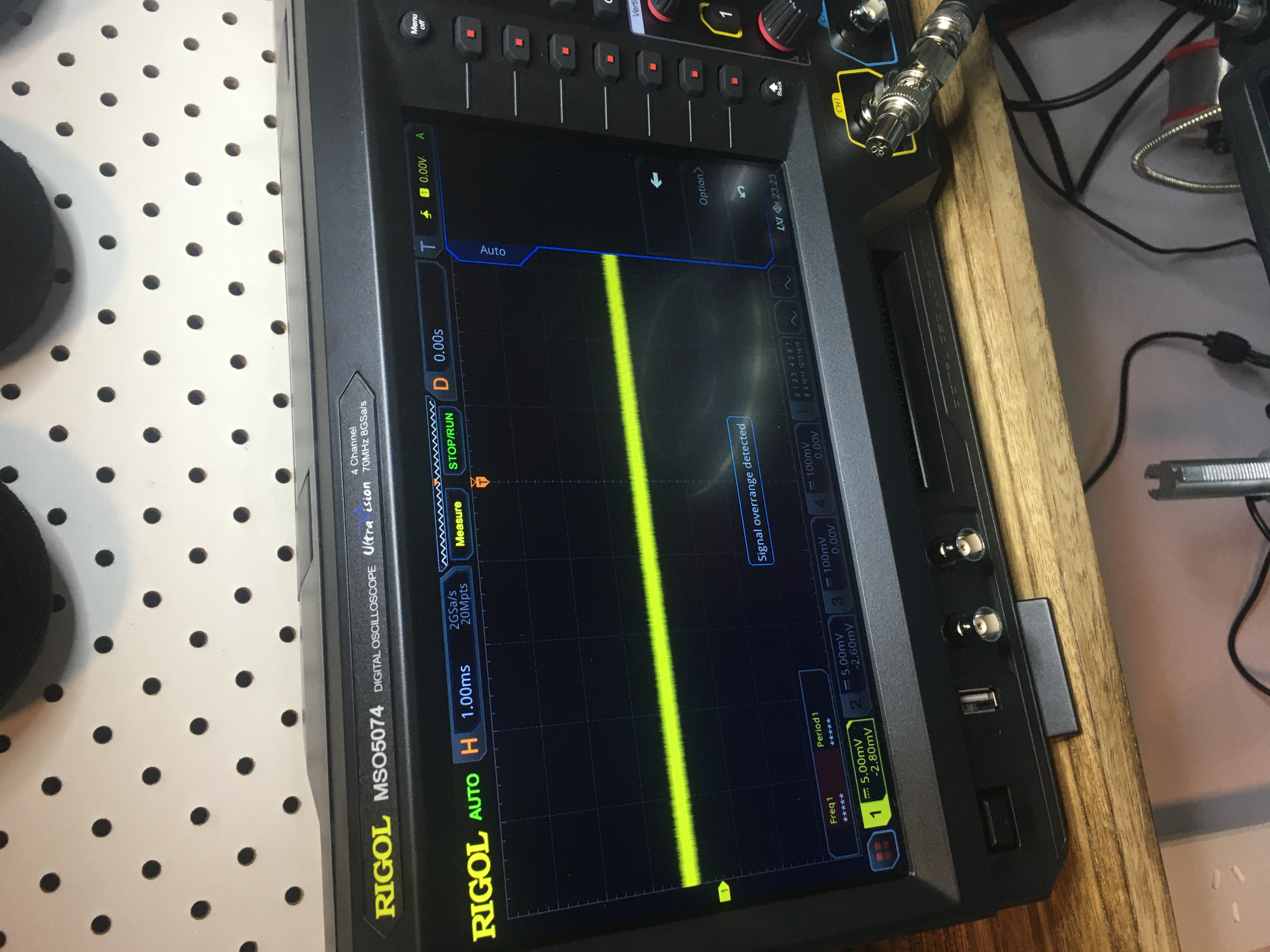

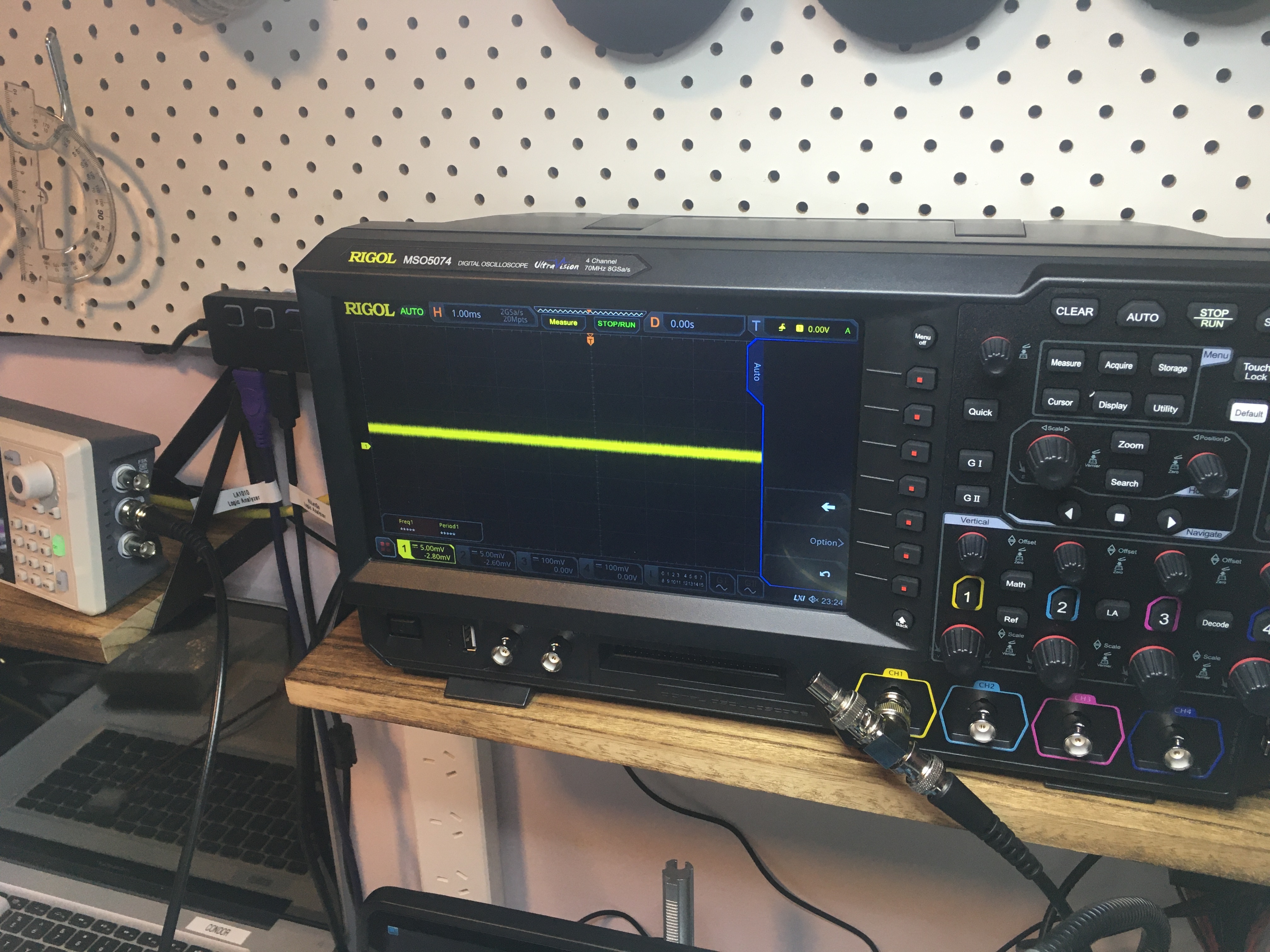

Hi there. I'm new. Recently I purchased a Rigol MSO5074 scope and a UNI-T UTG962E waveform generator.
Today I plugged the channel 1 output from the UTG962E into the channel 1 input of the MSO5074 using a BNC cable and a 50 ohm terminator.
The first time I did that and pressed the 'Auto' button on the Rigol the signal was detected and everything worked great. But then I lost the signal and I have been unable to get it back. Now when I press the 'Auto' button (with the cabling unchanged) I get either 'Signal overrange detected' or 'No auto signal detected' on the scope.
I've tried various configurations for the UTG962E including e.g. this:
What am I doing wrong? I've never used a scope before, but I figured that it would be able to auto detect a simple signal from a waveform generator... no?

1.) Your generator is sett to HighZ in to a 50Ω so your signal is lower than the 500mV-pp you think you have.
2.) You have a +2V offset on the generator.
3.) Try a sinus signal!
Johan-Fredrik.

« Reply #2 on: April 03, 2022, 05:55:00 pm »
Hey Johan-Fredrik, thanks for your notes!
1) So if it's HighZ I don't need the 50 ohm terminator?
2) I put the offset down to zero and it fixed the problem!
3) Yep, a sine wave worked, but so does a square wave now too!
Thanks again.
