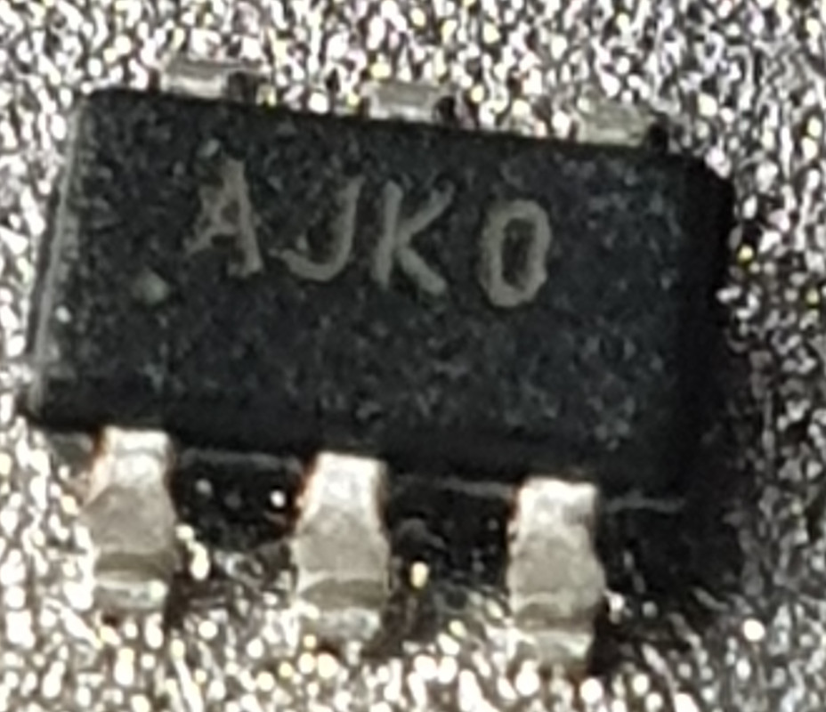

AJK0(or O) SOT23-6. Anyone know what it is? It may be a MCP4725A0T-E/CH
I need to confirm it but I am struggling.

Post a picture of it.
For reference, attached is a picture from someone selling MCP4725A0T.
Offline castingflameTopic starter
  • Posts: 100
Re: What is a AJK0(or O) SOT23-6?
« Reply #2 on: March 13, 2019, 08:28:30 am »
Thank you for your response amyk. Your wish is my command.
Well the codes don't match to what I thought it was. It is not a million miles away though. I believe the last few letters after the forward slash are for package type and in this chip /CH denotes SOT-23.

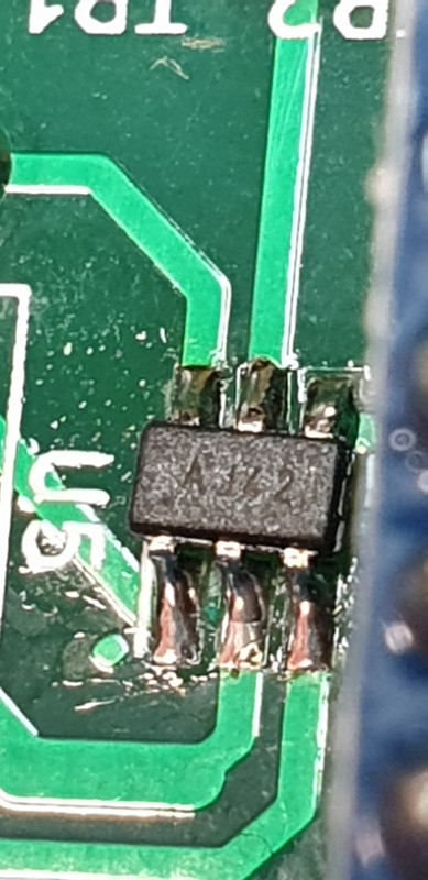

FWIW, another 2 suppliers on AliExpress have these pictures with the MCP4725A0T-E/CH and they are different numbers again...
AJEQ
AJ4A
And one I ordered from Farnell is labeled  AJ42
They ALL have the AJ prefix though.

« Reply #5 on: March 13, 2019, 09:36:49 am »
http://ww1.microchip.com/downloads/en/DeviceDoc/22039d.pdf
The MCP4725A0T-E/CH has a marking code of AJNN, where NN is some sort of variable batch code or date code.
"A0" denotes the address configuration (A2 and A1 both hard set to 0)
T denotes tape and reel packaging
E denotes -40C to +125C temperature rating
CH denotes SOT23-6 package.
Thank you very much for your help. Spot on. :)
