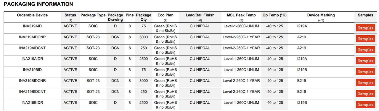

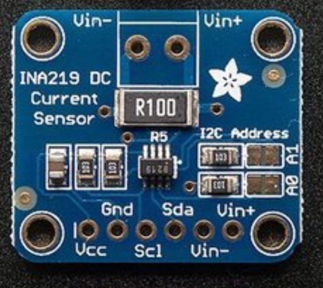

I have been using the INA219 Adafruit (Clone)  Curent/Voltage sensing modules that use the TI INA219 IC. I purchased some SOT23 INA219 chips to include the module design as part of my project PCB. I struggled to get them to work or even seen on the i2c bus. I have noticed that the modules use 219A chips but the ones I got from China were 219B chips. They were just purchased as INA219 ICs.
I have removed the INA219A IC from a working module and replaced it with a INA219B IC but it fails to work.
Looking at the datasheet, I can not see any difference to speak of. I am wondering if they are just defective. I buy a lot of stuff from China and I have only ever had one IC be faulty so I do not want to just assume it is the ICs.
They are in a SOT23 package so not the easiest to work with but I am pretty sure they were soldered correctly. They checked out okay with the meter too. I also mounted some on Breakout boards to breadboard it too but the INA219B failed to be seen on the i2c bus, with and without other devices attached.
Here is the only mention I have found in the datasheet. They are listsed on the right by the IC marking A219 & B219.
Full datasheet http://www.ti.com/lit/ds/symlink/ina219.pdf
I think my next move will have to be to order some INA219As from Digi but I am still a little confused why this does not work.

Online oPossum
  • Posts: 1472
Re: What is the difference between the INA219A and the INA219B
« Reply #1 on: November 10, 2018, 08:06:33 pm »
Page 5
Offset voltage
Note 4

« Reply #2 on: November 10, 2018, 08:26:08 pm »
Thanks for your quick reply oPossum.
I searched the document but for some reason that was not found. That offset voltage difference would not account for not seeing the IC on the i2c bus. I never got to the point of actually measuring anything with it.
I have just looked at the Adafruit Schematic and although my module has a 219A, it is listed on the schematic as a INA219BIDCNT. This maybe because it is a clone, but it is faithful in design.

« Reply #3 on: November 10, 2018, 08:48:40 pm »
The Official Adafruit board does have the 219B (B219) so I am even more confused.

« Reply #6 on: November 10, 2018, 09:19:15 pm »
Just read the documentation  :-DD
The "B" version has better offset specifications!

« Reply #9 on: November 11, 2018, 11:59:01 am »
Just a quick update. I removed the B219 from a working Clone module and mounted it onto a chip carrier breakout board. Using a breadboard with fly-leads to my PCB confirms that it works so the Chinese ICs must be duff. Well out of thousands of parts from China, it is the first faulty  ones I have had. Not bad odds really I guess. When I get to the end of the development of the project I will use all genuine parts for the build from a decent distributors. I can not afford to do that generally though.
