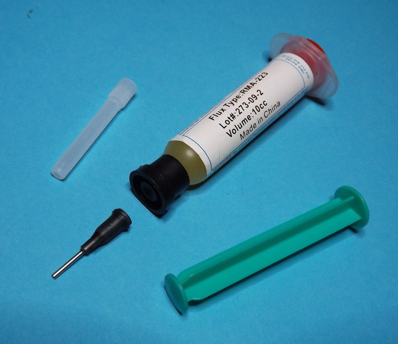

When you buy solder and/or flux paste, it generally comes in a 10/30cc syringe like this:
In their infinite wisdom, (most) manufacturers decided to save a few cents and not include a needle tip, cap for the tip & plunger :wtf:. I'm a bit lost on how to get these syringes into a usable state.
Searching a bit on eBay / AliExpress, I see a lot of options:
https://www.aliexpress.com/wholesale?site=glo&g=y&SearchText=syringe+needle
Getting a needle tip seems to be easy enough, lots of good looking options. But they never seem to come with caps. I of course don't want flux to smear all over my soldering consumables drawer or have my solder paste dry out. I don't see individual plungers on sale much, and it's not clear if they'd actually fit. There seem to be different mechanism to attach them. You can buy complete kits, but transferring a syringe of solder paste seems super messy. Why would they even bother putting it into a syringe if the first thing you have to do is transfer it to another.
Seeing as this decidedly not-ready-to-use packaging the industry standard I'm sure somebody here has solved this issue and can hopefully point me at the right set of affordable Chinese parts to make 10cc / 30cc flux & solder paste syringes actually work. Thanks :)

Pros use motorised or pneumatic syringe drivers, and use up a syringe of paste before it can dry out, and the needle dimensions are application and syringe driver specific (and temperature dependent) so all the extras that are nice for the hobbyist or occasional user would just end up in the bin as soon as the pack was opened, so the volume market wont pay for them.
There was a thread on this a few years back.  Try https://www.eevblog.com/forum/reviews/solder-pasteflux-manual-syringe-applicator/
Affordable + Chinese + working is a low odds combo :(
You can always cap straight needles with a slice of foam plastic wine cork you've bored a fractionally undersized hole in (so the needle doesn't plug itself with compressed foam).  Conical 'needles' are more problematic - try bluetack for short term storage leaving a tiny bit of paste/flux on the tip so it doesn't block it.   Long term, all are best removed, the syringe capped off and if you aren't going to thoroughly clean and flush the needles for dry storage, stored in a small sealed vial with a little IPA in the bottom to keep the flux/paste moist + a disk of plastic with legs folded down to keep them out of the IPA so it doesn't wash the flux out of the paste.

For instance, if you buy flux from MG Chemicals they do the right thing and give you a working tool, a full syringe with a plunger, needle and a cap. That's all I want. These solder paste applicators are complete overkill for me for the few times I need paste and I've never seen them used for flux gel. No need for a bulky contraption to squirt a glob of flux on your PCB. I guess I could poke my syringe into a piece of cork or whatever, but that seems sooooo janky. I want a cap like the one that comes with MG Chemicals flux. I also don't see why any of this would be expensive or should not be sourced from China. We're talking about a few really simple pieces of plastic & metal to complete a syringe (that 99.999% sure been manufactured in China for 5c anyway), that doesn't need to be sourced from some domestic specialty artisanal syringe store.
I want to buy this:
Minus the syringe of vaseline :)

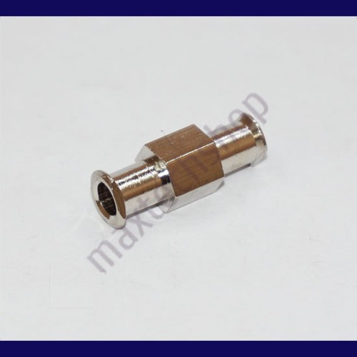

You'll probably also want a strong female-female Luer lock coupler and an appropriate diameter dowel set in a block of wood as you can bet the dispensing syringe kit plunger wont fit the piston of your flux or paste syringe properly so you'll need to transfer product to a working syringe, which will also help with paste shelf life as you wont need to warm up the bulk syringe to use it, so can keep it sealed and refrigerated >99% of the time.
A small diameter (low CC) syringe is *MUCH* easier to dispense from controllably manually without special tools so you may be better off transferring to 1ml or 2.5ml sryinges (size depending on your daily usage) anyway.

You can buy plungers quite inexpensively (you may have to cut the cone bit off to make it flat).  :-+ Lots of sources to find them, such as eBay, Aliexpress, DX, Banggood, ... And as mentioned, Louis sells them in his store as well.  :)
If you have a 3D printer, there's an Injection Plunger for Soldering Flux Syringe project on Thingverse you could reproduce (files are available).  ;D
Another consideration would be a syringe gun (they come in 10 & 30ml sizes).
Here's a 30ml Manual Syringe Gun you'd need for your Amtech flux.  ;)
As per needles, I'd suggest getting an assortment kit to see what you like. Do note that the plastic cone versions are actually easier to get the material to move out of the syringe (particularly with solder paste; flux is easier to push).
Some examples:
As per capping them off, a bit of white plastic pencil eraser does nicely IME.  ;)

Unless things have changed a lot in the last decade or so, I think you'll find that captive plungers are often  not compatible between different brands of syringe as the plunger to piston seal interface isn't well standardised.   The plungerless syringes intended for use with automatic dispensing and compact syringe driver systems will have fairly good standardisation of the plunger/piston interface because compatibility is an obvious requirement, but your wun-hun-lo syringe of vaseline's plunger is quite likely not to fit the plungerless syringe from Amtech or other reputable source's piston well enough.  That leads to the plunger coming loose when the syringe is part used, usually when you pull back on it to stop drool, then when you attempt to re-engage it with the piston, there's a fair chance the piston will capsize, at which point you have a FUBARED mess that you can either trash, or attempt to remove the capsized piston with forceps so you can scrape the product out with a spatula and transfer it to a jar.
 |O  Been there, done that and got the (stains on my) teeshirt!  :popcorn:
Nanofrog's suggestion of cutting the mushroom end off to make it non-captive may work well enough if you are careful and lucky and if you've got a 3D printer that suggestion  looks like its worth a try , but decanting into a smaller syringe isn't really that much hassle and with any common sense is nearly mess free.   The Luer lock coupler holds the two syringes nozzle to nozzle and the dowel in the block of wood sits on your bench so you can easily push the pistonless syringe down on it with one hand till the small syringe is 2/3 full, while your other hand eases back the small syringe plunger. Take it off the dowel and pull a slight vacuum with the small syringe, before disconnecting the coupler, plungerless side first and you'll get minimal mess with only the coupler to clean unless you are decanting ridiculously runny flux
Unless its *very* runny I don't like filling syringes from the back as its very difficult to avoid air bubbles and even a small bubble results in poor control and a tendency to drool when you stop pushing.

Nanofrog's suggestion of cutting the mushroom end off to make it non-captive may work well enough if you are careful...[snip]
FWIW, the cone/mushroom end isn't compatible with the piston seals used for dispensing products IME, so something flat works much better. A razor knife with a fresh blade should do nicely.
I also like the idea of filling smaller syringes, but I'm with you on the air bubbles issue from filling them from the back end. Fortunately there is a Female Luer Lock to Female Luer Lock adapter/coupler, so that should solve the problem. :) BTW, I checked and this seller does ship to Germany if you're interested. :-+
Stainless:
Disposable type:
I'll be buying one of the stainless couplers I linked.  ;D

Also, why are these female-female couplers so expensive? ;-)
The Amtech business strategy: "Let's make our product very hard to buy and then ship it in a container that requires hours of hunting down accessories on AliExpress to actually get something out" |O
I'm beginning to think the best strategy here is to buy a selection of tips, a few syringes and a luer lock coupler. Probably quite OK for the flux but I'm a bit worries about the thicker solder paste.
Regarding the couplers, my guess is that they're not all that common, so no small quantities are available (sold by the case = too expensive for our purposes). And although the stainless steel model is expensive initially (~$9 shipped to you), it's not disposable so you only have to purchase the one. It does require cleaning though (bit of a PITA, but livable IMHO).
