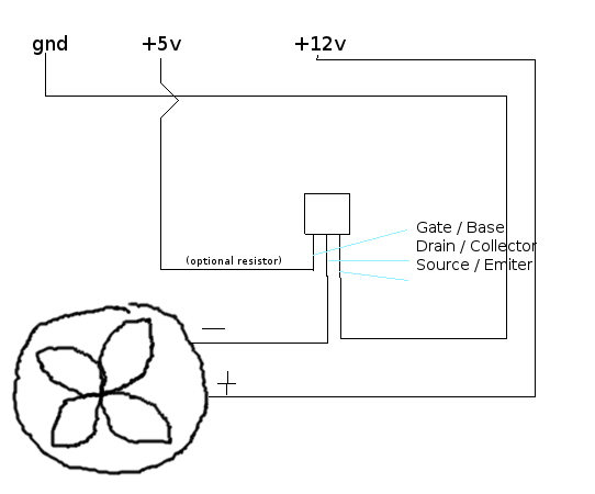

So I was just messing around, wanted to play around with making a basic high enough current PWM to play with transformers and stuff, so I setup a bread board with 12 volts on one side from an ATX PSU and 5 volts on the other side from an arduino (purposely wanted something with a low current rating).  I then put the two grounds together to ensure that the arduino's +5v uses the same ground ref as the ATX.
I then put a mosfet, connected as follows:
Drain to the negative pin of a 12v fan and the + of the fan to the 12v rail.
Source to ground
Gate to +5 volts. The fan barely moved. It needed help to get going. When I tested the voltage output I was getting maybe 4 volts when I should be getting 12, or at least I thought so.
I did the same but with a transistor, fan turned better, but it was still not getting the 12v.  What could I be doing wrong? Or is 5v simply not enough to saturate?  The mosfet I was playing with is a IRF 610.    I'm trying to interpret the datasheet but really not sure where the saturation voltage is.  It might be called something else.

Offline Red SquirrelTopic starter
  • Posts: 2751
I still need to find a decent Linux program for making schematics, so excuse the poor drawing but this is basically what I'm doing:
Adding a resistor on base made it turn even slower, if at all.   The transistor seems to act better than the mosfet.  Using a TU13001 transistor and IRF610 Mosfet (separately, not at same time).  They are both N channel.
Edit: On the scope it's even more weird, if I give the mosfet +5v I get nothing on the scope, if I give it PWM I get a wave, but only 5v, not 12v.  If I disconnect the 12v power I still get the wave. Similar with transistor except the solid +5v also gives 5v out of the collector.   So it's almost like it's just passing through the 5v directly.  I wont rule out that this fet is damaged though, but it's probably me that's doing something wrong.

Online T3sl4co1l
  • Posts: 22386
    • Seven Transistor Labs
If the 12V remains stable, you can simply mentally subtract that from the reading.  If it's an alternating signal, you can use AC coupling (all the interesting stuff happens around the edges, anyway?).  Or you can perform a differential measurement with two probes and using the oscilloscope subtraction function.  But mind that the difference is never perfectly subtracted, and some common mode error will remain, especially at higher frequencies.
Preferred term for a "transistor" is BJT (Bipolar Junction Transistor).  There are two kinds of FETs, so that should be specified as well (JFET vs. MOSFET). :)

Do you have enough current gain in your BJT multiplied by however much current you are putting into the base?
Are you driving the BJT into saturation?  Is the BJT getting warm/hot?
Does your FET turn on when you connect the gate to 12V?
You are not using a "sensitive-gate" or "logic" FET which can be turned on with 5V
So it will take practically the same voltage that you are switching, (i.e. 12V on the gate).
If you want to control a higher voltage with a FET triggered by a lower voltage, you need a logic-level FET
For example:  http://www.allelectronics.com/make-a-store/item/rfd4n06l/rfd4n06l-4a-60v-n-channel-mosfet/1.html
The RFD4N06L, RFD4N06LSM are N-Channel enhancement mode silicon gate power field effect transistors specifically designed for use with logic level (5 volt) driving sources...
http://pdf.datasheetcatalog.com/datasheets/50/346688_DS.pdf

I'm not sure what you mean by the first sentence, can you explain?
In the first paragraph I was talking about BJT as I mentioned.
Being a current device, a BJT conducts (from the collector down through the emitter to ground) the amount of current determined by the base current you injecting, multiplied by the current gain of the transistor.  BJT transistors have a specified current gain depending on which type of device they are and some process variation. If you look at the published specifications for a particular BJT part number, you will see a range of values.  For example a 2N2222 can have a current gain (hFE) between 30x and 300x.
The input (base) current can be calculated from the voltage and the base resistor using Ohm's Law.  I have an online Ohm's Law calculator here:  http://www.rcrowley.com/eirp.htm
Are you saying maybe I need a higher source of current and I'm not giving it enough?    I believe I am driving it to saturation but maybe that is actually my issue.  I notice I get more power if I connect base to 12v instead of 5v.
Are you talking about BJT or FET?
If you are talking about BJT, then if you get more power from raising the base voltage, then you are NOT driving the transistor into saturation.  Saturation means that the base current times the current gain is MUCH MORE than the amount of current you are switching.
The FET, as mentioned is probably just not meant for what I'm trying to do, though. Though even at 12v it will barely, if at all, move the fan. I'm also starting to think the fet may be damaged from when I pulled it out with a heat gun, I may have given it too much heat.  Even with the gate disconnected it still passes voltage that I can read with the multimeter, but it's not enough to actually do any work, even at 25 volts it wont drive the fan.
Measuring it with no-load (the multimeter) isn't a reliable test.  But your test under load DOES make it sound like your FET may be faulty.
The transistor will though, and does get pretty warm even with a base resistor, but maybe it's not a high enough value.
If the transistor is getting warm, it means that it is dissipating part of the power rather than conducting it. That is a clear indication that you are NOT driving it into saturation.  (And that is WHY we drive it into saturation.)
This one I'm using is 100 ohm.  If I use any higher value then the fan barely turns.
You have so many unknowns here, the value of the resistor is a minor issue at this point.
What BJT transistor are you using?  What is it's current gain?

The transistor is a TU13003.  Could not find a datasheet but was told it's probably a MJE13003-E which I found a datasheet for.  I figured ordering through a retailer like Amazon I would have gotten a better documented part, but for a real project I'd probably order from Digikey so I know 100% that the datasheet I have is what goes with what I'm buying.
This is the datasheet I'm looking at, but not sure if it's actually the right one as several different ones come up when I search for MJE13003-E:
http://html.alldatasheet.com/html-pdf/173514/UTC/MJE13001/55/1/MJE13001.html
Saturation voltage seems to be 0.5v.  There's lot of different numbers for current gain, not too sure what I'm looking at.  Also how does one know what all the symbols mean in datasheets?  Had you not told me what hfe is I would have no idea.
So the transistor will only pass a certain current based on the current going through the base, is that correct?  If so how do you force more current to go through?   I always figured as long as you reach the saturation voltage it will basically act as a switch and turn on and that it would draw a very tiny current only through the base.  Do you have a good tutorial or reading on transistors?  All the tutorials I've found never talk about this they only say it's like a switch.
Though I'm thinking maybe this transistor is just not up to the task for what I'm trying to drive with it.  It will drive a relay fine.  So maybe it's just the thing of me trying to make it drive something past it's current rating.  The fan is rated at 0.38a.  Not sure which number I'm suppose to look at in the datasheet but they're all higher than that though for maximum current ratings.  Come to think of it, is there a good tutorial somewhere on how to interpret datasheets, is it fairly standard across all components?

I just ordered one of those testers actually.  The fan is rated at only 0.38 amps.  For some reason I could not get an actual current reading out of it when I was testing it out with a normal circuit, my DMM might be faulty, it's just a cheap Canadian Tire one and it's quite possible I blew the fuse or something at some point I'll have to check.  I want to eventually get myself a few more DMM's and at least one really good one like a fluke.
I ripped out some more mosfets (rfp50n06) from that same UPS, I knew these would be better as they were actual driving mosfets with a big heat sink, while the other one was a lone one without a heat sink, so it was probably being used for some kind of control and not driving circuitry.
This mosfet is driving the fan quite nicely, and will even cause sparks when I touch the wires together (can you blow a mosfet like that or will they self current limit and be fine provided decent heat sinking?), there's some real current going on now.  I was running into an odd issue where at random it would remain on, but through some quick researched I realize you should put a 10k resistor between gate and ground.  Guess it makes sense, since a very tiny amount of stray voltage will keep it on.
 So I'm getting progress here, and guess my issues were related to bad/improper components after all.  I got 3 of these same mosfets off the same UPS and a nice big heat sink too so I might keep these for if I want to build a little project SMPS, mostly just for learning.  When I was giving it a 50% duty cycle PWM I was getting interesting noise and spikes but that could be a lot of things like the breadboard and lack of any inductors or other cleaning circuitry. It's a start though. Still have tons of reading on SMPS before I do anything serious.  So much math though, that's the part I'll find hard I think but I'm eager to learn, and sometimes I find it easier to just improvise and dive in then figure out why stuff is not working from there.

Kind of figured considering how hot it was getting when I was quickly shorting it, just thought I'd check.  I know some more purpose built ones I read data sheets for can current limit but they are more complicated than just 1 transistor and most likely have special circuitry for that.
But yeah I seem to have things under control now.  Turned it the first mosfet was either bad or just inadequate.
