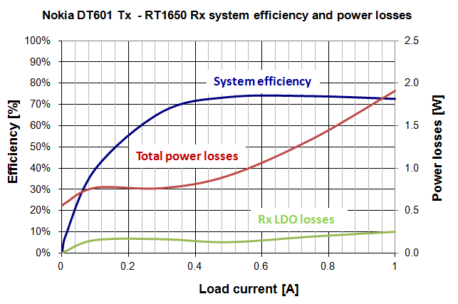

« Reply #295 on: April 20, 2019, 06:27:44 pm »
Here are results from Richtek. A company that makes wireless power receivers. I'm sure you've heard of them.
Application Note: https://www.richtek.com/Design%20Support/Technical%20Document/~/media/AN%20PDF/AN036_EN.ashx
« Last Edit: April 20, 2019, 06:33:52 pm by timelessbeing »

« Reply #296 on: April 20, 2019, 08:00:54 pm »
You measure things under absolutely ideal lab conditions that nobody will ever have.  All manufacturers do it in every category because it sells more product. You did not know this?
Every buyer of the chip is looking for measurements in ideal lab conditions of just thing alone. Engineers of the customer usually have option to get evaluation board to verity performance and see that datasheet figures are not as you say "stretched". If needed - they can get help from Field Application Engineer (FAE) remotely or on-site. You did not know this?
Yes, 80% is just wireless transfer efficiency. Remaining "real world" parts of phone charger are not ideal as well, but hey, their efficiency is not 80% which would result in overall 64% (80% from 80%). Modern power converters are at least 90% efficient. So I would say that 70% could be "real world" number that we can agree on.
« Last Edit: April 20, 2019, 09:18:40 pm by ogden »

« Reply #297 on: April 20, 2019, 08:38:56 pm »
I should agree because you picked a number out of thin air?
I believe Mehdi's 62% because that is the only impartial test with everyday devices (they look modern enough) that I have ever seen. I welcome anybody else who wants to try.

« Reply #299 on: April 20, 2019, 09:17:05 pm »
Don't worry, you don't have to agree about anything. Consider I pulled numbers from Richtek paper.
