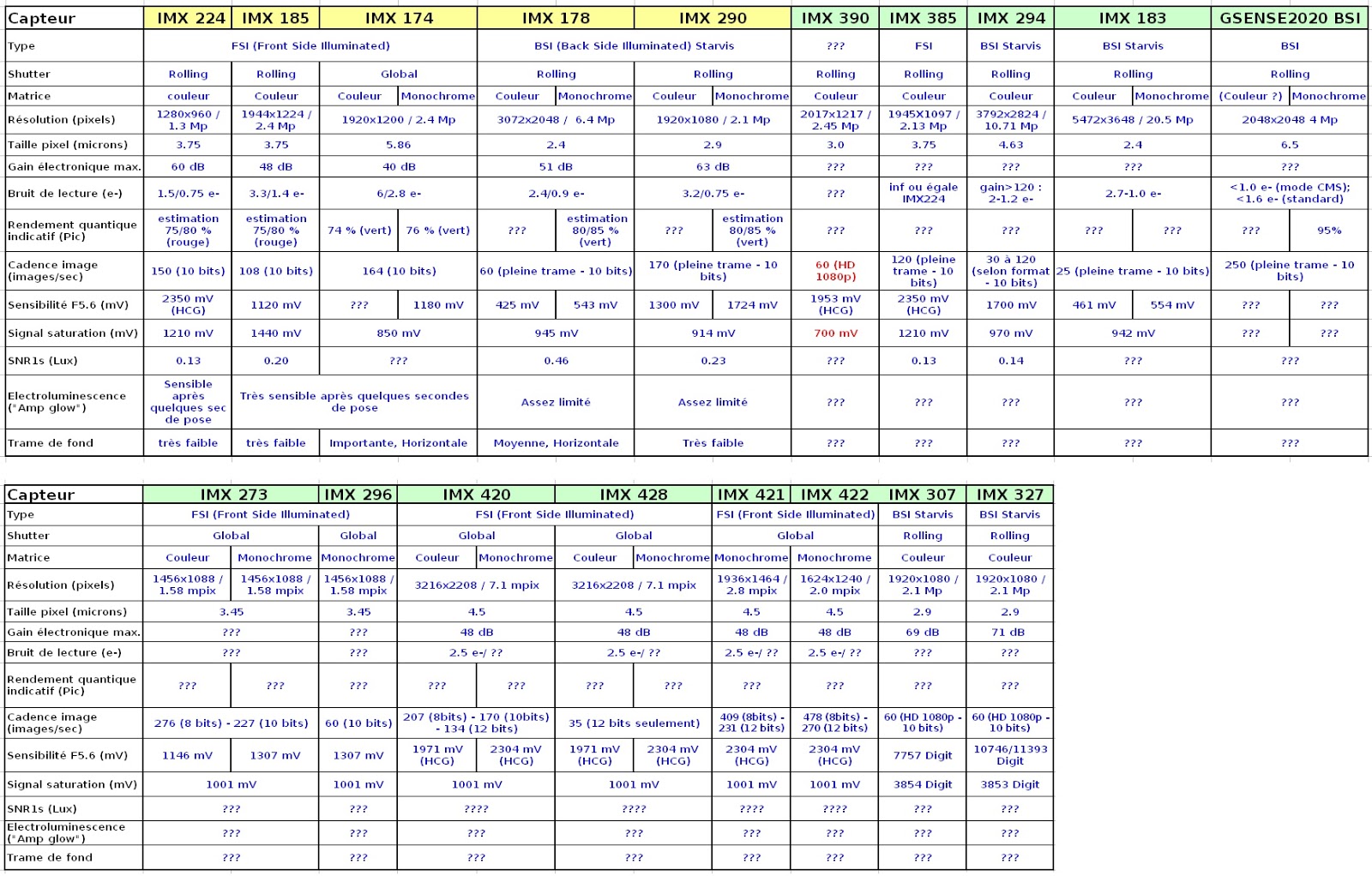

Someone knows if there is something similar but with an IMX385.
I had tested the IMX290 before, and it work great, but the IMX385 is even better.

Check this table to compare:
My English can be pretty bad, so suggestions are welcome. ;)
