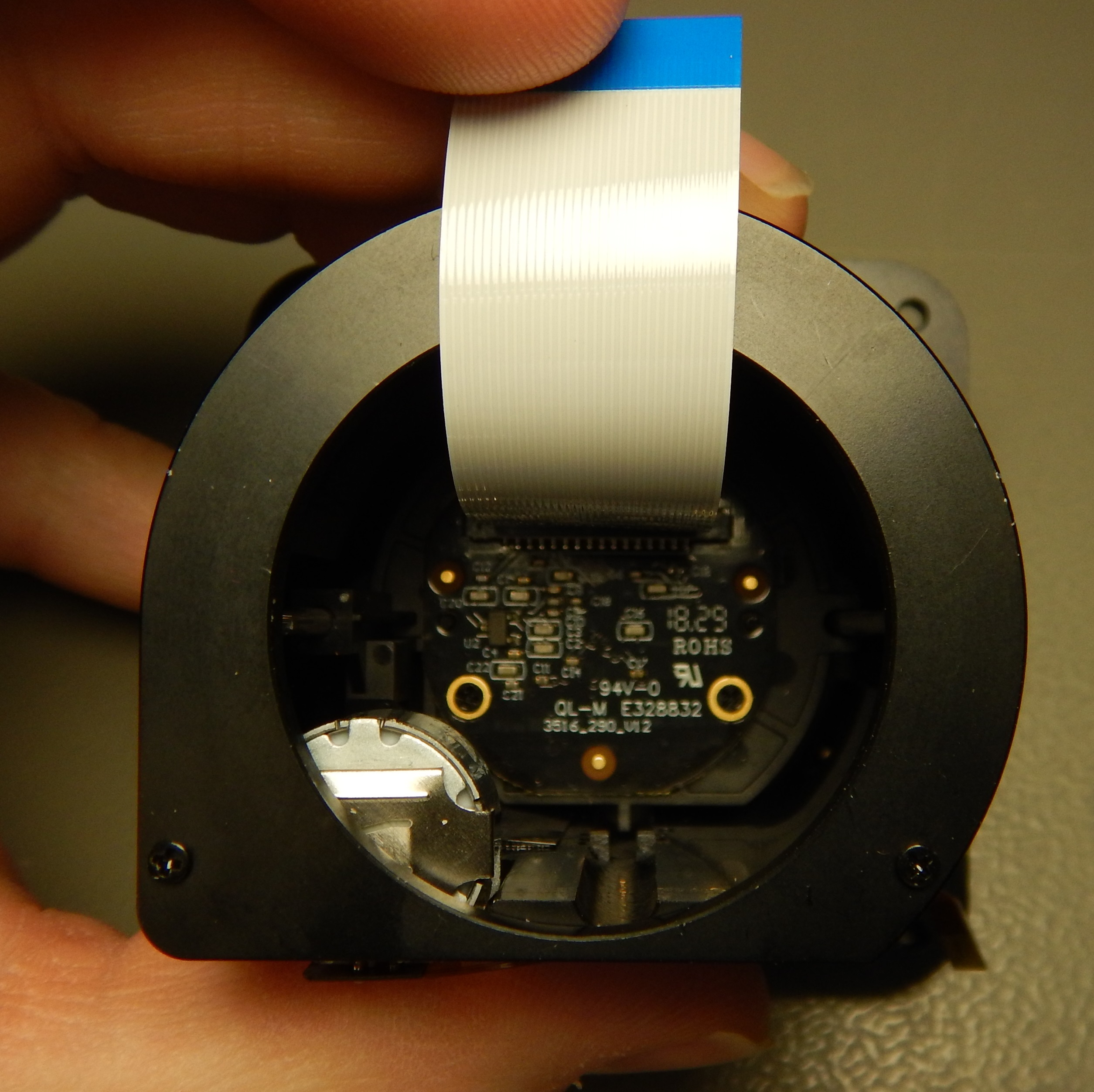

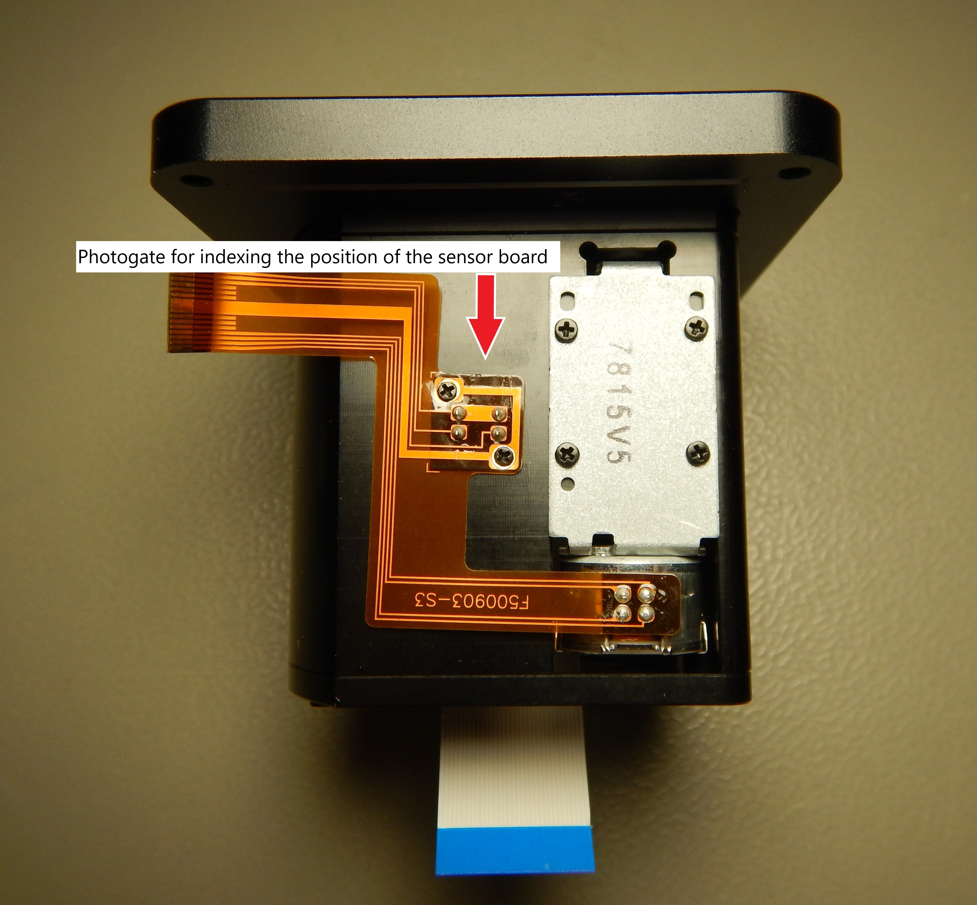

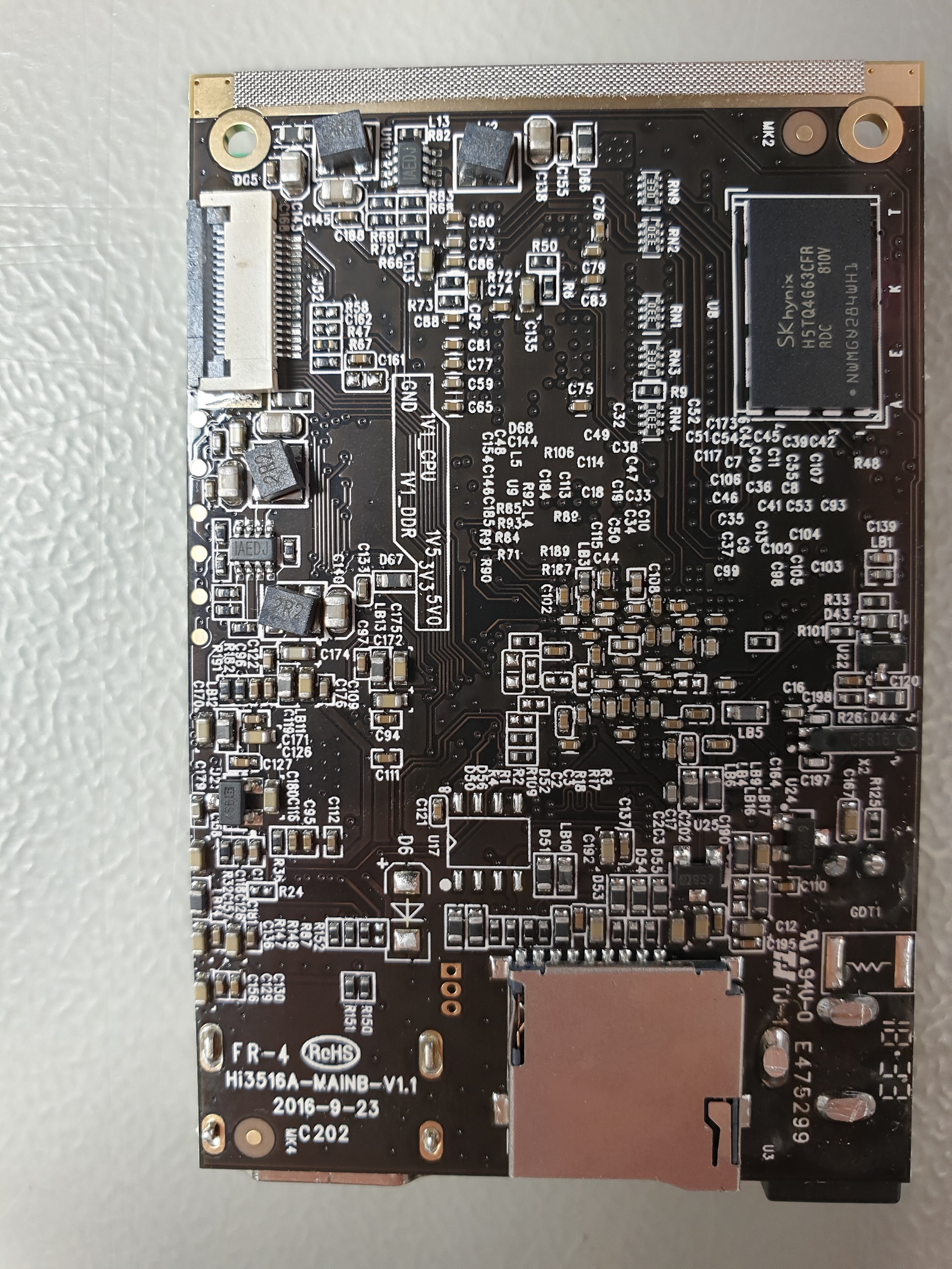

I've received mine just yesterday and I am very satisfied with it.
I threw out the metal base plate and mounted the vertical column directly to my bench. The camera is a lot more stable this way.
I managed to play the video files with VLC no problem. The camera takes a FAT32 (must be FAT32) formatted 64GB micro SD card without a problem.
I am trying to figure out a way to get more out of the firmware. It must be linux based. The mainboard is based on the Hi3516A SoC made by HiSilicon (Datasheet: http://www.hisilicon.com/-/media/Hisilicon/pdf/Surveillance_mobilecam/Hi3516AV100.pdf)
This chipset was originally designed for IP-Surveillance cameras and seems to be quite powerfull.
There is a set of three pins names J50 that are not populated, maybe they are some kind of debug output or even a linux console. I'll probe them later.
The HDMI transmitter is a SII9022ACNU made by Lattice (Datasheet: https://datasheet.ciiva.com/26836/getdatasheetpartid-368235-26836796.pdf)
I've attached a couple of photos of my setup, the main PCB and a few sample shots to this post.
Images:
Main PCB
Top: https://s3.eu-central-1.amazonaws.com/cdn.hog-duske.com/manual/microscope-camera-2018-10/images/board-main_top.jpg
Bottom: https://s3.eu-central-1.amazonaws.com/cdn.hog-duske.com/manual/microscope-camera-2018-10/images/board-main_bottom.jpg
Motor and sensor assembly
Whole assembly: https://s3.eu-central-1.amazonaws.com/cdn.hog-duske.com/manual/microscope-camera-2018-10/images/assembly-motor_sensor.JPG
Sensor board inside the assembly: https://s3.eu-central-1.amazonaws.com/cdn.hog-duske.com/manual/microscope-camera-2018-10/images/board-sensor.JPG
My setup
Full setup: https://s3.eu-central-1.amazonaws.com/cdn.hog-duske.com/manual/microscope-camera-2018-10/images/setup-full.JPG
Mounting arm: https://s3.eu-central-1.amazonaws.com/cdn.hog-duske.com/manual/microscope-camera-2018-10/images/setup-mounting_arm.JPG
Sample images
Lowest magnification: https://s3.eu-central-1.amazonaws.com/cdn.hog-duske.com/manual/microscope-camera-2018-10/images/samples-lowest_mag.jpg
Highest magnification: https://s3.eu-central-1.amazonaws.com/cdn.hog-duske.com/manual/microscope-camera-2018-10/images/samples-highest_mag.jpg
The samples were captured directly on to the SD card using the camera. Working distance was about 100mm.

Thanks!
Wonder what that unpopulated FFC connector is for - LCD?
Day Job: Mostly LEDs
Offline Finbarry
  • Posts: 6
    • Website of my IT Company
Re: EEVblog #1125 - Amazing $500 Soldering/Inspection Microscope!
« Reply #72 on: October 12, 2018, 02:52:48 pm »
Thanks!
Sure, no big deal.
It could well be an LCD connector.
It might also be an alternative connector for the sensor when using a different enclosure.
Just find a serial port, J50 maybe. I have the original Hisilicon SDK somewhere.
Edited to clarify some things:
Even though is easy to find new SDK versions on the Internet, additional drivers will be needed to get something functional.
For example, to my knowledge, even the latest versions come without a driver for the IMX290/291.
I'll check J50 after the weekend when I'm back in my workshop.
I will post an update about my findings then.

I've finally had the time to probe around J50.
It is indeed a serial port, running at 3.3V and a baudrate of 115200.
Now comes the best part....
The serial port leads into a ROOT linux console. No password needed.
I'll try to dump the files by using a flash drive. Stay tuned.
Below is the bootloader output and the response when running "whoami":
I've also attached the pinout of the connector.

Since that boot lists the SoC, here's the short form datasheet.
From a press release:
Hisilicon released Hi3516A SoC (System on Chip) which is based on latest H.265/HEVC standard for high definition IP cameras. The Hi3516A adopted Hisilicon H.265/HEVC algorithm, greatly improved image quality to eliminate motion blur, meanwhile reduced 50% bit-rate without compromising the image quality.
Furthermore, Hi3516A utilizes ARM Cortex-A architect, integrated with Hisilicon's 2nd generation intelligent video analysis unit (IVE2.0) to support license plate recognition, perimeter protection, facial recognition, zone alarm...etc more than 40 different kinds of smart video analysis applications.
Through multi-frame combination WDR and Hisilicon's third generation 3D noise reduction technology, although security cameras work in challenge-able lighting condition, it can still provide excellent images. Hi3516A support up to 5 megapixel real time video encoding, utilizing Hisilicon's advanced network transmission technology, the video latency can be achieved below 100ms.

I'm intrigued - did you ever dump the flash?

I connected to the serial console, and managed to copy what appears to be the main program, and a couple other files also in the /opt/ directory.  If anyone knows a good method to dump the entire flash, I will gladly do so and post any findings here.
I'm working on setting up a USB->ethernet dongle, so I can connect with SSH.
Can anyone find a full datasheet for the Hi3516A processor?  It looks like there's ethernet onboard.

Sorry, I didn't remember to take pictures of the setup.  I'll try Monday.
More research reveals two things: the Hi3516A processor requires an extra chip for ethernet, and the filesystem is currently not persistent.  There must be some special way to write to the flash, and I'm guessing the entire filesystem as presented is actually in RAM.

Just got one of these CMOS Microscope Cameras is its normal for them to make a very noisy  slow grinding/whirling noise from the auto focus motor ?
Had no luck looking for a teardown online on this see what motor these use just in case it needed sourcing/replacing if was to die completely

My Eakins microscope broke 2 times - first they have replaced the PCB for free - second time we had a closer look ourself. The memory chip wasn't soldered properly (so watch out if you get or start to get glitches on the hdmi screen).
The first PCB shows up the same symptoms, I also tried to resolder some chips but didn't touch the BGA memory chip back then... so this might be a common issue.
Now I have a question about the power consumption, my microscope needs around ~5W can anyone confirm that? (no USB or SD Card attached).
