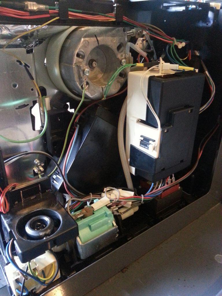

Welcome to part of my world. Repairing Coffee machines is a glorified cleaners job (@ $80-110+ /hr  ;D ) then techie mechanical failures with pumps, valves and solenoids then electronics very occasionally as they are the reliable bit.
A lot of the fully autos are supplied 'free' as part of a coffee supply contract to offices (at inflated prices) never maintained and then get written off rather than being repaired. Good dough if you find a sucker company to take a contract for X years. This plus the lack of mechanical parts availability makes them a PITA to repair. So AVOID at all costs.
Nuts and bolts of the machine you have is water heated by thermoblock one side is a hot water outlet the other is steam for the milk. Hot Water (should be circa 92 degrees) is forced by the pump to the top of the puck which is created by the plastic section you had in your hand. The beans are ground into that mech and compressed by the wormdrive on it into a solid puck then the water forced through it (should be 9bar but it won't be). The puck is then dumped by that mech into the bin. The Limit switches and mech are to adjust the grind from fine to course by raising or lowering the grinder burrs.
As to what they produce in the cup it is not coffee even when well tuned :P
edit anyone wants one ( I currently have 3) $50 + freight (for suckers only) or after I have stripped them their bones are off to the tip where they belong

This type of machine would be called "super-automated" by the industry, because it requires no operator intervention beyond adding the beans and water and pushing a button. Most espresso machines require much more handling, even those classed as automatics.
The handle in which the grounds are placed in an espresso machine is called a portafilter. The grounds are dispensed in a "dose" from the grinding machine, tamped in with a tool, and the portafilter is then attached to the "group head" of the espresso machine, which supplies hot water under pressure. It's the pressurized water forcing its way around the fine ground particles that extracts the coffee in the manner of espresso, which is less bitter and more aromatic than other forms of extraction. Just how much pressure, temperature, and volume of water is dispensed changes the quality of the drink, and it's control of those factors that gave rise to the "manual, semi-auto, and automatic" machine classes.

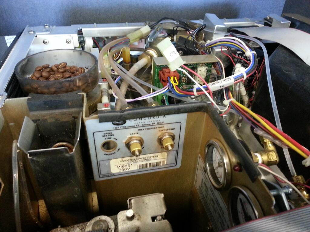

Online beanflying
  • Posts: 5519
Re: EEVblog #1161- Automated Coffee Machine Dumpster Teardown
« Reply #4 on: December 19, 2018, 08:38:20 am »
Super Auto would generally not have a separate steam wand as frothing of the milk is volume controlled via a venturi or second pump and dumped straight into the cup after the shot with no need to have a separate jug. Their kwality of these in the cup is even worse, Muckdonalds finally got the message and removed their big ones from service a few years ago.
The shots here are from a Super Auto. Fridge is under the adjustments for Latte and Crapuchino controls in Photo 1. Photo 2 is of the Pump section. Circa $10k when new. Replaced by an $8k one which was 'just drinkable'
What Dave puilled down would be a Semi Automatic.
« Last Edit: December 19, 2018, 08:47:12 am by beanflying »

Was painful to watch! I have owned and repaired my super-automatic for years. The brew group is the real money shot of the machine. The controller and such is normally reliable and care free. That machine was not cheap. I bet they sell new for in excess of $1500 seeing how the internals looked. The did not skimp on some of the plumbing pieces and heater block connections. Impressive and Dave could have made some real money if he had refurbished and resold it. Just cleaning it and re-lubricating the o-rings is often enough.
This one pumps water only. The thermo-block is in two sections. One for hot water and the other to produce steam if using the front wand. The wand puts out steam. A missing reservoir for the milk hooks to the wand so it can mix milk with steam and produce latte's. Cleaning that milk reservoir and the plumbing is a PIA if you only use it once in a while.
