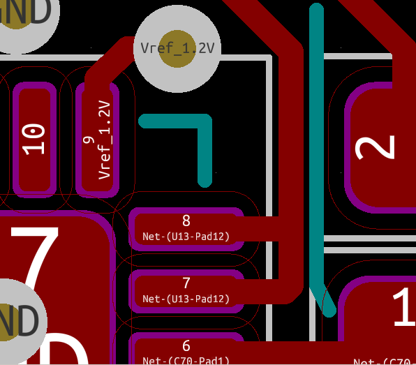

The board house themselves (not the designer) most likely eliminated the mask between the pads in order to eliminate the narrow mask SLIVERS (not slithers).  You can tell by the straight mask edges.
If it was the board designer, there would likely be a scalloped mask edge.
Only the more expensive board houses actually notify their customers when the gerbers are changed.  It's not uncommon at all for gerbers to be 'tweaked'.
Dave, please at least do at least a little video editing.  I and many others enjoy the vids but can't justify spending 23minutes on 1minute worth of content.
For example, the following took two minutes to write and one minute to read:
     Some people thought this was a solder short.  It's actually a solder covered trace.  I can tell that because the trace is in the middle of the pads, where the design software would snap to.
     Ideally you want mask between the pads, but in this case the pads are too close for the PCB manufacturer's capabilities.  Some people might be surprised by PCB manufacturer's actual capabilities regarding mask expansions and slivers.  Lets look at JLCPCBs:
     Traces between pads like this are not good because visual inspection might waste time when they assume it's a short.

Please, guys, take the habit to do it properly.
That saves grey hair for manufacturing people.
An example how to do it correctly :
« Last Edit: December 14, 2020, 09:49:17 pm by f4eru »
The following users thanked this post: free_electron
Offline free_electron
  • Posts: 8550
    • SiliconValleyGarage
Re: EEVblog #1353 - WHY Are These Pins Shorted?
« Reply #11 on: December 17, 2020, 08:14:38 pm »
close ,, your via entry is acute. teardrop it
