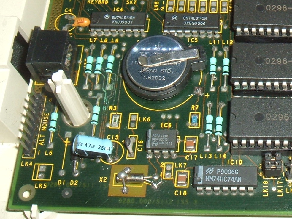

Offline davec
  • Posts: 15
    • Tynemouth Software Blog
Re: EEVblog #507 - The First ARM Computer - Acorn Archimedes A3000
« Reply #45 on: August 31, 2013, 07:56:45 pm »
It looks like that battery is the achilles heel of the Archimedes. There is this one going on Ebay UK at the moment, and this is what the battery looks like:
Yeah... Definitely heading in the same direction as Dave's.
These come up quite regularly on Ebay, so I'm not really sure it is worth repairing. Other than the battery issue though, it looks pretty well engineered.
Actually, that one wasn't as bad as the one Dave got.
After a cleanup with vinegar solution and replacing a capacitor, a crystal, one track and adding a CR2032 and a diode, the one shown above is back up and running fine.
I had been watching this and a few others, I was specifically after a dead one as I was planning to 'upgrade' it with a Raspberry Pi, also running RISC OS on an ARM, like the original.
I suppose it's my own fault for fixing it, can't help it, it's force of habit.
Full details on my blog: http://blog.tynemouthsoftware.co.uk/2013/08/acorn-archimedes-a3000-repair.html.

« Reply #46 on: September 05, 2013, 09:00:46 pm »
Its not just the roms, IC6 (PCF 8583P) is the I2C connected eeprom/RTC device. Without that working as well the machine either won't boot or fail to keep its settings.
The 1772 IC is the floppy disc controller, oh and the machine originally came with RISC OS 2, which users/technicians upgraded by replacing all 4 chips.

I don't think the problem is with corroded roms only. It should output some video signal even without ram, rom and cpu. So, first step would be to make it to generate video, and only then to fix the roms
