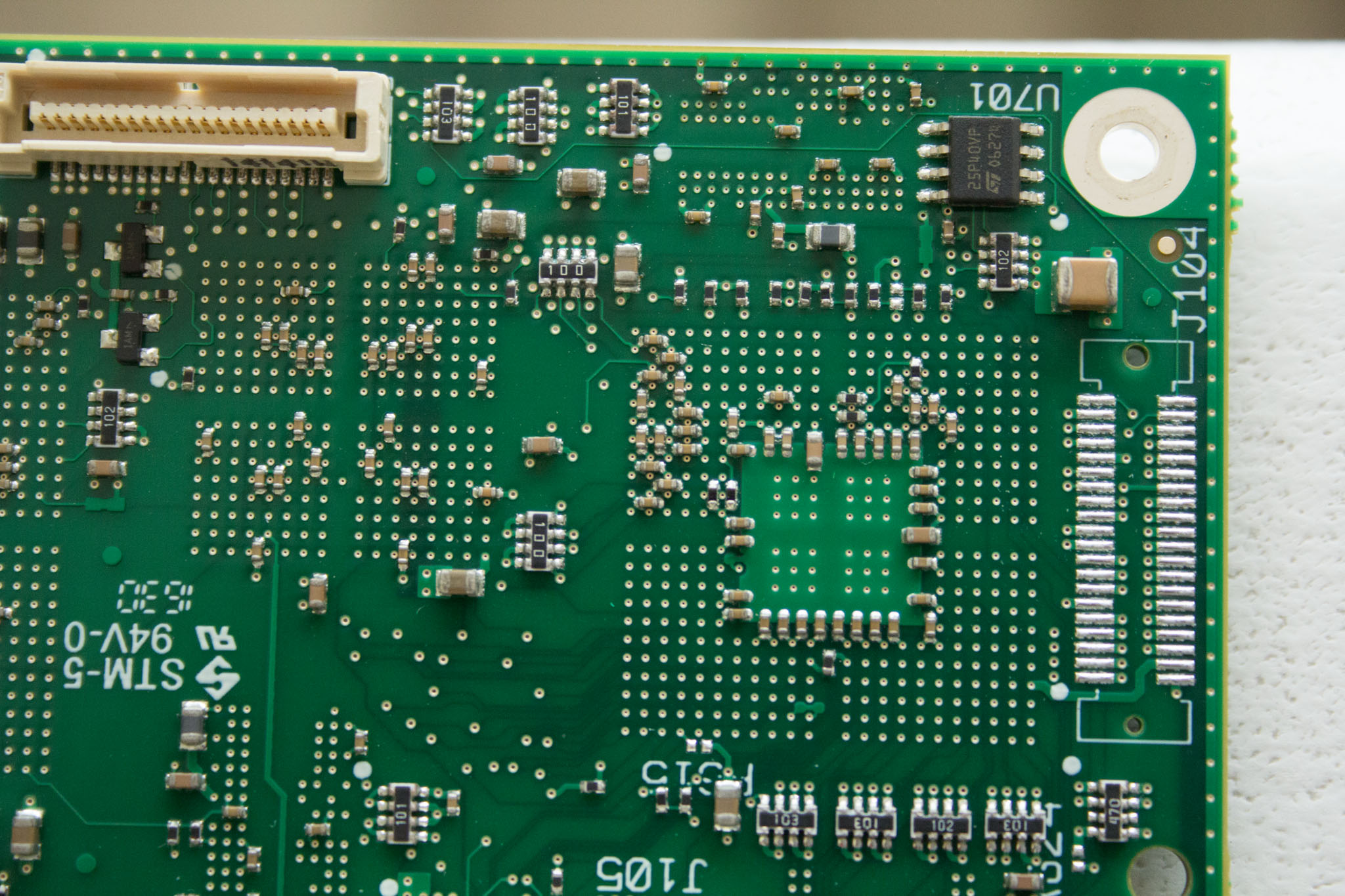

Offline brumster
  • Posts: 10
Re: EEVblog #978 - Keysight 1000X Hacking
« Reply #238 on: March 17, 2017, 10:56:38 am »
Sorry, apologies! Leave it with me ;)
EDIT: Ok, yep, they're on there in same positions.... link and link.
Different values to the ones in Dave's video, obviously. The top 2 are 12k, the bottom two are 4.64K on mine, whereas the 100MHz factory one in Dave's video had 10K/12K on top row, and 10K/4.64K on bottom, I think. I'm not up on SMD resistor codes so I used an online calculator :)
EDIT2: Just working those out, it all rings true, if you work out those voltage dividers then that gives a product config setting of 22 on the EDU model, as opposed to 24 on the reviewed model. The left-hand pair of resistors are config 0 divider, the right hand ones are config 1.
« Last Edit: March 17, 2017, 12:39:49 pm by brumster »

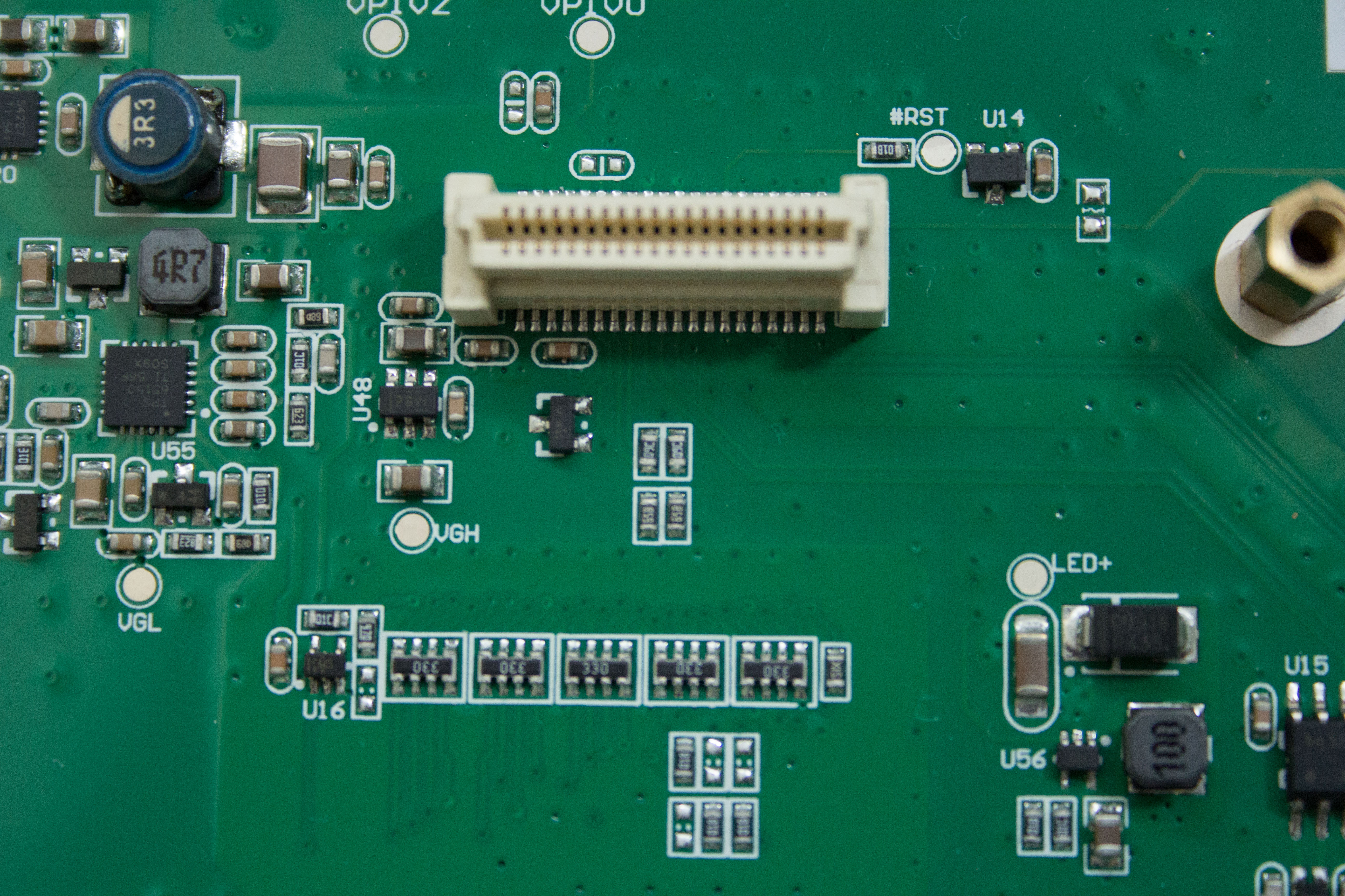

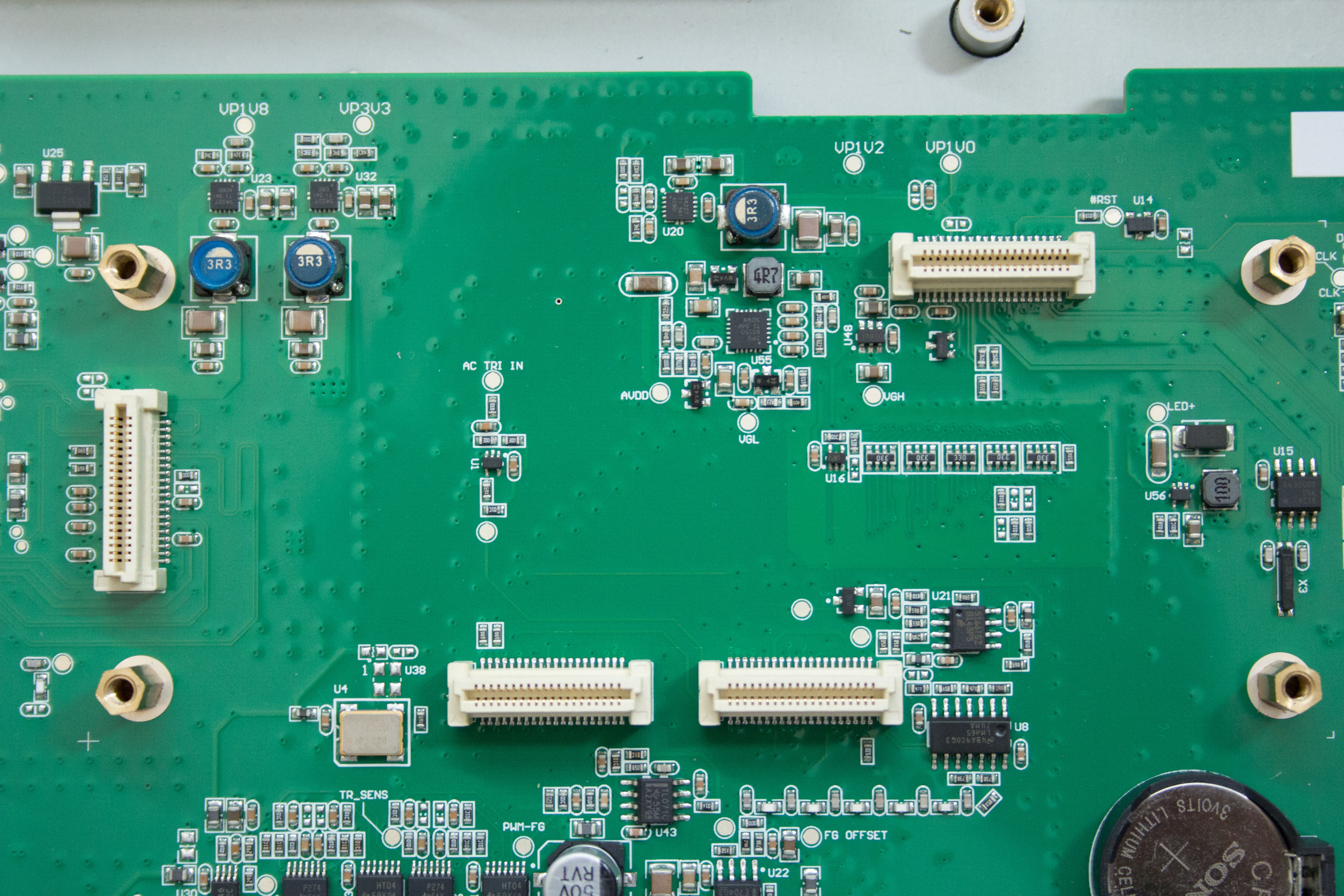

Offline TK
  • Posts: 1722
« Reply #239 on: March 17, 2017, 12:29:39 pm »
I wouldn't expect any HW difference between DSOX and EDUX as all differences are in options.
I noticed some differences in some components between the EDU and DSO models.  EDU has missing components on the EXT TRIG input section (missing RELAY, Analog comparator with resistors and caps) and EDU has additional components on both input sections compared to the DSO model.
Changing the ID from 22 (default ID for EDUX1002G) to 24 (default ID for DSOX1102G) activates Segmented Memory, Additional Trigger modes, BW to 70MHz, 2GSa/s and most of the features available with DSOX1102G, but fails self test (Comparator & Mux error) and does not pass User Calibration (probably due to missing components on EXT TRIG input section).
« Last Edit: March 17, 2017, 01:28:46 pm by TK »

  • Posts: 345
    • Khron's Cave - Electronics Blog
« Reply #240 on: March 17, 2017, 01:22:14 pm »
Upon looking to see the component differences on the ext trig, i also noticed the extra components on the two channels. Oddly enough, these are replaced by a "000" jumper on the DSO model.
What're the odds that's an active 50MHz low-pass?  ::)
I measured the input level and it gets attenuated below -3dB after 70MHz, and Scope About screen shows "70MHz" (Product ID 24).

Online PA0PBZ
  • Posts: 5188
« Reply #244 on: March 17, 2017, 02:02:12 pm »
Looks like the chip is EL5166ISZ current feedback amplifier.

Offline krasimir.k
  • Posts: 18
  • Country: bg
« Reply #245 on: March 18, 2017, 08:28:48 am »
I think that the missing SOT23-5 component in the EXT TRG part is the comparator TI LMV7219.
The picture is not clear enough, but I can recognize mark C14A which is LMV7219M5 component.
The wide body tssop 8 pin below probably is the dual op-amp TI TLC272 with marking P272C.
