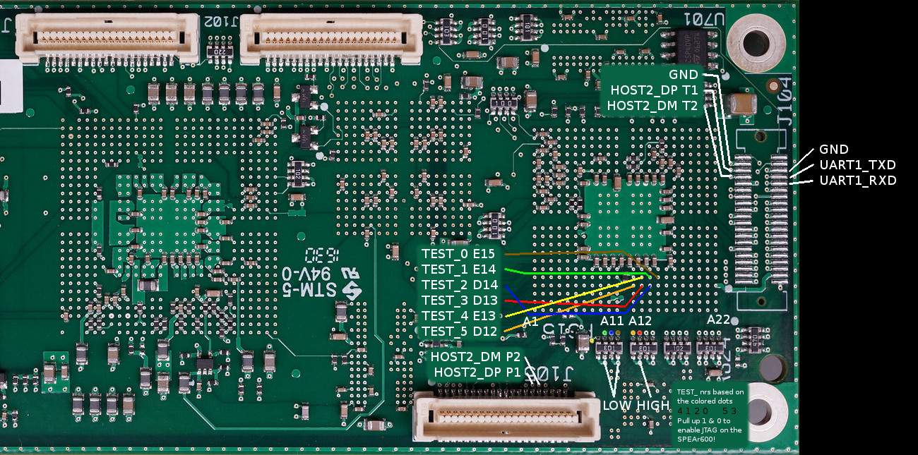

Serial, JTAG and extra USB port (HOST2 on front, HOST1 not connected by default)
An error in USB HOST1 pinout on J104. The D+ and D- signals should be swapped on the unpopulated connector on the BLT module. A copy of the corrected photo is attached.
Caused me some grief before I figured that out  :D
Also added HOST1 VBUS and HOST1 OVRC signals.
« Last Edit: November 05, 2020, 05:03:50 am by Bud »
