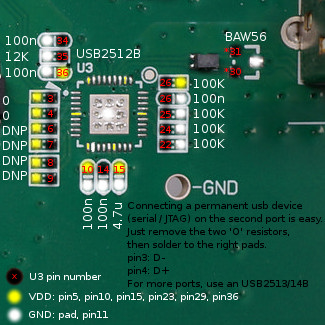

Until then I made a little reverse engineering on the missing 36 pin IC, next to the USB-B connector.
Turned out it's a USB HUB controller, not an ethernet controller. Why should they do that? More USB input perhaps? Question is it can handle an USB-ethernet adapter?
Datasheet: http://ww1.microchip.com/downloads/en/devicedoc/00001692c.pdf
And here is some picture:

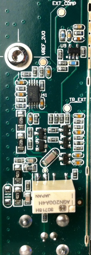

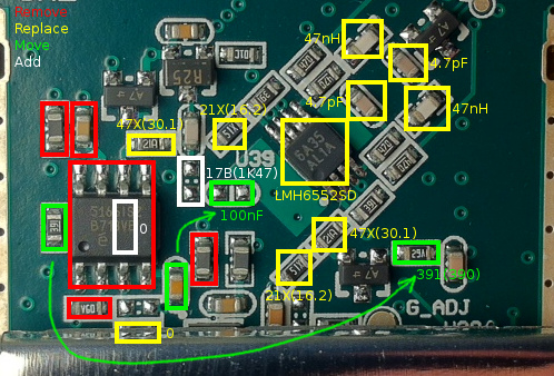

Adding missing components for the external trigger and replacing a few components at the front end area also worth it, just look at my nice square wave. Mine is successfully get trough user calibration after I had a few hiccups.

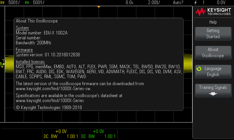

So here is a few interesting errors and clues for others. These are cuts from the serial log under calibration.
External trigger area, mysterious(no one measured it) cap under the comparator(LMV7219):
4.7uF
**** External Trigger Level ****
/1 Trig B1 = 5303.000, B0 = 35860.000
/5 Trig B1 = 1071.000, B0 = 35860.000
**** CAL FAILED ***
100nF
**Xtrig Delay Cal**
Failed.  Could not get a duration trigger to fire.
**** CAL FAILED ****
10nF
Cal Satus    : CAL_OK
So looks like a less than 100nF cap is necessary here. You can tell that just the color of the cap from a DSOX picture. And yes that's a misspell by keysight :-DD

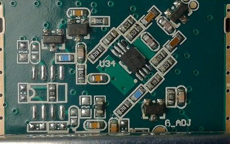

Frontend LPF filter after diff amp, before ADC, when the two caps are too big. Basically i got a saw on the screen instead of a perfect square waveform from my source. It was funny to see and also the look on my face..
**** Baldwin Trig Time Qual ****
Set CalConfigScope range 1.000000E-005, delay -1.000000E-006
FAILED!  Top meas failed to return good value

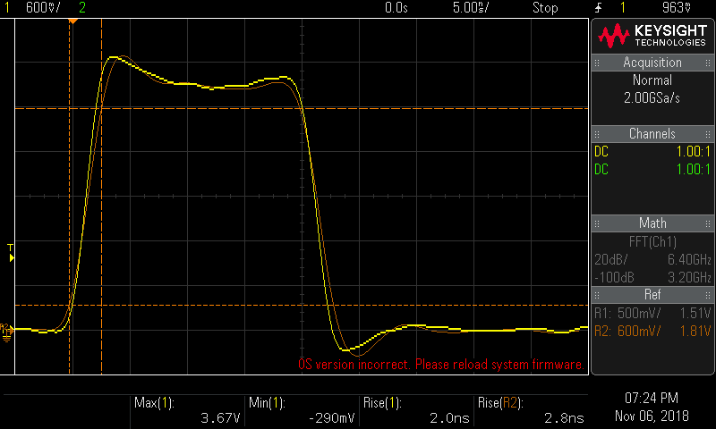

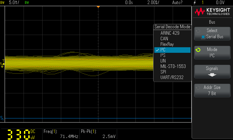

One more note. After replacing the diff amp at the frontend with a LMH6552, I got a ~500uV/div offset in minus, but it's gone after user calibration.

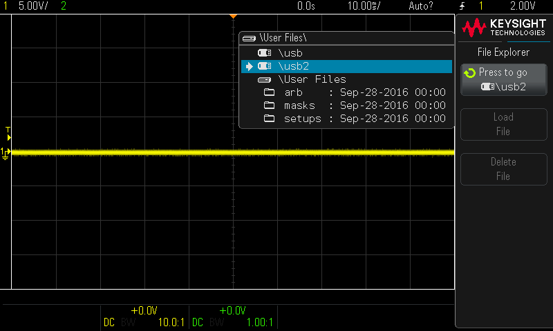

USB Hub hack.. I really don't get it why keysight put it there. The hub is for your PC, not for your scope. So I added a usb2serial adapter to the second downstream channel of the hub and no more hanging wire from my scope anymore, very neat.
Also there is a missing pair of protection diode here and there is one at the other usb socket, so no wonder why ginbot crashed the scope by just wiggling an USB drive.
Ohh just to confirm, ginbot's hack worked for the first try, nice job! :clap:
If you really need a second usb port, you have to utilize some pins on the none populated connector at the BLT board. SPEAr600 has 2 host ports. I use this for a permanent usb storage.
So everything looks great, I'm happy with the modifications and it's time to take a look into the firmware. First glace it's not that easy, usb boot not working and without a lan card I have to modify the nk.bin.comp file then flash it under windows to the second image space, then switch to it under uboot.
After all here is a few picture. More to come, but I have to edit them.
second usb
After I added the LMH6552. CH1=new LPF filter, R2=original LPF
frontend before (CH2)
frontend after (CH1)
ext. trigger before
ext. trigger after

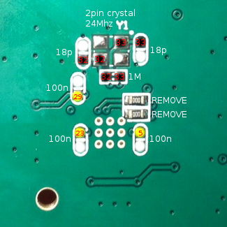

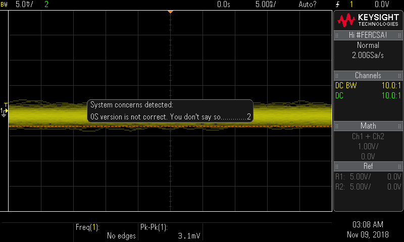

More pix:
First patch, looks like everything is on track :popcorn:
Serial, JTAG and extra USB port (HOST2 on front, HOST1 not connected by default)
In the future if someone open up his/her scope(-G version), I'd really appreciate a hi-res photo from the wavegen area.

FW v1.1: https://bit.ly/dsox1102hack
MD5: ad84976ff2f5b044a21020436751c5c3
1.1 is the same as 1.0, it's just add a small guide while you updating.
Just copy my .ksx file to an usb stick then insert into your scope and open it with the built-in file explorer.
A few minutes later, when the screen turned to pitch black and every LED turned on make a cold reset (power off-on). Sometimes soft reset won't work..
A few times happened with me, if you can't load the firmware from the file explorer, just reset everything back to default and try again.
There are a few known bugs like the PWR, Power application, you can't select certain menu items.
Another one is BW50, I found some sub routines which relying on different frequencies like 50-70-100-200 but no mention of 500. It's not a big deal anyway because you can't go way beyond 200-220Mhz.
If you find something else just report it, then maybe it's fixable on assembly level without a bunch of work.
I loaded every possible options, so no difference between "normal" and -G version.
Also I put the original non-modified fw to the second image location as a fail-safe. You can switch to it with a serial cable by pressing 'space' then select '2' on the beginning of the boot process.

Everything seems to work as described.  Training signal menu is missing i2c and SPI.  I will continue testing.
Amazing hack  :-+ :-+ :-+  Santa arrived before Christmas!

Did you replace the LP filter too? After the LMH6552, because the 150-160MHz a little bit low, I can measure a 200-205MHz pulse without any attenuation. Unfortunately I can't go above this right now, but looks like the scope still has some juice in it.
I had to dig into my notes, but I found it, so these are the components what I used:
LQP18MN47NG02D (47nH)
CL10C4R7BB8NNND (4.7pF C0G)
Don't ask. I'm the same guy who gave you ultra fast internet in the '00s..
#FERCSA
