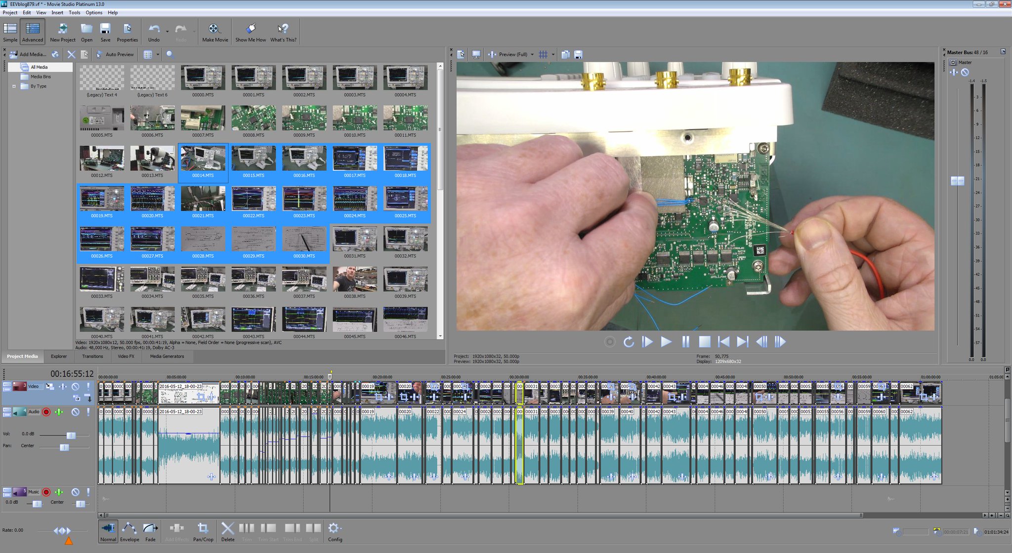

Here is my edit for todays video:
1hr of material, and the only audio adjustment required is on half a dozen clips that were unusal in that I shot them on my Tagarno microscope with HDMI capture. Not my usual setup.
Maybe the odd tweak on a few tracks to drop the level were I got annimated and raised my voice, but that literally takes one mouse click and drag and 1 second to do.
Everything else recorded in camera and screen capture doesn't need anything.
And no, I don't use auto level on my camera, always manual audio level.
Aha, I think i have a good idea what this video is going to be about.
