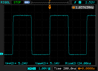

Well, it seems that the Channel 2 test results are a carbon copy of the Channel 1 ones, above!
So, the analog front-end alone must not be held responsible for the noise issue.
Check: Two down (PSU, Analog front-end), who-knows-how-many more to go!
Here are the Channel 2 test results:
1. Ch2 x1 waveform using ground lead, unfiltered
2. Ch2 x10 waveform using ground lead, unfiltered
3. Ch2 x10 rising edge using ground lead, unfiltered
4. Ch2 x10 waveform using ground lead, filtered
5. Ch2 x10 rising edge using ground lead, filtered
6. Ch2 x10 waveform using ground spring, unfiltered
7. Ch2 x10 waveform using ground spring, filtered
Changing the probe:
8. Ch2 x100 waveform using ground lead, unfiltered
9. Ch2 x100 waveform using ground lead, filtered
Something different, now:
10. Ch1 probe on the probe calibration ground; 1GSa/s. Similar to "Noise 8" at the first message but in dot mode.
All the individual ADC samples are in the most expected positions.
Note that this is a full 1GSa/s because Ch2 is off as well as the long memory option; so, all the ten ADCs are involved and they all seem to be in order.
Three down... (!)
-George
« Last Edit: June 14, 2011, 11:34:22 pm by A Hellene »

Can you run your noise sample test as you did with the post quoted below on Channel 2, alone? Channel 2 looks quiet and fine based on early images you've posted, see image.
Thank you for the reference screenshot.
This is what my unit displays, respectively (probes disconnected):
Oops, it seems that I missed that detail in bold, above...  :-[
Here it is:
Ch2 max. sensitivity noise (probes disconnected)
-George
« Last Edit: June 15, 2011, 01:13:15 am by A Hellene »

Re: Rigol DS1052E nasty surprise!
« Reply #15 on: June 15, 2011, 12:25:36 pm »
More ouch, Hellene, it confirms that the problem is in the DAC or PCB.  More later.
The base appearance of my unit using the calibration signal.

So it seems something is going wrong with your scope.
A stupid question (but I am often stupid with my own machines) : you did the calibration process right ? May be you could recall the factory settings then redo a calibration...
But for me everything appears to work as something was poorly grounded somewhere...
