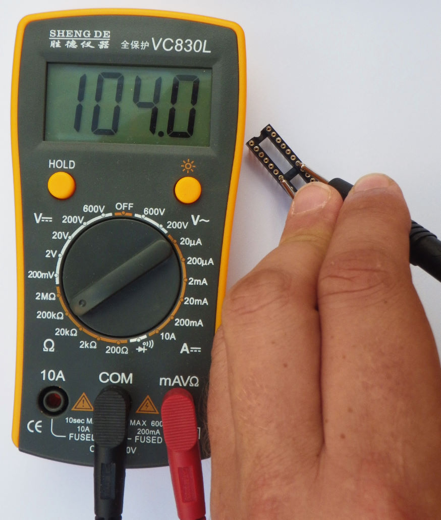

I have a new Bad Shopping Experience to contribute. It is an item which I thought of as completely risk-free to buy from any far-East eBay seller, and I sometimes add those to an order, because you always need them anyway: DIP chip sockets.

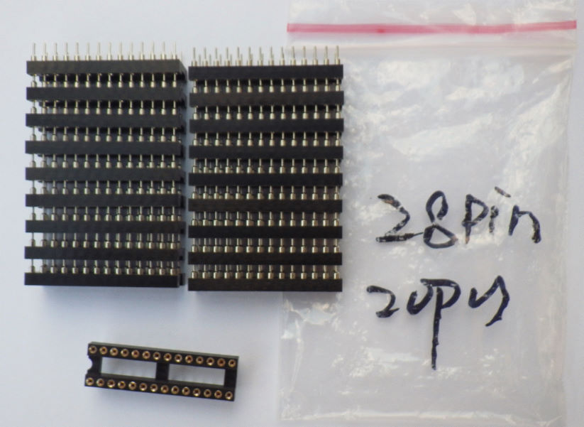

Last year I bought a pack of 20 precision, narrow 28-pin DIP sockets from seller auspicious (should it read suspicious?) - of which I now used the first one in a small AVR project with a colleague of mine.

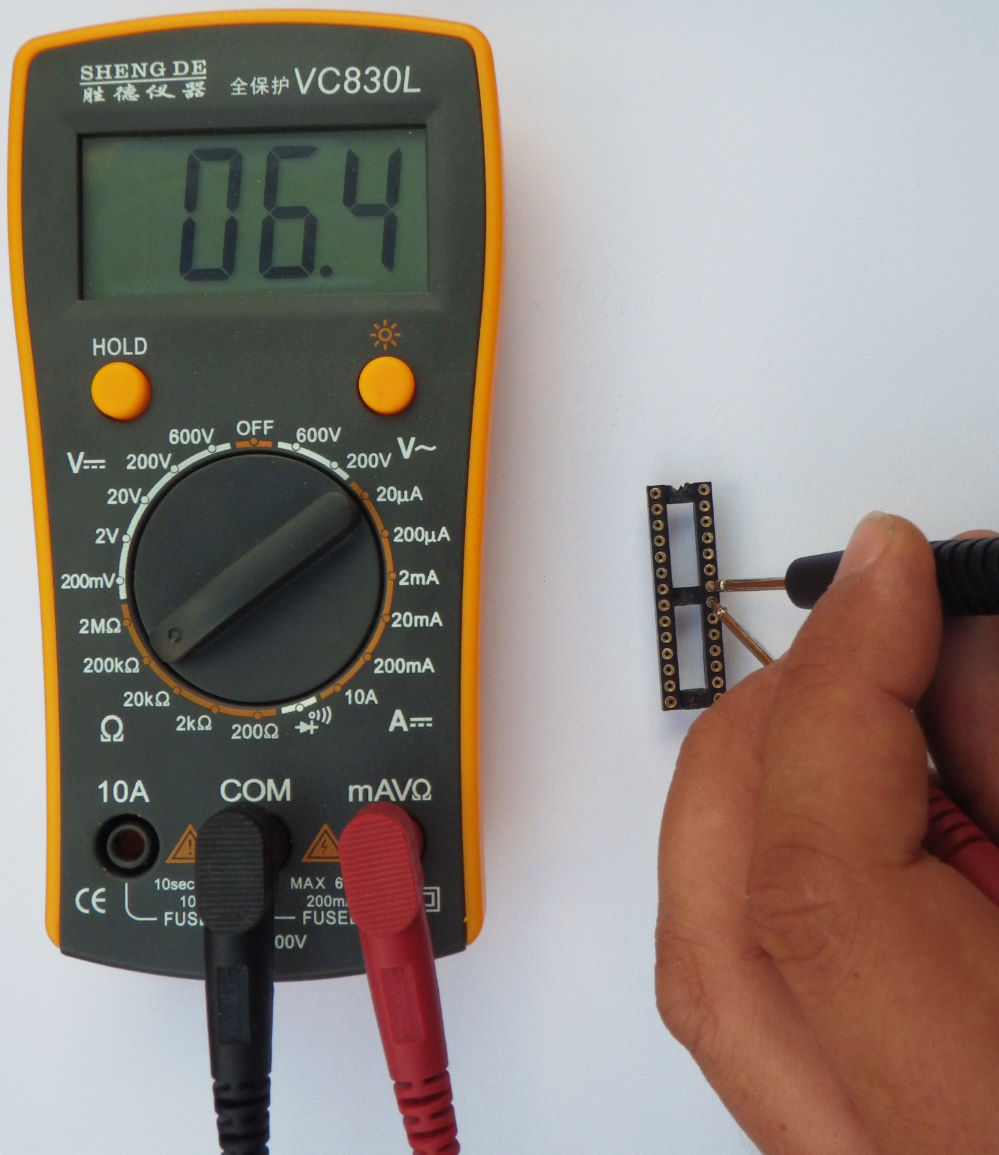

The circuit didn't really behave as it should. Internally pulled-up inputs would show only around 2.5 V on a 5 V supply, when measured externally with a standard multimeter. I thought of all different causes: flux-traces, salt (it's warmer than 25°C in our lab and we sweat), solder bridges...
Then I removed the AVR from its socket, remeasured the resistance between neighboring pins. Strangely, two not-connected neighboring pins which had a trace in between measured only 6 kohm to each other but higher than 100 kohm to the trace in between...  :-BROKE
Then I measured from the pin to the plastic of the chip socket...  :-DMM
Well look at the images - and no, I am not touching the probes with my fingers!  :-/O
This is how the sockets were delivered:
I guess that you do not have any ESD problems when using these sockets.  |O
