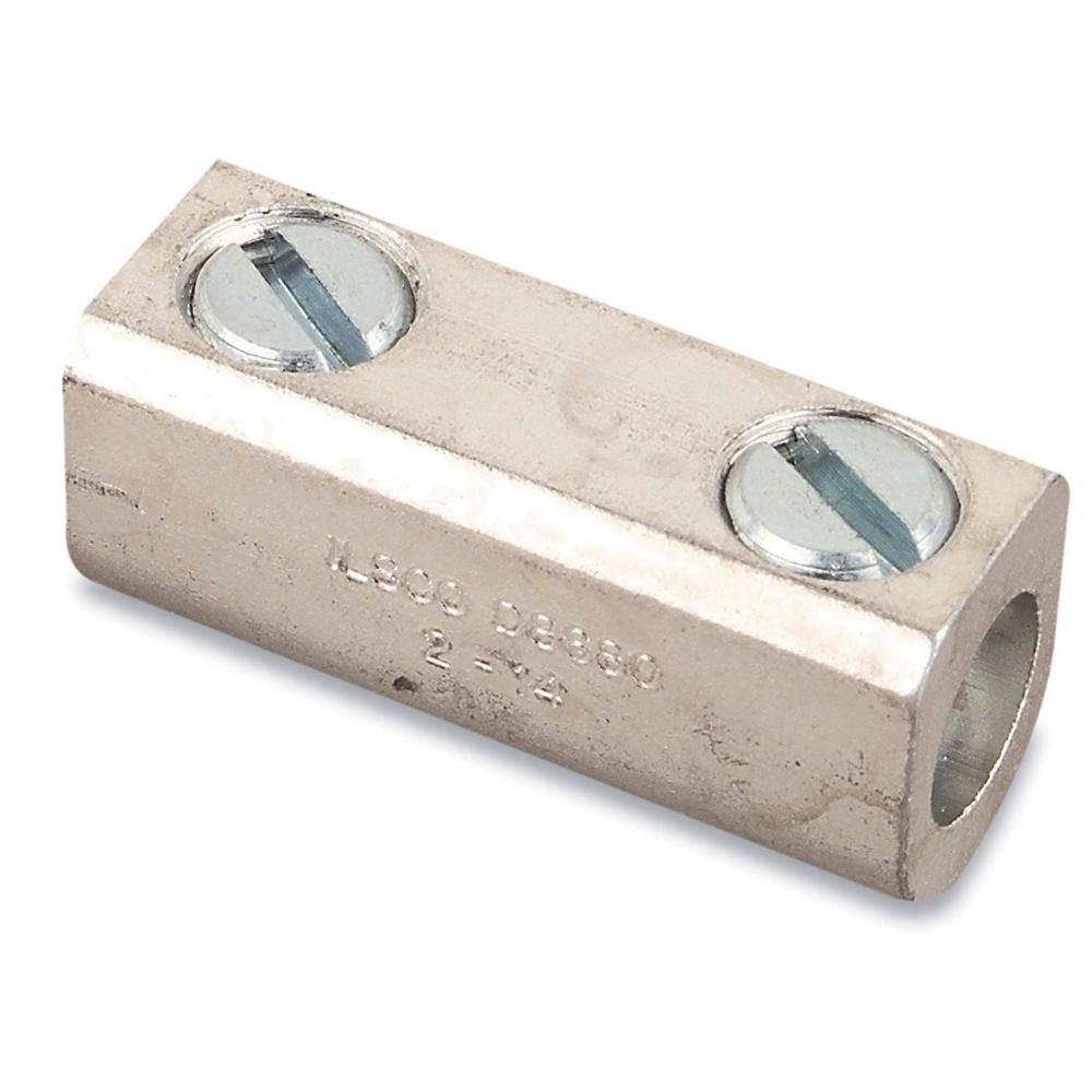

« Reply #14 on: October 03, 2018, 05:15:16 am »
Open to other ideas though, just need to fuse thick wires together in a non mechanical way that will possibly be outside, so soldering seems like best plan.  Low voltage.
Don't solder.   You really do want a mechanical splice (as others have said).
A split bolt is one option.   Another is a splice as shown below
there are also crimp connectors.
You can waterproof it either with appropriate marine heat shrink or self-fusing electrical tape.   The self-fusing tape needs some explanation - it's basically tape which when wrapped around a joint it fuses with itself to provide a waterproof layer.   There are multiple options out there.    And multiple ways to use it (some like to wrap the joint with normal tape, then fusion tape, then cover with more electrical tape - others just use it  by itself).
Of particular note on soldering:   Solder really should only be used in those cases where you can join the wires so they are electrically stable without the solder, then solder applied.   In the US, the electrical code says:  "Soldered splices shall first be spliced or joined so as to be mechanically and electrically secure without solder and then be soldered.".   The purpose of the solder is to make the already electrically and mechanically spliced wire more stable over the long term (so the twisted together wires don't work themselves loose).    The best way to think about this is to think about what happens to your joint when the solder gets hot and drips off.   The joint should be stable enough so that the solder isn't really needed.
Because of the hassle of doing all of this, mechanical splices have been developed to the point where soldering isn't required.  And for most mechanical splices isn't recommended.

Offline Red SquirrelTopic starter
  • Posts: 2751
Re: 94.5% lead solder dangers?
« Reply #17 on: October 03, 2018, 05:35:01 pm »
Why solder the wires? As mentioned, get decent lugs and use a crimper to make the connections. Slip some heatshrink with the meltable liner over the lug /wire connection point and you're good to go.
Crimping cables for battery lugs etc is MUCH more preferable than a solder connection, I see no reason why you aren't doing the same with this somewhat thinner gauge.
cheers,
george.
It's too extend a cable and not to connect to a terminal.  The cables I bought ended up being too short so I just need to add more length.
Some of the lugs shown here do look interesting but again this is for an inline splice, that may possibly even be outside, and I have no idea where I'd even buy those connectors.  I find anything "industrial/commercial" tends to be very hard to find. Can find the odd thing on Ebay/Amazon sometimes but even that is hit and miss. Most sites I find are also US and not Canada based so don't want to get hit with duties.
That said if this high lead solder is a problem I'll try to order something else.  I did not notice when I ordered that it was so high.   This is the solder: https://www.amazon.ca/gp/product/B003X3VUDM/ref=oh_aui_detailpage_o01_s00?ie=UTF8&psc=1
Suppose another option is to just buy PV connectors and crimper and use those to extend the wire.
« Last Edit: October 03, 2018, 05:43:22 pm by Red Squirrel »
