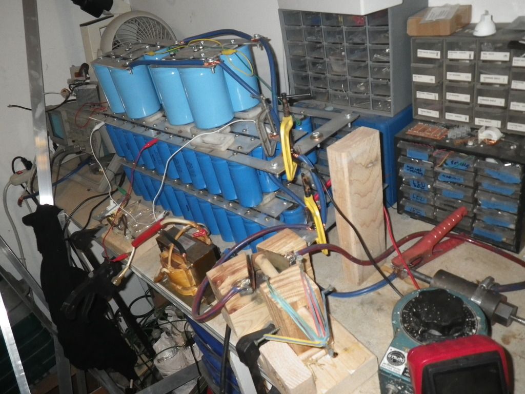

I have these from a project i build a while ago, I think the bank was .01F at 900v iirc.
