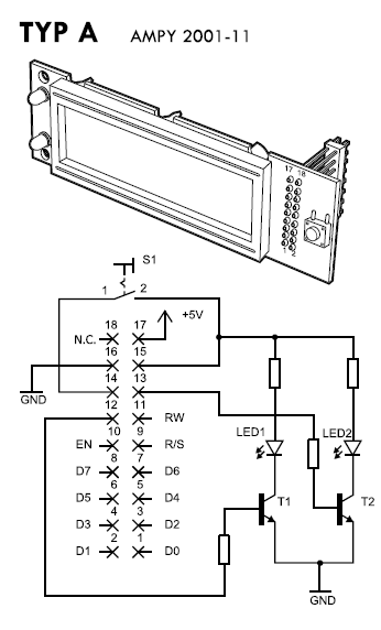

Hi guys.
Just picked up an odd bag of display components, a few LED displays and sorts, I don't usually buy these crappy bags of junk, but one thing attracted me and at the price, an AMPY 2001-11 LCD.  I though this LCD display was worth the money itself, but it seems I may have been wrong as I cant find any information or data sheets on this device,The so called supplied datasheet was about as useful as a fork in a sugar bowl.
I'm experimenting with AVR micro's and wanted to take my projects a little further with LCD's.
Maybe some of you guys have seen or know about this or even have a datasheet.
A pretty extensive Google search came up with nothing??
Help please.
Thanks.
Online tom66
  • Posts: 7217
Re: AMPY 2001-11 LCD Display
« Reply #1 on: January 26, 2013, 10:58:15 pm »
It is most likely a HD44780-style interface going by those pin names.

I concur with tom66. Searching for how to hook up a HD44780-compatible LCD to an AVR should produce dozens of hits.

Yes, it's a Hitachi HD44780 clone. Anything chinese is almost always a copy of some existing western standard, just renamed.
You can find more variations of LCDs with this controller at Allelectronics.
40x2 (80 chars) is the maximum one controller can address. 40x4 screens exist and just use two controllers.
You can pull these screens out of many electronics from the 80s to 90s... desk phones, alarm consoles, ind. automation displays, etc

I picked-up one of these party-packs too - Maplin, by any chance?  (called RadioShack if you're in the US)
I thought it looked like a 16x2 5v display. Anyhow, I plugged it into a project I'm working on ATM, and hey-presto! it ISN'T 16x2, its 16x1 large characters, and another line, much smaller, of some "other stuff". Check out http://www.tgsolarsystems.com/downloads/5224-ampy-meters-user-manual-and-technical-specfication.pdf as an example of this kind of display. Maybe the same one, I don't know. I'm getting some characters displayed on the bottom, but I haven't figured-out yet what they are/how to drive them correctly. I think some are single-use characters, e.g. at the mo I have a single "h" in the lower portion, just left of centre. It isn't bitmapped though, its really quite clear. It looks to me like you can either have an "h" there, or not - nothing else. Over to the right I can get some funny graphics characters which presumably have a meaning in the product for which this LCD panel has obviously been specifically produced.
Anyhow - as guessed before, the first line behaves according to the HD44780 standard for a 1x16 display.
If I get any further with a definitive description of the second line I'll post it here.

Well, I wouldn't call this definitive but here goes...
I've used these 2 tables on a PIC to define the address and data for the 2nd line graphics:
posntab
   addwf   PCL, f
   dt      0xc1,0xc1,0xc3,0xc3,0xc5,0xc5,0xc7,0xc7,0xc8,0xc8,0xca,0xca,0xcc,0xcc,0xce   ;
chrtab
   addwf   PCL, f
   dt      0x07,0x00,0x07,0x00,0x07,0x00,0x07,0x00,0x07,0x00,0x07,0x00,0x07,0x00,0x00   ;
where you'd use the same index into both. The values in chrtab are just some that I found to work. Possibly there are individual bits to control the graphic characters, but I doubt it because writing zero also causes many (but not all) of them to appear. It doesn't seem to be as simple as some bit having 1=off 0=on though. Or maybe it is - I'm pretty tired now.
Here's a little video I just made: http://youtu.be/PQXrQS4AeZA

I have the top line working with a Picaxe routine.
A few findings...
  • Seems that only 8-bits LCD addressing works. I tried 4-bit and I gave up.
  • They are HD44780-compatible LCDs with respect initilisation
I will use the info @Chaz posted to address the bottom set of chars. @Chaz. Who did you address the second line? If I use HD44780 2nd line instructions I get random chars.

The annunciators on the bottom are best controlled with the custom characters. You write fixed character values to the screen memory, but manipulate the custom characters to control the annunciators.

Information from my work last night.  I can now address the 16*1 using a standard LCD driver.  Cursor position and all the normal LCD codes work ok.  The first line is adddress from 128, this is the same as normal LCD driver.
I am using a Picaxe to interface to the LCD, in 8-bit mode. (I think I code you could use 4-bit mode by pulling D0-D3 to ground which I failed to do yesterday - but, it ho hum).
I believe the symbols are in two pairs, addressed as pairs of characters. The DRAM addressing is as shown in the routines below.
Example, the first two symbols on line two are addressed at position 193 with "D"|"J"|"E"|" " chosing the left, right, both or clear respectively, the space clears the chars. They run in two step until 199 then 1, then back to two step... odd. But, this code does seems to work.
Please examine the code as the example is a general rule.  There is one adapation to the rule.
Works OK for me.

Offline philthetechie
  • Posts: 6
« Reply #20 on: February 11, 2013, 02:23:24 pm »
Hi Guys,
I also picked one of these AMPY 2011-11 up and am trying to run it from an Arduino.
I'm getting power to the LCD fine, and using the Arduino Hitachi Library.
Using any 4 or 8 of the data pins and  will not make the LCD show data, and I have no way to know if it is even receiving the instructions.
All I get is a row or boxes when i hit the power, as as if it is not driven at all. If this is a Hitachi clone, I would have expected to be able to drive it this way.
--Any Ideas?
What i'm wondering as well is what do i do with pins 11-13? They seem to be powering LEDs and then is that a timer, but i'm not an electronics expert so I must be missing something. There also seems to be NO backlight functionality on these.
Can someone simply give a numbered pinout list and a code example to use the arduino LCD library to drive this thing?
and explain what the timers are doing.
Sorry for demanding it spoonfed to me, I'm pretty useless with this LCD - it has me stumped!
Thanks in advance.
« Last Edit: February 11, 2013, 02:26:06 pm by philthetechie »
Offline Chaz
  • Posts: 8
« Reply #21 on: February 11, 2013, 05:11:01 pm »
philthetechie,
Do you still have the datasheet? if not, its at http://www.kemo-electronic.de/datasheets/s043.pdf
You definitely need pin 11 because its the R/W pin (I notice on the datasheet its labelled as RW, but it should properly be R/W where the W has a bar over, meaning "not W")
I also notice that there is a pin marked as R/S, but this should read RS because it means "Register Select"
Anyway, the connections you need are:
pin 01 is D0
pin 02 is D1
pin 03 is D2
pin 04 is D3
pin 05 is D4
pin 06 is D5
pin 07 is D6
pin 08 is D7
pin 09 is RS (Register Select)
pin 10 is EN (Enable)
pin 11 is R/(not W) (Read/not Write)
pin 16 to GND
pin 17 to +5V
The others you don't need, and pin 01 to 04 you don't need if you manage to get the 4-bit interface working. I'd get the 8-bit working first, then decide.
Looking at the datasheet be careful how you read it - the pin numbers are ABOVE the pin, so where the number 11 it is above a pin which it doesn't show connected to anything, but the pin above the number 11 (which is pin 13) is connected to a transistor used to drive LED2. Don't bother trying to get the LEDs lit just yet.
The Arduino Hitachi library should have a document describing the pins D0-D7, RS, EN and R/(not W), and where to connect them.
A quick note about R(not W) (and if you already "get" this then I apologise) if this pin is high then you are reading, i.e. not writing. If this pin is low then you are not reading, and you are not not-writing, i.e. you ARE writing. I'm not reading from this board, so I've got pin 11 connected to GND.
There aren't any timers I'm aware of. There are a couple of transistors on the board labelled T1 and T2.
Interesting that this board doesn't have a VO (Operating Voltage) pin. This is usually used to set the display contrast. I guess they use a fixed resistor on-board.
I think you're right that there is no backlight.
If you also put a constant 5v onto pin 15 then you can get the LEDs lit by raising pins 11 and/or 13 to 5v. Also, you can read the push-button on pin 14. So you can connect pins 11 & 13 to outputs on the Arduino and it'll light the LEDs when you like, and you can connect pin 14 to an input on the Arduino and you can see if the push-button is pressed.
How well do you know the Arduino? you'll either have to poll the button (check very regularly) or connect it to an interrupting input and write the interrupt handler. (much better way)
Best regards
« Last Edit: February 11, 2013, 05:58:54 pm by Chaz »
  • Posts: 6
« Reply #22 on: February 11, 2013, 08:24:05 pm »
Thankyou Chaz! Your a gent.
Going to have a play now, and i'll let you know how i get on.
From the sounds of it i've been going off the hitachi example too much and concentrating on 4bit/4pins (+rw, rs and enable) to get the single line working. Going to retry with 8bit and no R/W now.
Good to know I can ignore the led's now too thanks.
Cheers,
Phil.
  • Posts: 6
« Reply #23 on: February 11, 2013, 09:34:30 pm »
I'm pretty sure i have a faulty board now.
I've wired up as you have mentioned, using R/W as not-not-write (i.e. to ground), and using the code:
LiquidCrystal lcd(12,10, 0, 1, 2, 3, 4, 5, 6, 7);         //  RS/Enable/d0-d7
void setup() {
  lcd.begin(16,1);          //  or 16,2 - tested both ways as this board has a 2nd line of symbols.
  lcd.print("test");
I get a out-of-sync error when uploading the file if the power is going to the LCD-
avrdude: stk500_cmd(): programmer is out of sync
Have to unplug +5v from the LCD to upload. This makes me wonder about the state of the LCD.
When i connect the power, there are just 16 black boxes instead of 4 characters.
The layout i'm using I had tried before using the datasheet but im apt to blame my own ineptitude rather than components - but now...
Have tried 4 and 8bit, tried connecting R/W to pin 13 and using the format
LiquidCrystal lcd(12, 13, 10, 0, 1, 2, 3, 4, 5, 6, 7);
Nothing is getting any data to display.
Bit of a bummer... Wonder if they will do an RMA on a lucky bag? Worth a shot.
Offline mariush
  • Posts: 5162
« Reply #24 on: February 11, 2013, 10:14:36 pm »
You probably didn't connect it properly.
If this is the display,
pin 1 to 8 is data
pin 9 is rs
pin 10 is en
pin 11 is rw
pin 12 and 13 are the leds (send 5v or a digital 1 and led lights up)
pin 14 is the button ( put a 1-10k resistor between that and your controller pin, set the pin to input and when button is pressed you get 1 on controller pin)
pin 15 is voltage to make the leds work and the button (if there's no 3.3v-5v on this pin, button and leds won't work)
pin 16 is ground
pin 17 is 5v
pin 18 is not connected
So I think you should have LiquidCrystal lcd(8,9, 0, 1, 2, 3, 4, 5, 6, 7);  -  i'm saying 8 and 9 because you've used 0 to 7 for data, so I assume you used consecutive numbers for the rest.
