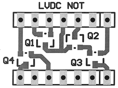

Noob question. I havent seen transistors arranged in that way before, inputs on the emitters, and the collectors connected to the base of the third... What is actually happening here? Im having trouble following it.
Ah - you have to think about the direction of current and the way transistors switch.  These DTL and TTL circuits work on the idea that you ground the emitter/cathode to allow current flow and otherwise the bases are pulled high.  Each gate assumes there is a high bit there unless it is told otherwise by a low (ground) state.  It seems bass-ackwards but this is how it was done.
Ah, cheers. I did some googlin', and thinking of that transistor as a couple of diodes makes it easier for me to visualise.
I also looked at the NOT gate on your website fran, my next question is about the two diodes next to the output of the not gate... What would be the effect of omitting them?

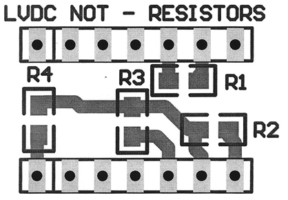

Re: Apollo Saturn V computer logic reverse engineered - with working model.
« Reply #14 on: February 10, 2013, 04:49:26 am »
Hmmm...  Good question - Dual diodes is overkill and the lower NPN transistor is an adequate emitter follower in itself, so I would think it would be stable without the diodes.  I do think though that having at least the one diode between the upper emitter and the output would help a lot with balancing the output impedance when the NOT gate output goes high under load.

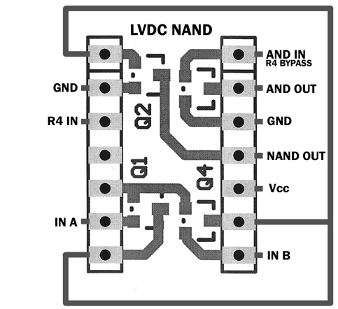

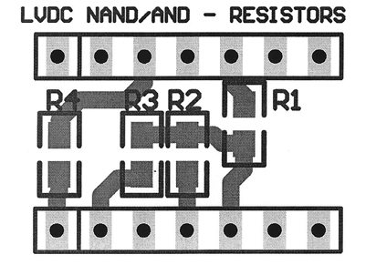

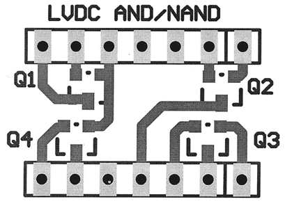

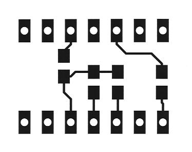

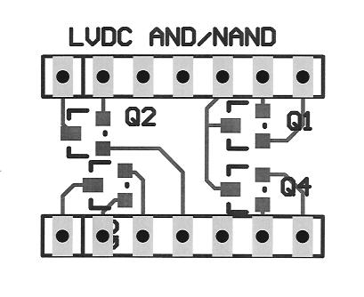

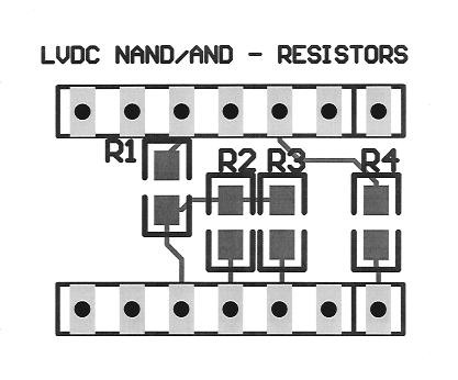

LVDC-NAND Dual PCB Prototype -
Demonstration of the production prototype of my LVDC NAND gate package, with dual surface mount PCBs.
Offline FrantoneTopic starter
  • Posts: 126
  • Geek Girl Makes Stuff!
    • Frantone Electronics
« Reply #17 on: February 17, 2013, 05:09:07 am »
Final specs and artwork for the Do-It-Yourself LVDC project are here: http://www.frantone.com/designwritings/design_writings.html#LVDCbuild
Good luck, and have fun! O0
