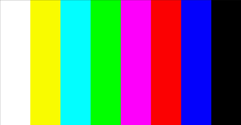

The problem are the colours.
Instead of THIS,
I have this:
The problem is not with pure R pur G or pure B, the problem is when I mix for example blue and red, as you can see instead of pink, I have a full-red...
The red looks pale red.
The yellow looks pale green.
The green doesn't look... green but light blue...

UPDATE AND SOLUTION
Here was the problem, the cable to the 4OSC pin when I move it, the colours changes.
I shorted this cable as much as posible and here we go!

Dear freind, those HEX value don't mean nothing in this case, this picture is only here to illustrate (I removed then and rectified my initial post) and as you can see I send only R,G and B values 0 or 1 - So we must obtain only 8 colours with this, not all the grayscales of each channel.
