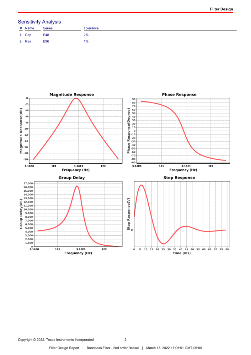

Hello,
I'm trying to design a band pass filter for an audio application and i'm curious to have you advices on audibility of an eventual quality degradation that i haven't thinked about because i'm not a secialist at all.
Offline TimFox
  • Posts: 9002
Re: band pass filter for an audio application
« Reply #1 on: March 16, 2022, 08:23:18 pm »
For large capacitors, e.g. 1 uF, the type of capacitor may be important.  Polypropylene film is the usual "good choice", with very high Q and therefore low ESR, but X7R and Z5U ceramics will have substantial loss and nonlinearity.

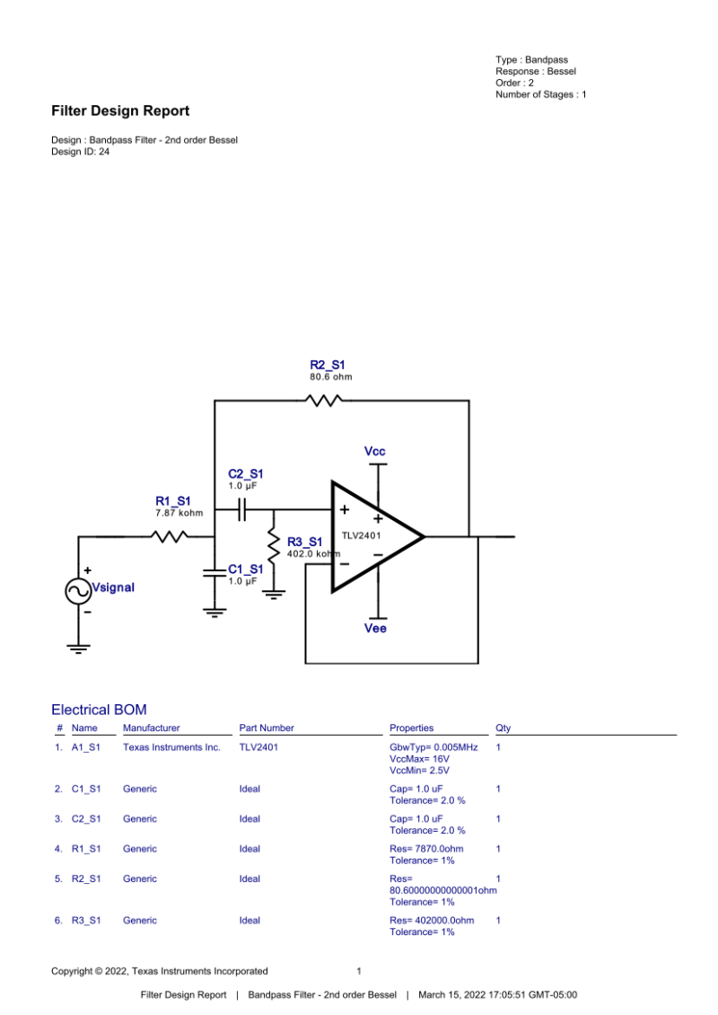

Ain't no such thing as a "Bessel" band-peak filter (band-pass is something else in my book, particularly for audio).
The only thing that matters here is fc and Q.
You apparently need a low Q filter. Sallen-Key is OK for that. For higher Q, I recommend using a MFB filter instead.
Offline dmills
  • Posts: 2093
« Reply #4 on: March 16, 2022, 08:44:04 pm »

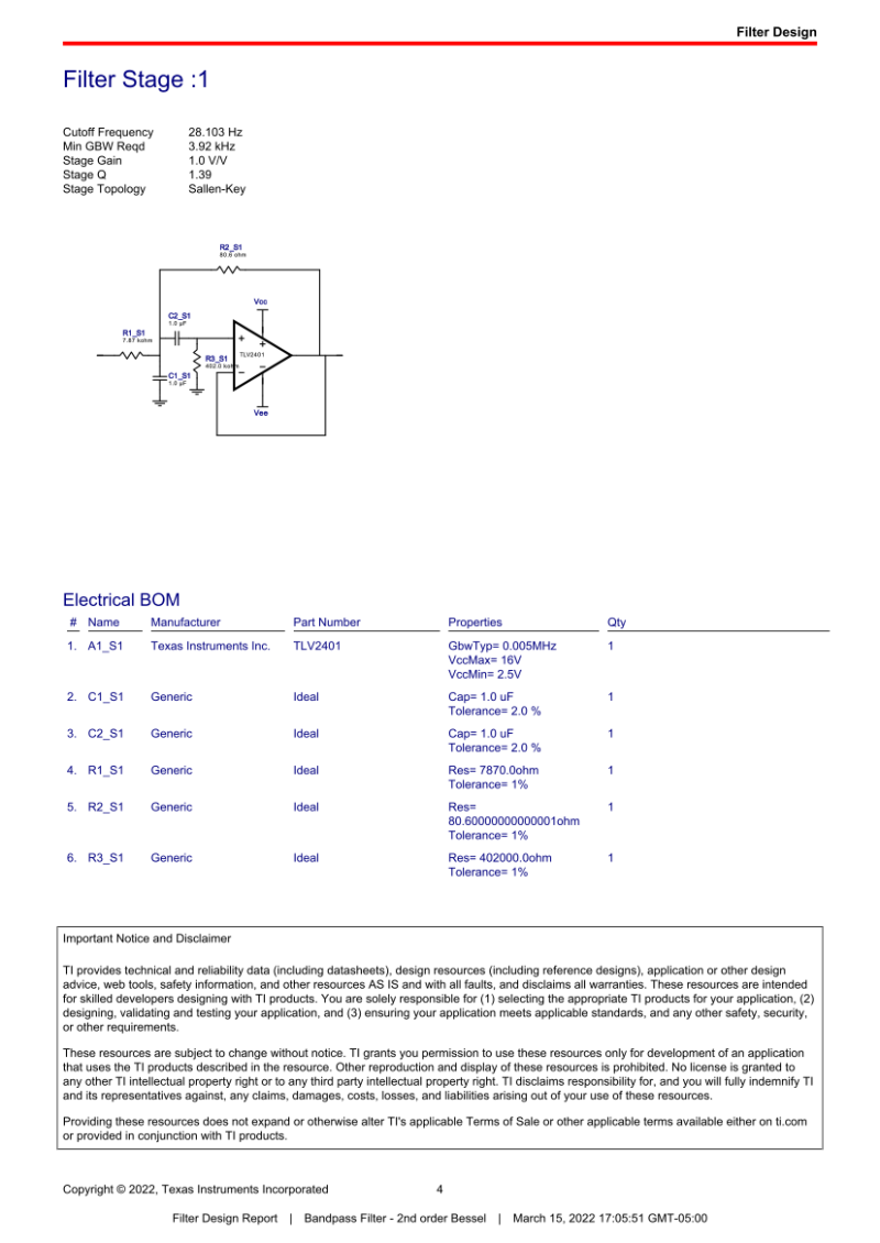

Not I suspect going to work!
The TLV2405 has all of 5kHz GBP, and a few mA of output drive, and you have an 80 ohm resistor in the filter feedback path (With 1uF to ground??!)?
Sallen and Key topologies are notoriously 'interesting' once the opamp runs out of GBP so I would at least be opening the plot out to see what happens in the top couple of octaves (The lowpass version of things have a bad habit of coming back once the opamp is out of puff).
Offline Benta
  • Posts: 6420
« Reply #5 on: March 16, 2022, 08:48:39 pm »
Ow, ow, ow!
Probably the worst opamp in the world for this application. Didn't check that.

I'm trying to perform a peaking filter circuit like the digital ones used in equalizer APO.

I agree that that opamp is too slow, but the 80 ohms to 1 uF, at his very low center frequency (3.1 Hz) will present a load impedance of about 50 kohms (reactive) to ground, which should be driveable at a few volts.  I would scale the resistor values up and the capacitor values down for this application, after doing the initial calculation.

TLV2401 :
Slew rate (Typ) (V/us) 0.0025
GBW (Typ) (MHz) 0.0055
TL071 :
Slew rate (Typ) (V/us) 13
GBW (Typ) (MHz) 3
So, the TI simulation have choosen the TLV2401 because of its ability to operate with the half gigaohm resistors imposed by the calculations ?
How on earth would we know what the TI simulator is doing? A little engineering sense on your side is perhaps also needed?
Accepting simulator results on their face value is why catastrophes happen. And why good engineers are needed more than ever.
Offline dmills
  • Posts: 2093
« Reply #10 on: March 16, 2022, 11:30:04 pm »
When a simulator says 'No', it is probably correct, when it says 'Yes' that should be read as 'Maybe'...
Sims are only ever as good as the models and a LOT of the models leave something to be desired.
Any time you have an active filter with half gig ohm resistors AND sub 100 ohm resistors I would be looking very, very askance at it, and probably doing it in two stages in pursuit of a more reasonable design. It COULD be a reasonable design, but it is a design smell.

Why is a "half a gigaohm" value being discussed? Largest resistor in that schematic is 400 kOhm.
And venerable TL071 (the JFET version) would work well in this circuit.
My recommendation to OP is that it is time to make a prototype.
Get few different capacitor types. Try them.
You can measure it with sound card and software...

I've experenced some phase revesal, oscillations and hard clipping with the NE5532 and find it too touchy for my skills even if i've succeed to use it sometimes.
All my circuits are stable with the TL071, but larges resistors are prone to be noisy, aren't they ?

It is physics that larger resistors have larger noise. But engineering is not about perfection but about art and science of compromise. Depending on signals and where in signal chain you are noise might be low enough not to be a problem.
Serously, that is 2-3€ worth of components. Just cobble it together and try it. Measure with sound card and some of excellent audio measurement applications. You need to learn all of it..It's all useful.
