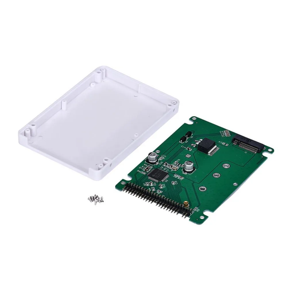

This is suspicious IMO. Could be CF card with adapter PCB inside. Or msata/m.2 SSD is you are lucky.
« Last Edit: March 29, 2017, 03:08:51 am by wraper »
Online wraper
  • Posts: 17871
  • Country: lv
Re: Cheap PATA SSD on ebay.
« Reply #4 on: March 29, 2017, 03:00:47 am »
I would rather buy just buy such cheap adapter + SSD you can trust. Not those probably built with 3rd grade/reject NAND with tons of bad blocks, decent manufacturers won't use in their products.
http://www.usbtalk.net/2009/09/nand-flash-chip-grades-explained/

You can always get a compact flash card and a cheapo CF to 2.5" IDE adapter.
Compact Flash has IDE on its pins so adapters are merely physical. This makes them cheap and reliable.
The Sandisk Extreme 64 gig is $44 and can do 120Mbyte/second, close to the max of 133 that the final revision of PATA has. An adapter might run $9 or so.
Your older devices probably don't support UDMA-133, though, so no matter what you do don't expect blistering transfer rates.

msata/m.2 SSD is cheaper, faster, and most likely more reliable as CF likely will lack wear leveling. CF often will have issues, because most of them identify as removable drive. In the past I had issues to use them as replacements for small HDDs.
As you should know Compact Flash's IO interface looks pretty the same like IDE. In fact it is pin compatible and you can replace IDE devices by CF cards without the driver noticing. Well, there is one problem: CF devices export a bit identifying them as either fixed disk (HDD mode) or removable device (like in USB card readers). Microsoft Windows cannot install to removable devices (but boot from them without problems—no comment) and thus refuses to work with CF cards with the removable bit.
I agree! Get the adapter and buy an mSata SSD locally from a good brand (Kingston, Sandisk, etc).
I disagree - all the SATA to PATA adapters I've tested have been flaky in one way or another.
CFs are absolutely useless as an SSD alternative, even with all the UDMA133 goodies.
Yes they will be fast on large bulk transfers like when they're used in a camera but the lack of buffering leads to appallingly slow random accesses, especially for writes.
