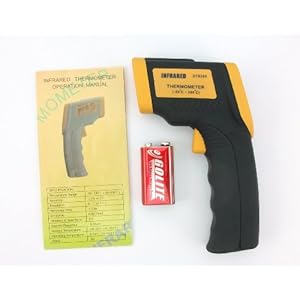

Offline saturation
  • Posts: 4787
  • Doveryai, no proveryai
    • NIST
Re: Digital Thermometer
« Reply #2 on: January 14, 2011, 05:29:01 pm »
Look at non-contact IR thermometers; they are very fast, safer to use and to -+ 2F or 1 C accurate.

One thing to keep in mind with IR measurements....
The field the IR probe "sees" is cone shaped, anywhere from 8 degrees wide to as much as 30 degrees.  The temperature reading on the probe is the average of what it sees.  It is not the temperature of just the area covered by the laser dot!  This assumption can lead to some big errors.
Offline saturation
  • Posts: 4787
    • NIST
« Reply #16 on: January 15, 2011, 07:52:56 pm »
Yes, its part of the device's spec, called distance-to-spot ratio (D:S).  A typical one  is 12:1, point it about 12 inches away for a 1  inch diameter spread; 12 feet away, 1 foot spread etc., some short distance ones have lens so the laser spreads proportionate to the D:S ratio, a nice convenience.
Pricey Fluke $700+ one's are 50-60:1, the tighter the beam the more expensive it is.
I use a $6 handheld one everyday, its rated 1:1, for general use 12:1 types are $24.

Offline Wim_L
  • Posts: 212
« Reply #18 on: January 15, 2011, 08:13:08 pm »
Indeed. Some models have not one, but several dots to better approximate the field of view of the sensor.
Regarding emissivity corrections, note that at very low emissivity (mostly shiny metal surfaces) it becomes almost impossible to do a proper correction for emissivity due to the effects from the environment. For example, if emissivity is 0.40, there will be a reflectivity of 0.60. A large amount of the signal measured by the detector will then not be coming from the sample, but will be heat emitted by the environment and reflected off the sample. The best measurements with a simple detector with emissivity correction will be when the object being measured is much hotter than the environment, so that the contribution from reflections is minimal.
There exist IR thermometers that are designed to take readings from very close distances only. Those can correct for this problem in a better way than long distance sensors, because the reflection will mostly becoming from the detector itself, whose thermal properties are known.
The best situation to do such measurements is when you can modify the sample to have a matte black finish with near-unity emissivity.

« Reply #23 on: August 21, 2011, 06:43:30 pm »
My old IR thermometer spontaneously died and I ran into this one.  If anyone is looking for well made  IR thermometer but at an unheard of price, this is one.  Its very confusing as there are so many look alike and brand less ones and the quality control on the brandless versions are very varied.  The clones seem to use the model number DT 380, whereas Cheerman model numbers are mostly DT 8380, for digital thermometer, distance to spot ratio, then upper temp limit.
Currently its selling for $12, $16 with S&H from Amazon.
http://www.amazon.com/HDE-Temperature-Infrared-Thermometer-Laser/dp/B002YE3FS4/ref=cm_cr_pr_product_top
Although listed as 'brandless' I tracked the manufacturer to Cheerman:
http://www.cheerman.cn/
IR thermometers and other variants seems to be all they do, and they did a good job on these models.  Finish, fit, material and workmanship is top quality, and for $16 delivered, its very good.  Although rated to 380oC, I tested it from 0-500oC and its accurate, compared against a thermocouple.
