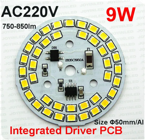

Here's an example of an circa-2013 LED bulb:
Here's a slightly newer construction (circa 2016), less parts, but still generally high level of complexity:
Now, LED bulb might just have a simple capacitive dropper like this one. Remind me what the downsides of these are again? Power power factor for one.
Or some highly integrated constant current driver like this. But, as far as I know, these are linear constant current drivers, i.e. MOSFET/BJT operated in ohmic region to maintain constant current? Is it that LED efficiency has improved so much that burning a little power in the driver is less of an issue since the lumens per watt is better than it was before?

And, adding the above point about linear constant current regulator. If it's effectively a linear regulator, then there's no real need (or less of a need) for EMI filter since there's likely no high frequency switching activity.

The filament bulbs have dozens of LED dies in series and drop close to the full line voltage across the LEDs at very low current, this makes it reasonable to use a simple linear regulator IC without crazy high losses. Compare this to an early bulb with perhaps 6-8 LEDs with a total forward drop of 30-40V being driven at 300-700mA, naturally it's going to require a more complex driver with bigger capacitors. A significant downside of many of the simpler bulbs though is that they flicker at line frequency, I find the flicker annoying and avoid those.

The super cheap non dimmable ones, at least in 120V land, seem to have gravitated towards a linear driver setup. Those are silent to the best of my testing ability (holding a AM transistor radio near a 100W one I got from the dollar store).
I wouldn't doubt it if the more complex dimmable and smart bulbs with buck converters and radios of their own make all sorts of noise though.

I wonder if this race to the bottom price-wise results in LED bulbs that generate lots of RF noise? I wouldn't be surprised at all if it did.
So now we have a product that generates two kinds of pollution: RF pollution and light pollution.
I recently bought some new LEDs to replace some early ones that were starting to fail.  Coincidentally, around the same time I noticed a lot of interference on a vintage analog TV in the next room that gets used to watch the news.  There were very noticeable wide horizontal noise bars moving up the picture.  It turned out that the new bulbs were causing the interference.  The set is fed using a shielded coaxial line, so I was surprised so much noise was leaking in.  With the coax unplugged, the usual snow was completely obscured by the interference.
Out of curiosity, I used my spectrum analyzer to look at the interference.  This was with just an dangling probe as an antenna.  You can see the FM band on the left side, and a couple of ATSC TV channels on the right.  The bulbs were generating interference over the entire spectrum up to about 500 MHz.  Needless to say, they went back to the store.  The old bulbs generated no visible interference.
Feit. I could have guessed that. Those fail the quickest for me.
