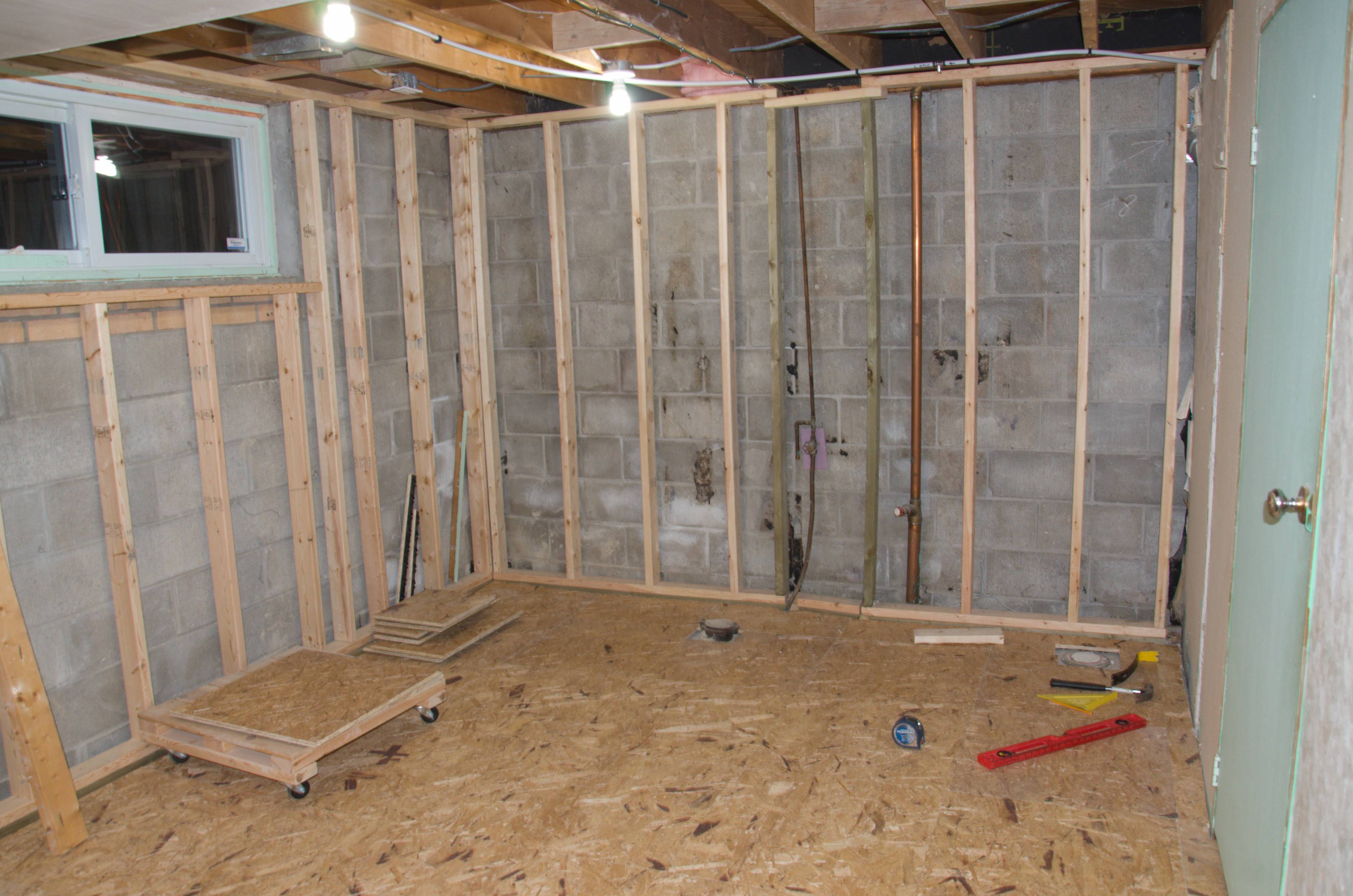

Here's a pic of how it looks like installed:
This is not really ESD proof but probably still better than carpet.   I oddly hardly ever get ESD in my house (hardwood upstairs) though despite the low humidity. If I make humidity too high the windows frost right up.
