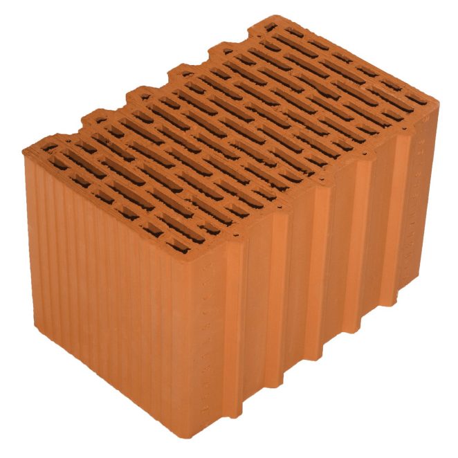

They were renovating small block of flats in Switzerland by adding 30cm styrofoam isolation on the outside.
In colder climates, the usual way to place the bricks is one layer of up to 45 cm thick bricks with built in air channels. The brick alone has a heat transfer coefficient of 0.14 W/mK unlike the usual  housing here is 1W/mK.

Those bricks are intended for inner walls only! You can't use these for outside walls, read the datasheet. Last year I have looked into these bricks as a light weight solution to upgrade my shed but the specs say these aren't suitable for outside walls.

Offline tszaboo
  • Posts: 8218
https://www.wienerberger.hu/termekek/porotherm-falazat/Falazoelemek/porotherm-38-n_f-tegla.html
Egy igazĂ¡n nĂ©pszerű, klasszikus kerĂ¡mia tĂ©gla, mely sokrĂ©tűen felhasznĂ¡lhatĂ³. EgyarĂ¡nt alkalmazhatĂ³ kĂ¼lsÅ‘ teherhordĂ³ fal, vagy vĂ¡laszfal Ă©pĂ­tĂ©sĂ©re.
"A really popular, classic ceramic brick that can be used in many ways. It can be used equally for the construction of external load-bearing walls or partitions."
Might be a fluke in the Dutch knowledge, like that other misinformation, you can only use heatpumps if your house is well isolated.
The other advancement that I saw was extremely thin layers of mortar, like 1mm. It requires the bricks to be sanded down accurately.
The plot thickens, because the same company I linked sells bricks here. And you don't have the same series available here, only the old school solid bricks. I'm starting to feel there is a building code which forces us here to build poorly isolated houses, stuck with centuries old technology.
