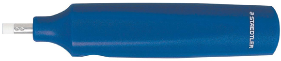

I would avoid a knife, if I accidentally cut something in unobtanium, it would be hard to get a substitute unless I buy another damaged device for parts since that keyboard is custom made.
I've used erasers too with great success.  But to avoid torsion forces, buy a cheap electric eraser, it could do all you want with the least work, and if it doesn't work it won't break the bank.
A Staedtler Electric Eraser, is sold in the US between $5-10 and the eraser refills is a box of 20-30 heads for $3.  The Sakura Electric Eraser one is Japanese original and costs $40!  They are 2x AAA powered.
Video:
http://www.artistsupplysource.com/product.php?productid=25326
The reason its cheap is just its an electric motor that spins an eraser head.
Best Wishes,
 Saturation
