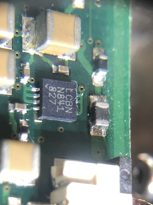

Can anyone help me identify this IC?  number on chip is LCBNN481827
Here's a pic if tit helps.

A wider-angle shot around the IC would help us understand what kind of circuitry is surrounding it.

What is it in and do you have any idea of its function?  I don't recognize it, but from the way it is connected, it may be an inductor or sensor of some kind, not a typical IC.

here is another angle.
its purpose is unknown to me as well. i have one that is smoked in another unit.
the unit its from is an item attached to a film camera. its prosperity and it would be useless to really attempt to go into to here.
it from the mid 90's and there is no schematic.
i know this will be a tough nut to crack. but looking at how so many pins are tied together
im thinking mosfet? some kind of switch ?

My first glance guess would be a mosfet, or similar. Figuring out where those triple-traces end up may answer what it is for.

in the second photo those 3 tied together end up right in between the 2 resistors just below it.

LT3080
Seller image for confirmation: https://www.aliexpress.com/item/4000056510652.html (attached below as well.)

Searching for "lcbn smd" quickly told me it's an LT3080.
Ah, while typing, I see amyk came to the same conclusion.

LT3080
thank you AMYK
