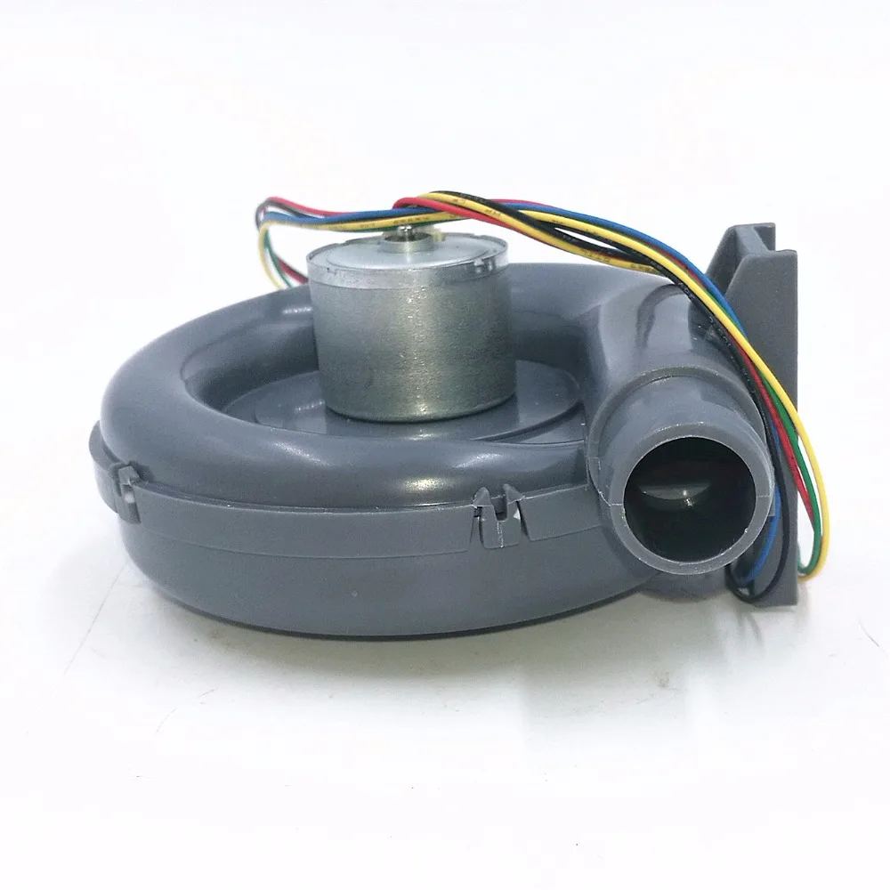

Small centrifugal blower - handle mounted .....

Could it be cost related or maybe marketing based on the high "litres per minute" of air that they can produce....... a daft characteristic to use where SMT reflow is involved though. High flow for shrinking heat shrink maybe, but when working on tiny SMT components it is just asking for trouble.
Quick works just fine within full 1-120 l/min range. Not to say with lower airflow there is a way less pressure to supply.
Online FraserTopic starter
  • Posts: 13524
Re: Hot air rework station pumps - food for thought ?
« Reply #14 on: April 20, 2021, 09:35:36 pm »
Wraper,
120l/min is not that bad, as you say. My pace units maximum airflow is around 25 l/m and the JBC is 34 l/m. The AMETEK centrifugal fans I was looking at had figures of 700 l/m ! My little 3" AMETEK blowers are rated at 18cfm which is 500 l/m !
It would appear that the Quick blower, despite its relatively large size is not running at anything like its full output flow capability. That is why I was wondering whether manufacturers are using an 'oversize' centrifugal blower and just not running it hard in order to better cope with the variable output port dimensions. As I previously said, this is not a topic that I have studied so I am just curious.
I attach pictures of my diminutive 3" AMETEK centrifugal blower. They are usually scary expensive at around $500 each but I bought them new for £25 each. Very nicely made 6Vdc to 14Vdc units. The BLDC motors have a built in controller that uses supply voltage to set shaft RPM. Even if I do not use them for the hot air station upgrades, I feel sure they will come in useful. Sadly mini regenerative blowers are anything but common and those I found were also around $500 !

Quick does not use usual centrifugal fan, it's quite a bit different. Also it operates at high RPM. IIRC BLDC motor in 861DS/DW is rated for 28k or 25k RPM.
« Reply #17 on: April 21, 2021, 12:34:23 am »
Seems that older quick used two stage turbine.
  • Posts: 13524
« Reply #20 on: April 21, 2021, 09:37:15 am »
Wrapper,
Many thanks for showing the inside of the fan. I was wondering what it’s impeller looked like, but could not find any pictures.
That looks similar to the impeller that is used in vacuum cleaners ?
I will see what I can find out about that design. I have heard of “Nautilus” blowers (as in nautilus shell), maybe it is that design ?
Fraser

« Reply #22 on: April 21, 2021, 10:44:21 am »
From initial checks, the Quick blower is actually a conventional centrifugal blower that is commonly found in vacuum cleaners
Interesting article on forward and backward curved impeller designs is here......
https://www.rs-online.com/designspark/fan-types-why-choose-a-forward-curved-centrifugal-fan
Fraser
