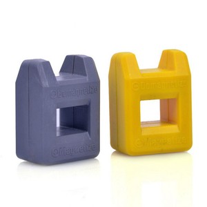

They don't need demagnetization, but for screwdrivers, I use something like this:
Works just fine, and doubles as magnetizer if needed.
