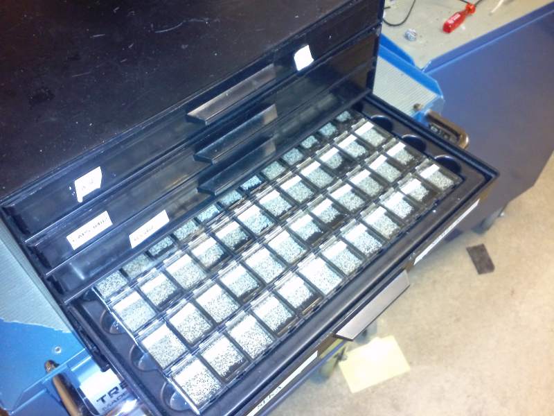

I have the same problem. I got 3 component drawers for free.
Full of 0805, 0606 and 0402 passives (RLC) and even a lot of semiconductor. Nice and compact drawers. Solves my component archive system :)
The values are marked but no idea about cap dielectrics, inductor current rating or resistor construction.
I'll probably just check digikey what rating the size usually has.
